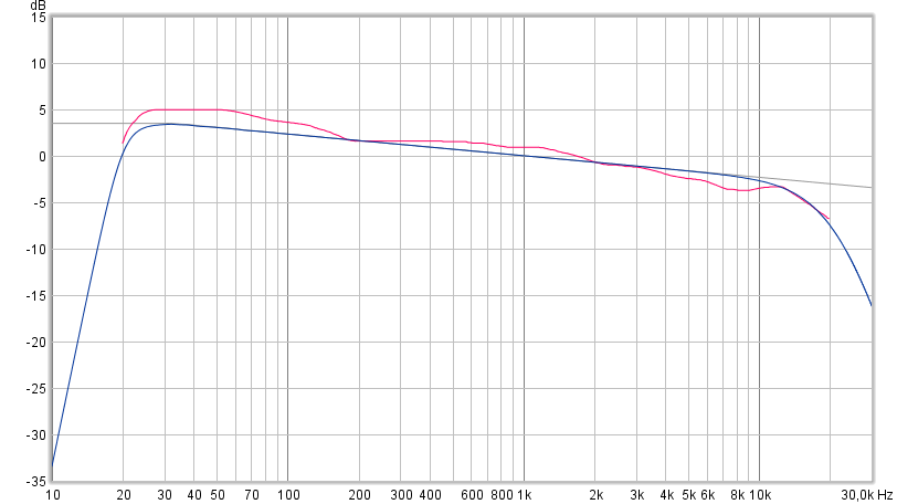

Had another look into that interesting preferred curve (red) from JBL study verse (grey) 7dB curve, think there is reason to think they have some similarities when reasonable stop bands are also added to 7dB curve which is at +3,5dB out to 30Hz point then strait declining line out to -3,5dB point at 30khz passing zero dB point at exactly 1kHz. High passed 7dB curve with a look alike of JBL study and low passed it dual 2nd order BW one at 20kHz say this is tweeter performance and one at 25kHz say this is microphone roll off and got below.

Hi BYRTT,
Whats a good way to specify this 7dB curve in rephase filters?
thanks

Think use some diy +20 EQs and you going 🙂 no just kidding here find my diy work in below attached zip folder as rephrase settings-file out to MHz, it is based upon a target frd-file from a pro equalizer.
Thansks for sharing BYRTT
Is there a way to load these filters onto my existing per driver rephase filters and continue to use a single combined rephase file per driver?
642178d1508974231-towers-25-driver-range-line-array-2001-png
It's quite telling how little difference there is between the graphs. We are talking about a few dB's at most. Though over a large enough frequency spectrum, changes like these are obvious.

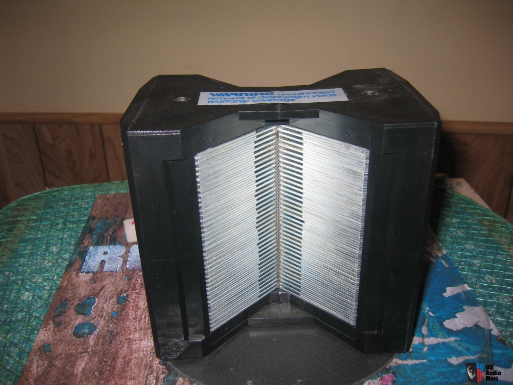

Maybe you could try to find a Heil Air Motion Transformer and come up with a plan to incorporate it into the living room as a SteamPunk design... 🙂

This concept could be interesting enough for a rough test 🙂.
I need to figure out what I would need for that, it should be as diffraction free as possible and only needs to play above ~700 Hz. The smaller, the better.
Some kind of directivity control would be a plus too.
