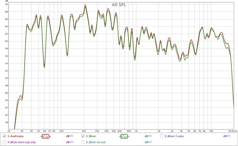

Here is the difference when playing a sweep on either Audirvana or JRiver, using the same Mac mini as the source, and another Mac for the recording. I'm using the "time-reference" to get the frequency response, but it messes up the impulse badly.
This test doesn't show the differences between the Mac drivers and the PC Asio drivers. That will be for another day, I simply didn't have time to do it all today.
So, here are the 2 sweeps, superposed. Nothing has changed besides the apps on the same Mac mini. DAC used as a pre was set and not touched between sweeps, no processing of any kind on either Audirvana and JRiver... no EQ... nothing.
First sweep shows Audirvana is louder by 0.4dB.

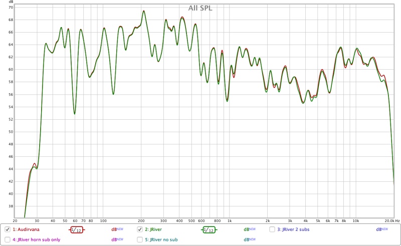

Adjusted in the second graph. There are still minute differences... not much though.

Did the two systems still sound different to you as you had shared earlier?
Perceval, the way I did it was to play a file of a dirac pulse in the audio program and record the output in Audacity on the same computer using the same interface. Using different clocks for ADC and DAC will always have some influence on the impulse. If you run more than one sweep do they give you the exact same response when smoothed? Just to rule out the difference between sweeps if there was any noise contamination.
Just to muddy the waters further I actually heard a difference between the ASIO driver and the WASAPI driver in Jriver when using an Amanero. The Amanero doesn't have an ASIO control panel to adjust the buffers separately to Jriver, this is the first time I have ever noticed a difference.
Couldn't really tell a difference because both measurements were using the same Mac audio drivers.
I was more concerned with the differences between my Mac and my PC.
The impulse is all garbled because I am using two different computers. It works fine for the FR, but impulse has never worked for me when using a timing reference.
Fluid, did you use SoundFlower to reroute the audio to Audacity?
No I used a physical loopback cable, set the soundcard as output in Audivarna or Jriver and set same card as the input in Audacity. Set Audacity to record press play on Audivarna then trim out the silence. I set the Dirac Pulse on repeat in the player and then cut one out in Audacity. I set the levels of the input gains first by using REW to calibrate as the Dirac pulse is full scale and you don't want it to clip.
By doing it that way rather than measuring a speaker you limit the number of variables down to the computer, program and drivers.
I suppose you could use Soundflower to avoid the cable by setting it as output in player and input in Audacity, I didn't try that because I gave up on Soundflower in this setup because I was trying to use it to get REW looped in but Audivarna doesn't have an input to make that work.
