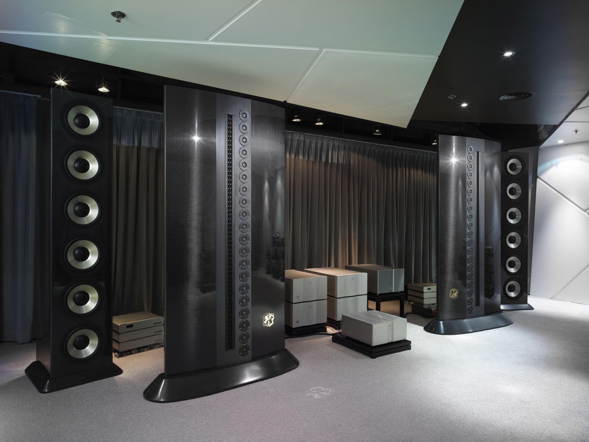

I had thought about a shorter line of 8" woofers as they could be easier to fit in a living room.
I already have too many expensive speakers so any more than one or two 12" subs is not on the cards for me any time soon, plus I have tried hard to make my lines visually unobtrusive (as far as any speaker more than 7 feet high can be) I don't think I could pull the same trick with Stig Erik's 21" driver floor to ceiling H frames 😀
I believe more would be better, as it would help average out placement dependent reflections in quite a few directions. So even a shorter line of 8" woofers should be able to do better than a single 12". I'd opt to keep it close to the array, as that would give you possibilities to switch energy with the TC9 array where needed (like my dip at 70 Hz on the left side).
I really have no choice but to use 2 single subs. I'll make it work somehow. Keeping them low to the floor probably helps out getting good use out of them for the bottom end but I really can't tell until I try.

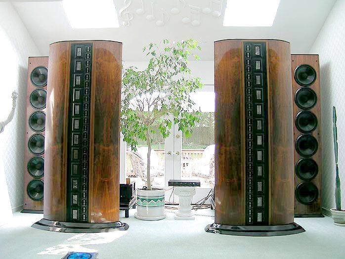

Even Scaena used a row of woofers for their top model:
attachment.php

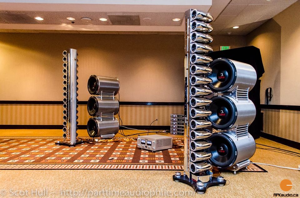

And Genesis used a row of smaller drivers:
attachment.php

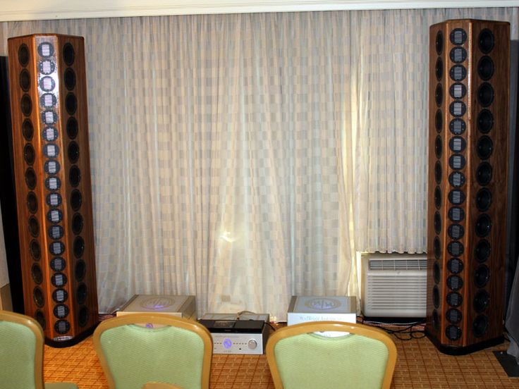

As did the Infinity IRS that came before them:
attachment.php
Many many more examples can be found. Though if we work at it, the true benefit would be to use both woofer and full range array to work together and not use fixed crossovers, at least in my wicked view on all things audio...

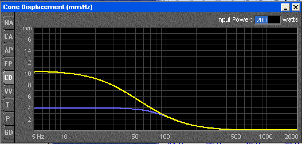

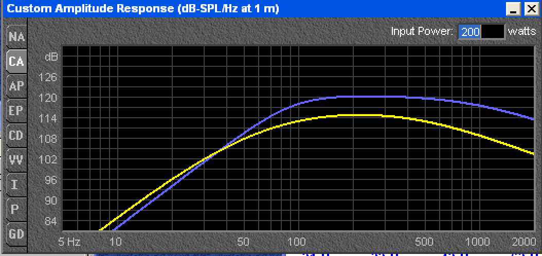

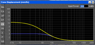

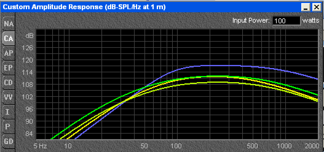

After wesayso's comment I put 4x SB in a sim against 1 x 830500
The SB drivers give up very little to the 830500 down low but they use significantly less cone travel to get there so coupled with the spreading of the source it seems like a pretty good idea.

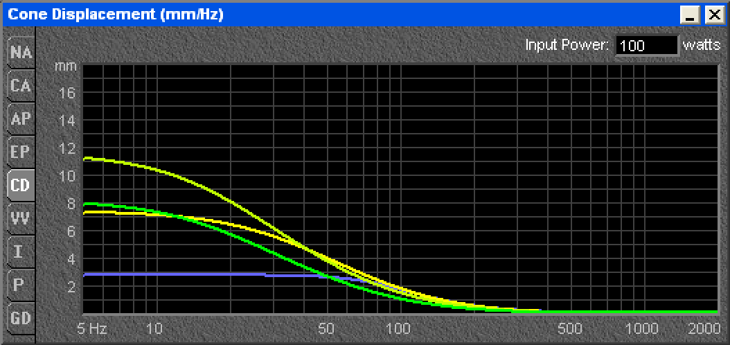

Sorry to intrude, fluid and wesayso, but could you do a similar test on https://www.madisoundspeakerstore.c...cl45-4-8-polypropylene-cone-sub-woofer-4-ohm/ for subwoofer consideration. I'm using 4 already, 2 per side in 1 cu.ft. boxes.
Here you go I had to change power to 100W to avoid the 2 driver box exceeding xmax. The lime green is two of those 4 ohm wired in series in a 2cuft box. The other green is 4 in series parallel to give 4 ohms in 4 cuft. They don't need anywhere near that big a box. The Q of the box is about 0.6 with half of that volume. That driver has been designed to be put in a very small box. It is also very expensive in relative terms for the performance it offers at least where I live. If you are interested in the below 30 Hz performance from a very small box then I suppose it could be a good choice.
Thanks for running that sim! I'm interested in freq's down to 10Hz. Matrix comes to mind where I heard my last 12" subwoofer experiment make alot of noise through the vent. But it did perform well, i.e. push alot of air, despite that vent noise.
Vented cabinets are not as well suited to Ultra low frequency response because they need a highpass filter to prevent over excursion below the tuning frequency.
