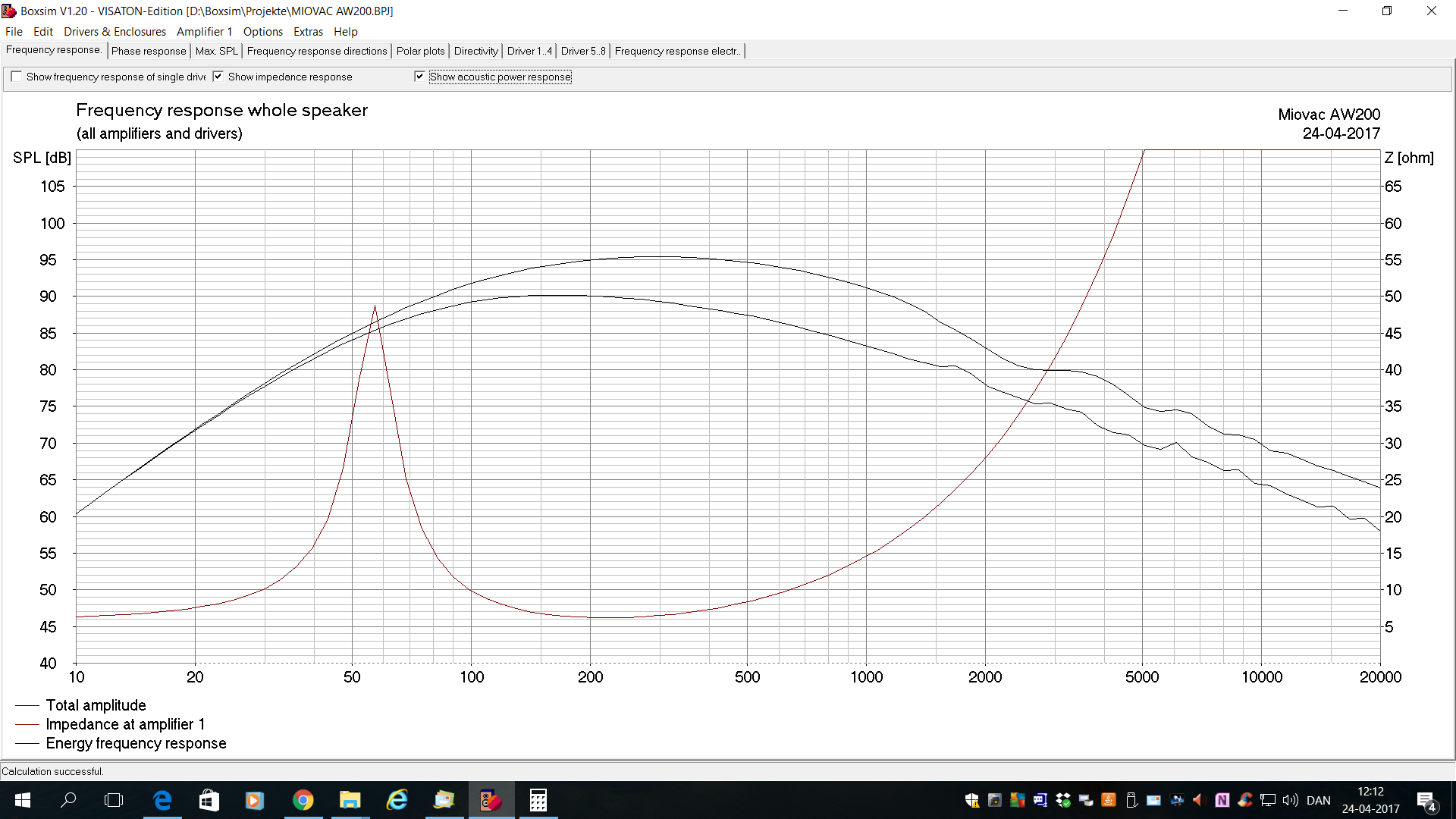

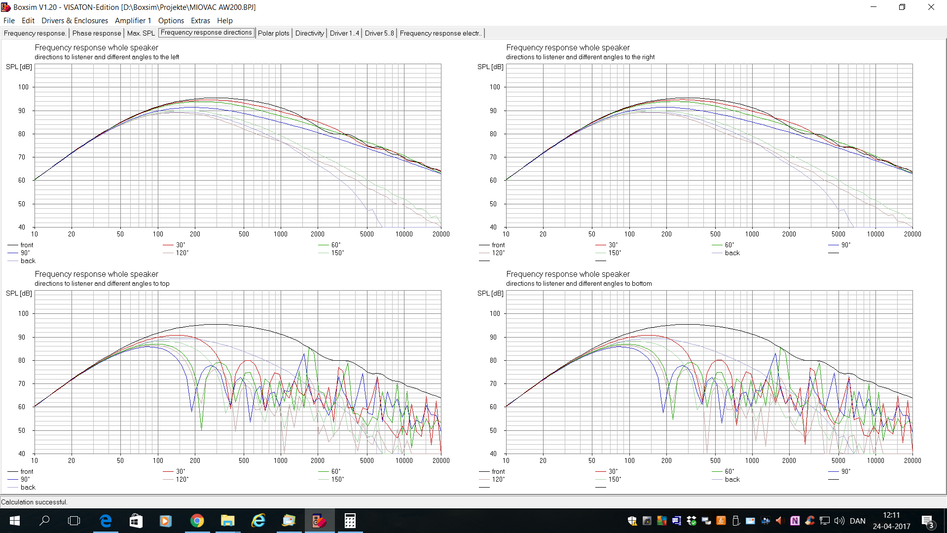

I got interested in using the Mivoc AW200 as sub so I made a sim in BOXSIM.
8 pcs (9 is an odd number to wire, whereas 4 in series and paralleled with another set of 4 makes 8 Ohms) AW 200 in a 200cm high enclosure 12.5 liter pr. unit.
Looks quite promising.
Of course you need some heavy EQ on the subs. but placed near corner you should be able to have a good low end extension.

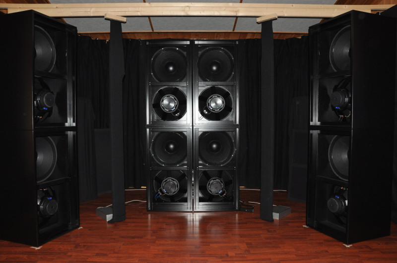

Have you ever seen the monstrosity setup from Stigerik? The open baffle setup with a huge amount of big woofers and the big B&G panels? Not sure that picture is still up, I do have one saved:
Stuff like that really sets of my own imagination.
I do believe it's a very good thing that I am constrained due to relational considerations. Things would get wild rather quick if I could have my way in everything.
