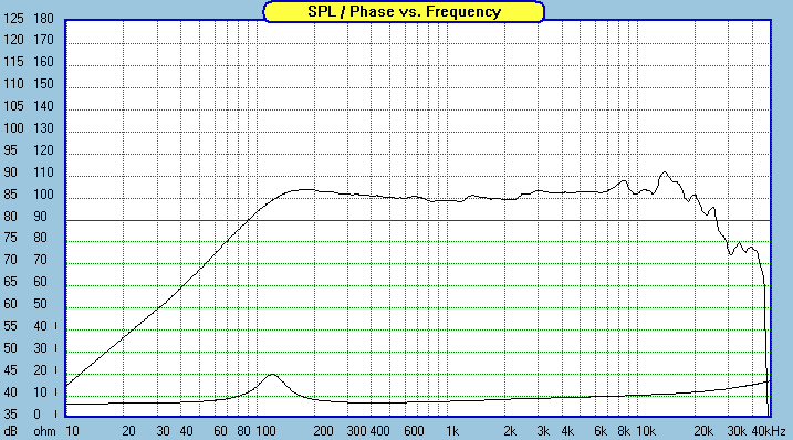

Frequency response of one Vifa (linked from Zaph-Audio)

Thanks for your reply. Have bought 2 x as many fullrangers and thought about the matter for some time.
Maybe you could try odeon ( Free Demo Version - Odeon ). It allows you to simulate numerous configurations of your array based on your own sound files. It might help fine-tuning your setup and minimizing problems arising from incoherent phase and destructive intereference. The listener being at a different distance from each driver, these aspects are relevant. Playing with delay, shading etc might help. Will follow your thread, good luck !
Read the whole thread ;). I have absolutely no intend of using any shading at all. Also a deliberate choice not to build one of those bent over backwards arrays from my part, or the more correct (at one point in space and time) arced array.
I expect this array to work fine enough for a floor to ceiling array of full range drivers, with the right amount of EQ.
I've seen a lot of simulations, did some of my own and made my choices based on that info and (maybe even more important) experiences from other users here who have built similar (enough) speakers.
If all else fails I'll start looking in different directions :D.
