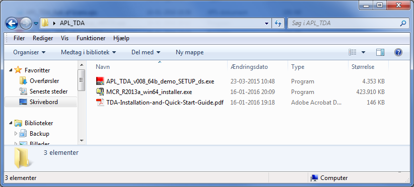

@wesayso, I tried installing APL but I can't get the Matlab compiler to work.
That's a bummer, we should be able to rectify that somehow. What are you running O.S. wise, we should have a few readers here that tried it. I can't really remember what it took for me. BYRTT, you there?
.....BYRTT, you there?
Right here 😀
In past with these three files i got APL_TDA demo up running:
Those are 64bit version but i also hold a 32bit version of Matlab and if ra7 like i can share via OneDrive.
I have a 64-bit Win7 laptop. Have the same files as Brytt. I tried it once and gave up. Maybe just need more time to troubleshoot. Did you have to do anything special, Brytt?
...Did you have to do anything special, Brytt?
Not other than right clicks and pick "Run as Administrator" for MatLab installation and same goes everytime i start APL_TDA.
Ok, I think I had the latest version of MCR that APL does not like. Downloading the older version now.

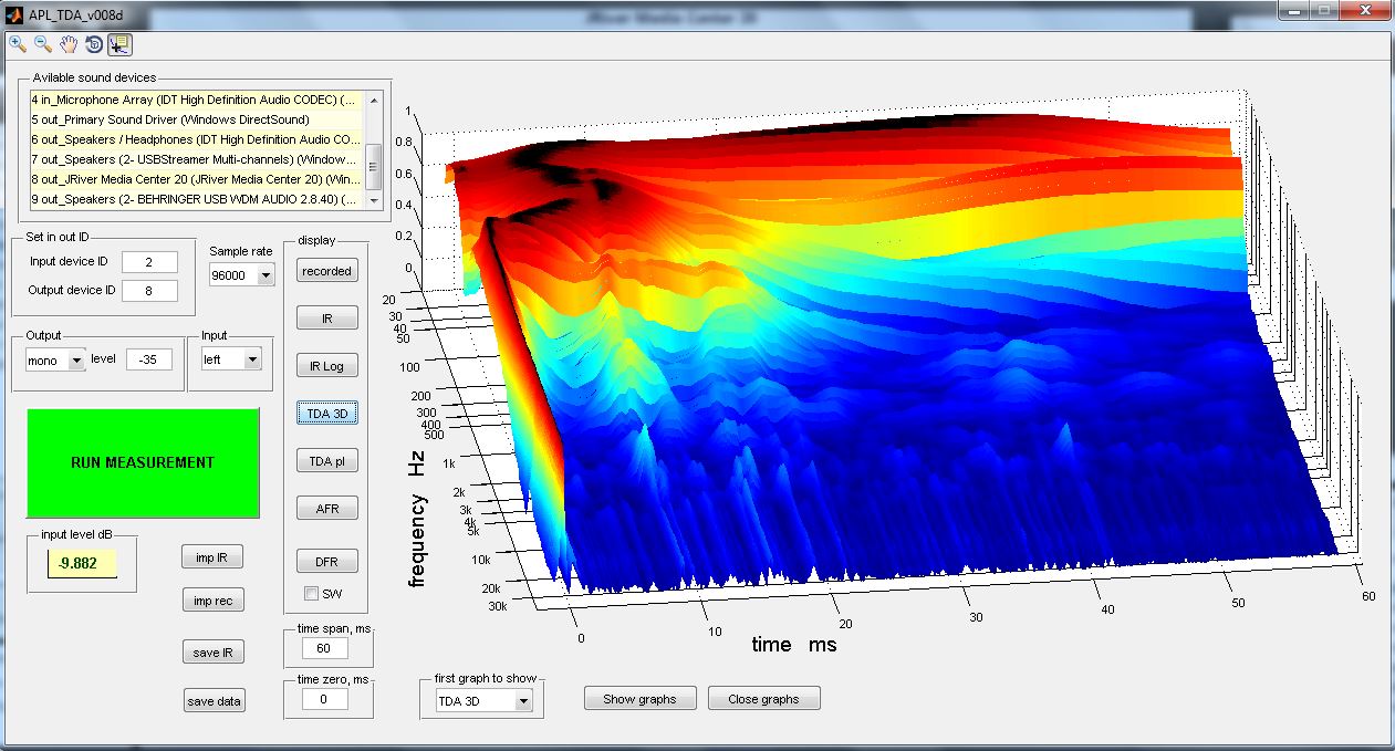

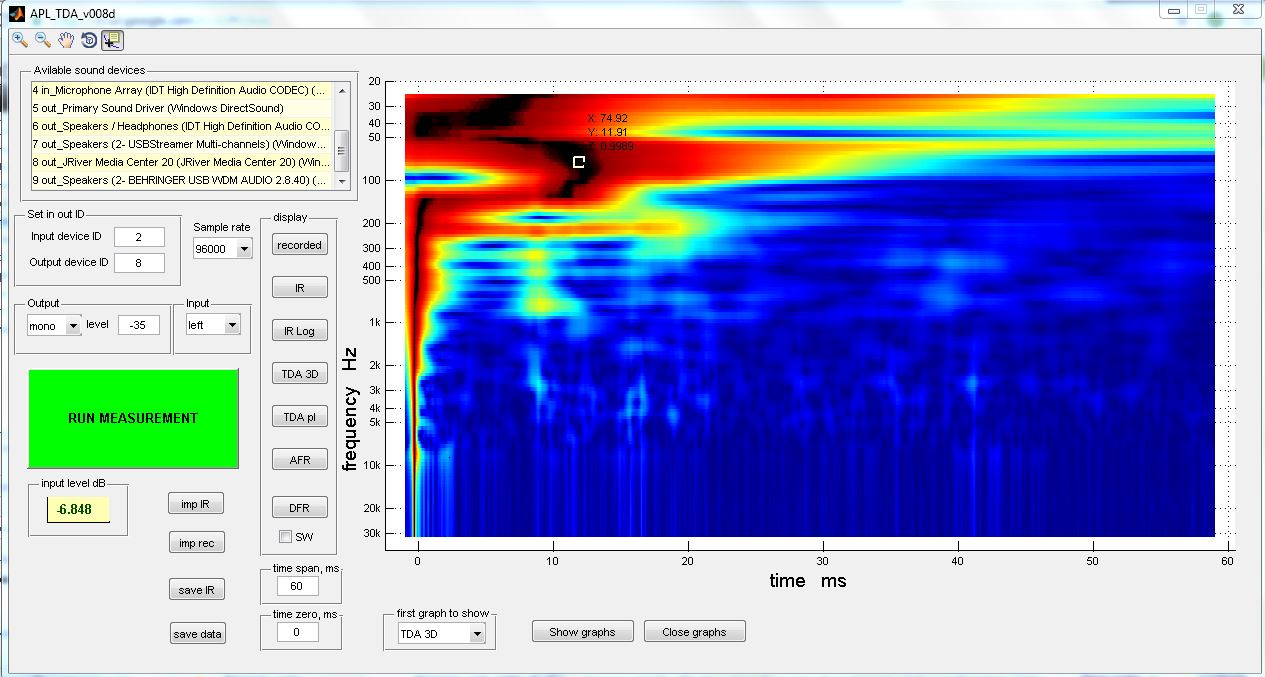

Hey, this APL TDA software is pretty nice and simple to use. Here is my plot in 2D. Not bad, though not as nice as yours. This week I changed my sub positions to the wall midpoints and I'm trying the Welti approach of the same signal to both subs. I'm not using FIR correction anymore, just a 48 db/oct crossover in JRiver for both subs, which is what is causing the phase warp between 50-100 Hz. Another complication is one of my subs is a tapped sub, so, it has its own delay, and the other one is sealed.
But still not bad considering there is just one piece of EQ (a 10 db peak at 25 Hz in JRiver) and everything below 100 Hz is more or less within 10 ms. One wavelength at 100 Hz is 10 ms. And it takes a few cycles for our brain to decipher what frequency it is. With a bit of work in Rephase or maybe DRC, I can get that nice and smooth, though I'm not sure it will be audible. It sounds quite good as it is. And by good, I mean foot-tapping and wanting to get up and dance good.
That's not bad ra7 thanks sharing so we can learn about these great TC9 arrays 🙂 though guess there will be some better slams in the the horizon working bit with that low end and XO.

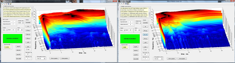

Ronald's before DSP (post 2971) and yours side by side:

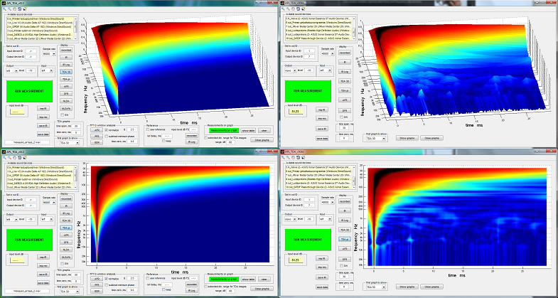

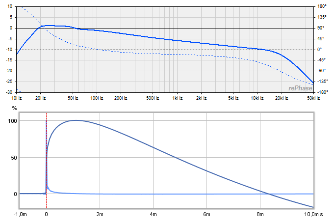

Think Ronalds system study and DSP execution is crazy good quality work, example here is a clean 96kHz IR-wav file created in Rephase traced over his stereo set at listening position:
Here is how that IR-wav file looks in APL_TDA verse real world acoustics:
