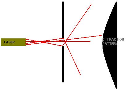

Something like this: Can you explain how you eliminate diffraction with rear mounted speaker's #1- then # 2 radius the opening ? two known areas that cause diffraction.... this the main reason modern speaker manufactures inlay-surface mount to eliminate as much diffraction as possible . Am I missing something here?

I truly hope it works for the time and money you have invested in this baffle. But the subject of speaker diffraction by most speaker builders is to decrease surface area to eliminate areas for diffraction to take place ,meaning any area in front of the speaker even a curved surface will reflect sound wave. The diagram I posted shows this idea. I truly hope your testing proves this theory wrong because I think your baffle design is cleaner looking than a front mount approach... Keep us posted on your progress ....

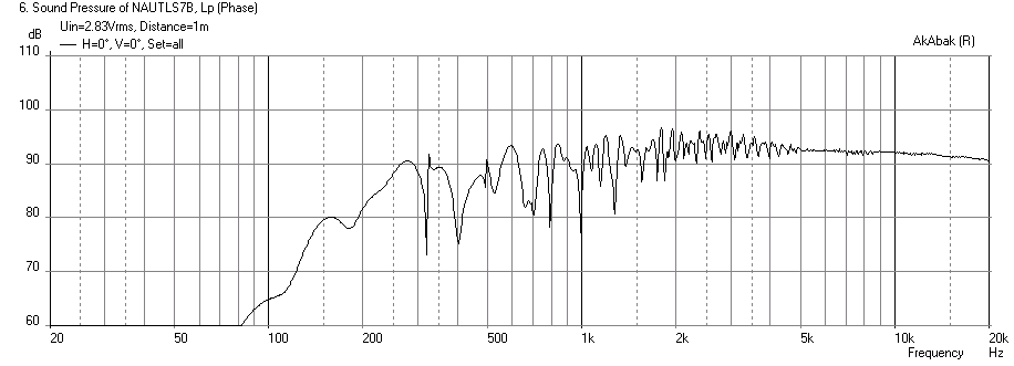

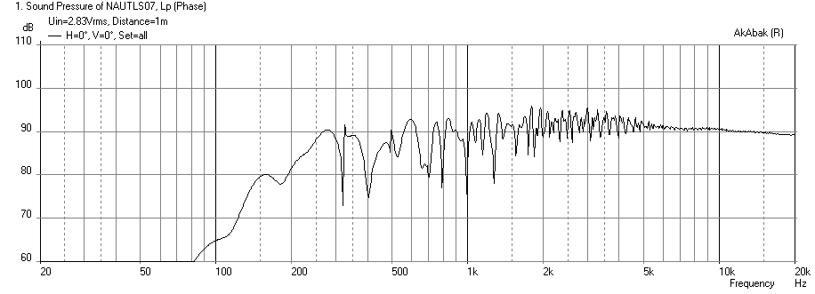

I did not do the simulation for a 25 driver array but I put the bezel on the Nautaloss II (dual drivers). The difference is almost negligible - it seems to actually boost the HF by a tiny bit on axis. I modeled the bezel as an exponential waveguide starting with an area equal to Sd (36.7 cm2) and expanding to 55.4 cm2 (a 0.8 cm radius increase for the mouth area) over 6 mm length.
Here are the frequency response plots (with room reflections turned on) for no bezel and with bezel.

True, that's why I looked into the radius backside mount solution. Did you compare the plots on that German site? There is less of a difference in the on axis / off axis plots with the back side mount plus radius compared to the flush mounted driver. The part that needs EQ is the slight boost the horn/waveguide shape gives. 🙂
