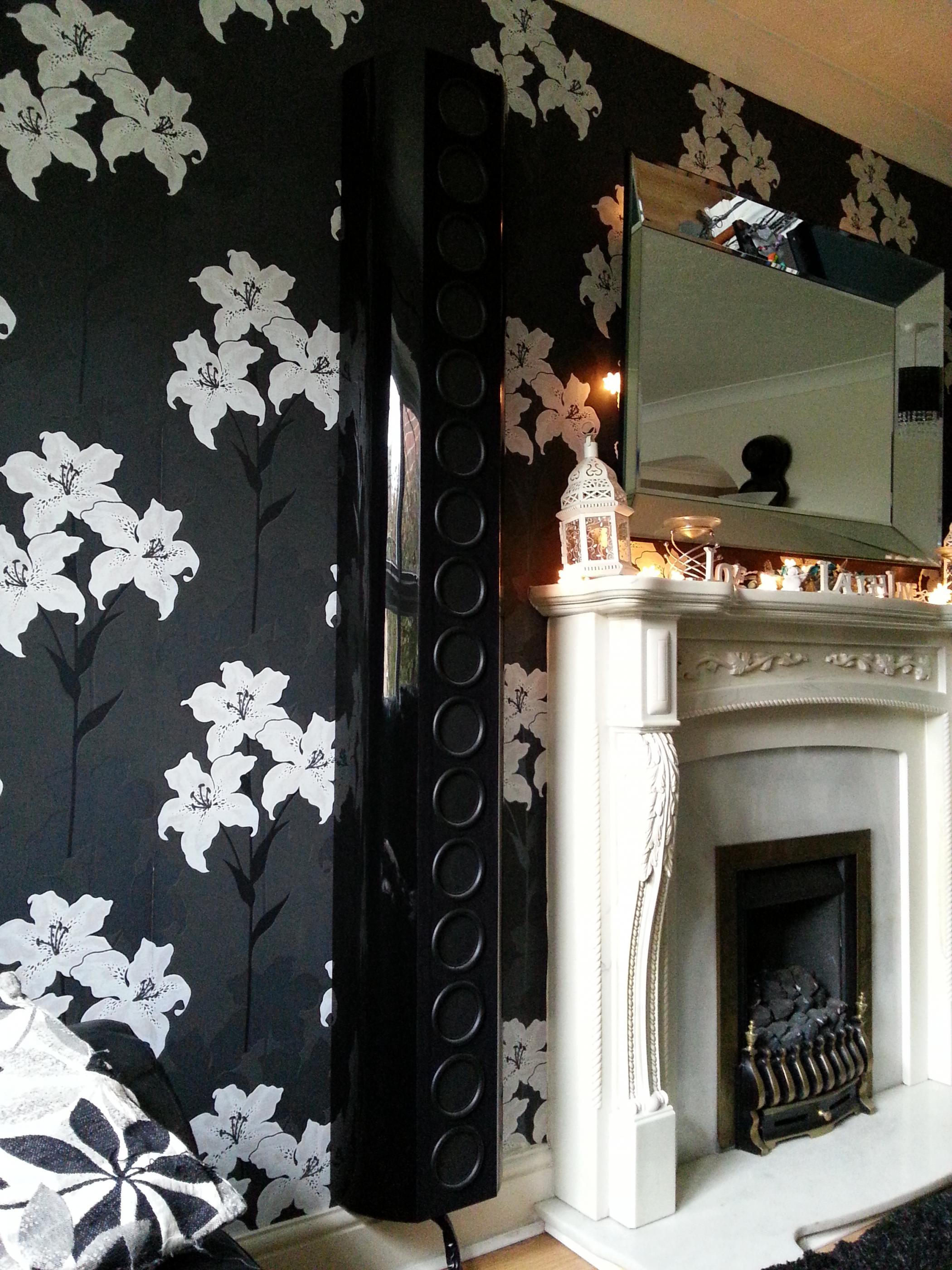

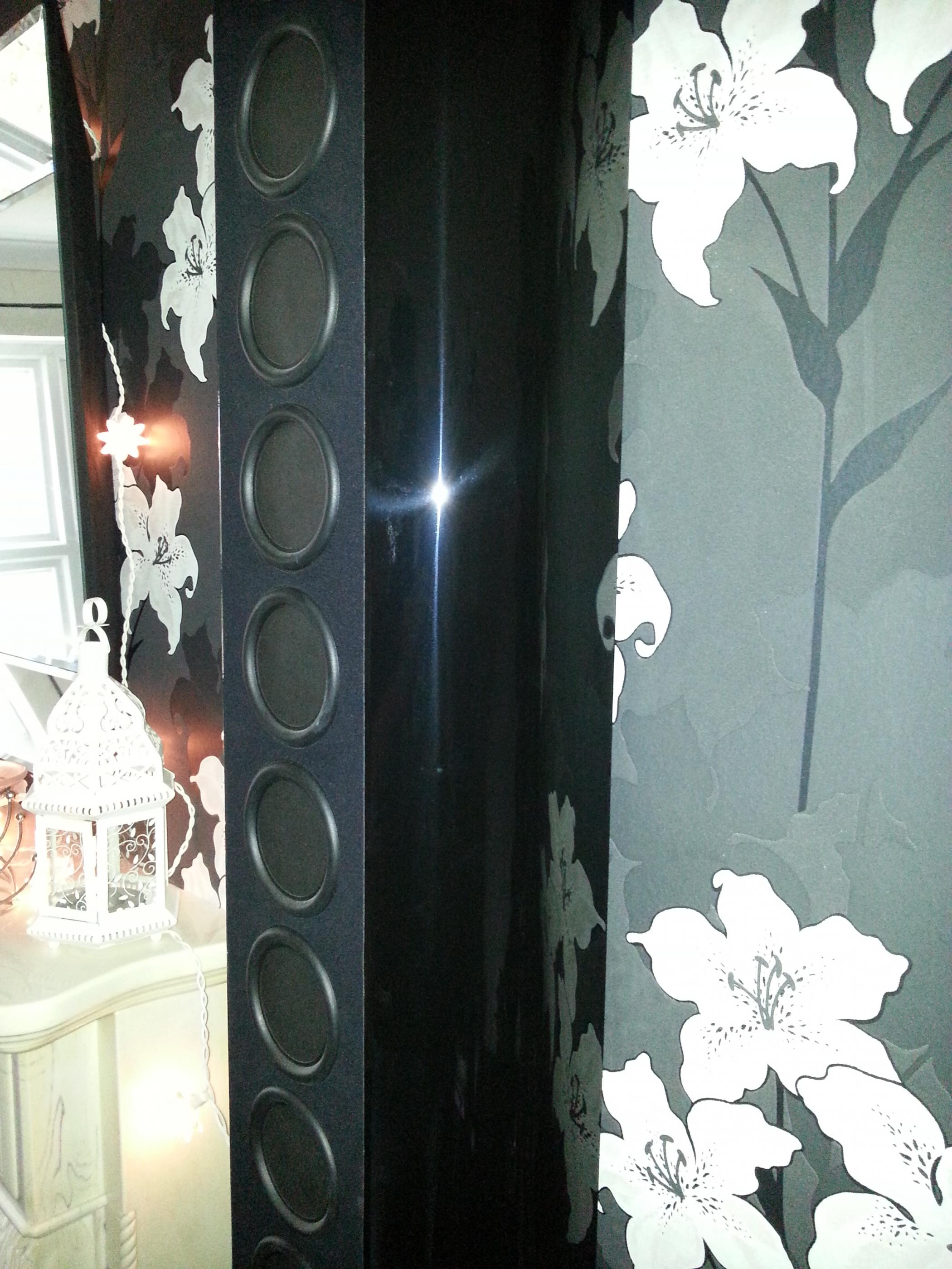

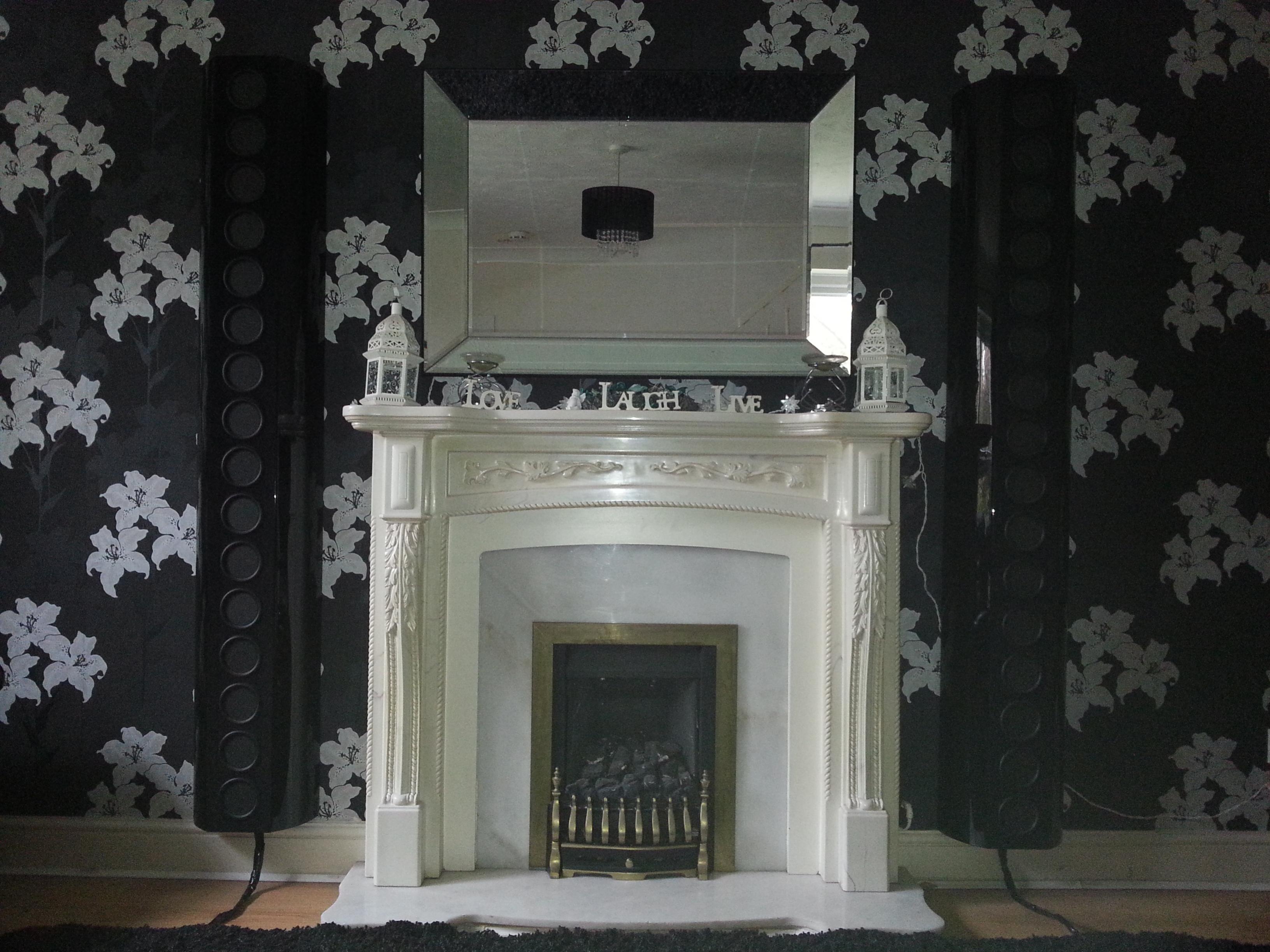

Space frame alternative?
Hiya,
Looks like you have some really good advice on how best to solve the problem, Phew!
Re future ideas for towers, I agree with the modular approach for future builds if you need / want high mass.
An alternative is the Formula 1 approach ie strong chassis with light weight curved panels... See attached pics
But you need to mount them on the wall as the will suffer from some degree of " cabinet rocking" if used on the floor.
