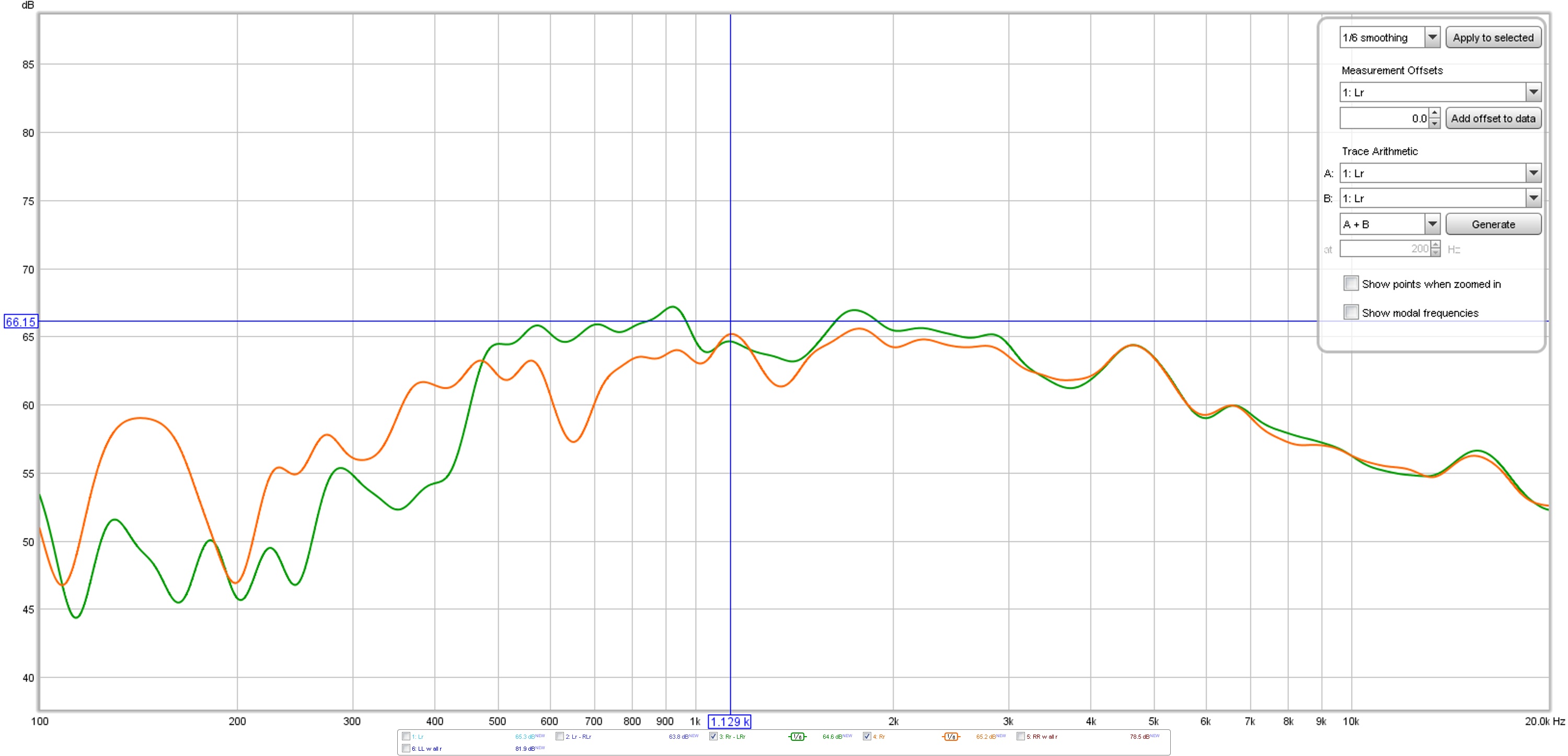

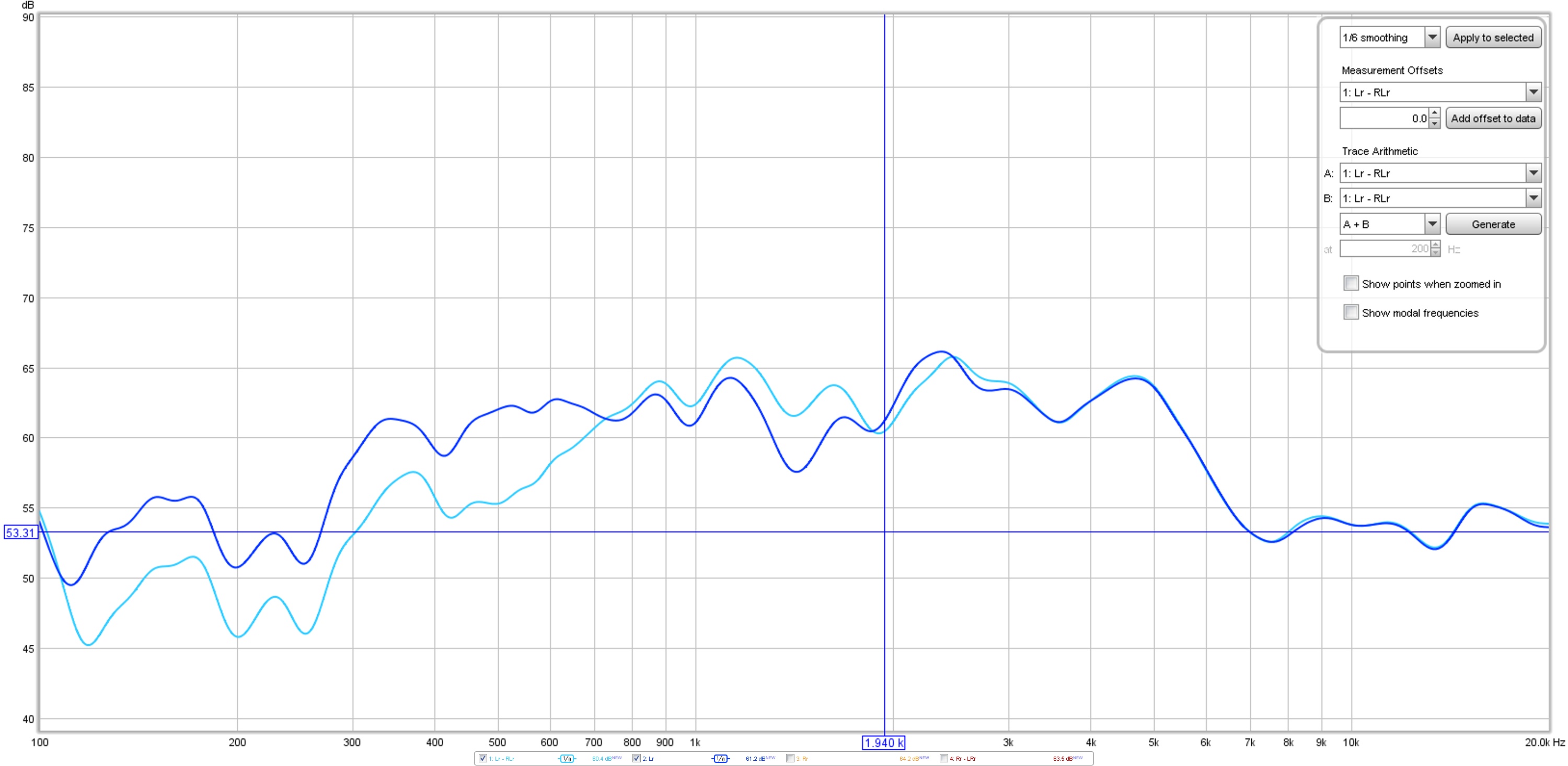

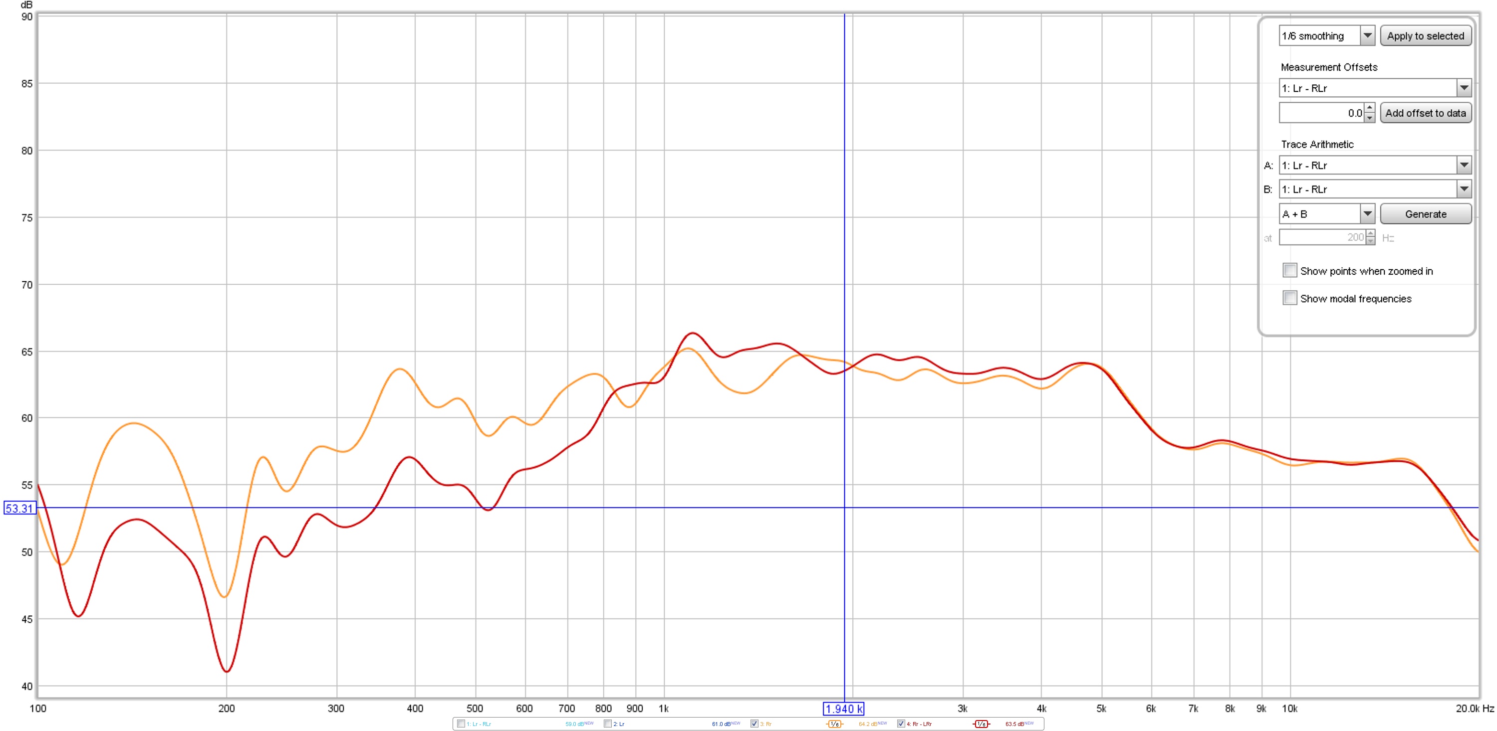

I put the X talk speakers in opposite phase directly below the main ambient speakers trying to get the drivers as close as possible.
In the attachment, ORANGE is the ambient speaker alone, GREEN with the X talk speaker added. I am getting some cancellation below about 470hz. Despite being out of phase and right next to each other, they are additive above this.
I suppose a true R-L would negate everything in a sine sweep right? I do think this configuration sounds the best so far. Does anyone think I need a truer R-L or will this work? I suppose <470hz covers most of the fundamental vocal range.

Indeed, that's what we were talking about. That picture comes close to what I'm doing, the delayed and band limited difference signals from a ~120 degree angle.
I use it this way to create a sense of space, which also improves the front stage. I'll experiment with pure difference signals soon. I ended up mixing a bit of center in because the tonality of the sides changed a bit. The center should sound the same in tonality to the sides. I currently have a 200 to 3500 Hz band pass but I'll try and run it a bit higher up. Just to see what happens, I've done it before, just not with the current reverb signal.
Your "tail" does come from the sides, but in timing it's more like a back signal i.m.h.o. As the side signals usually are a bit earlier in time. I wouldn't know if this can work coming from that direction. At least it will be more de-correlated.

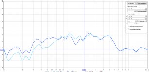

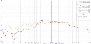

My guess is this will be quite close. It doesn't matter if some phantom center is still there, but it will be way more de-correlated than the pure L or R and better than the more mono signal by having L+R on each side, aside from the difference in level.
Good to read this is somewhat working. I figure you have some phantom center leakage but that will make sure the tonality of that front stage will be more equal from left to center to right.
Do you play both equally loud (the left and minus right)?

The minus R is 5-7db lower than the L. (spl difference in speakers used).
So that would leave you a bit of phantom in the mix, but still have a way more diffused signal. It should work fine for ambience. What room would not reflect the center stage anyway 🙂.
It's true that L-R should cancel in a sweep, like you said above.
