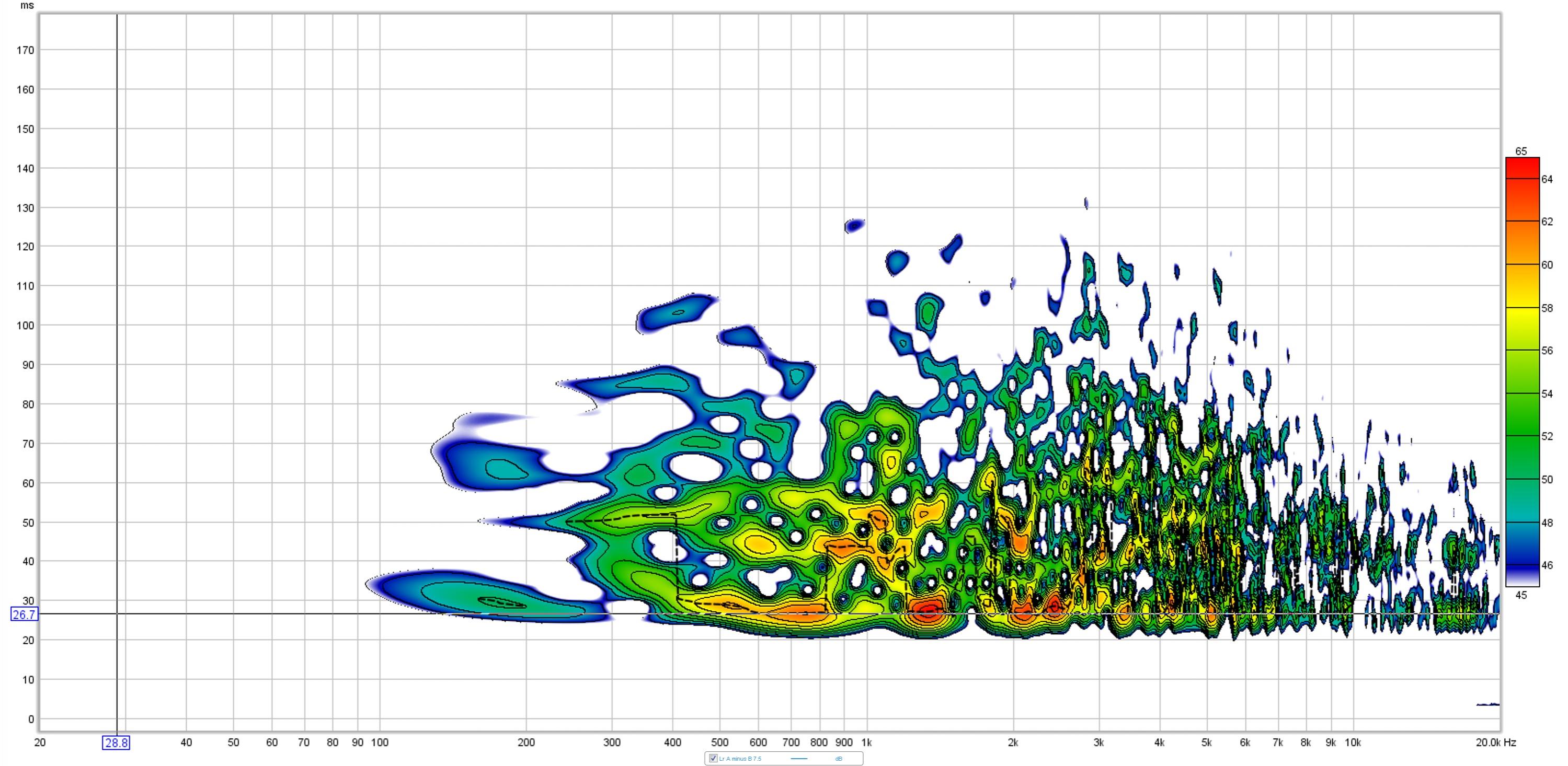

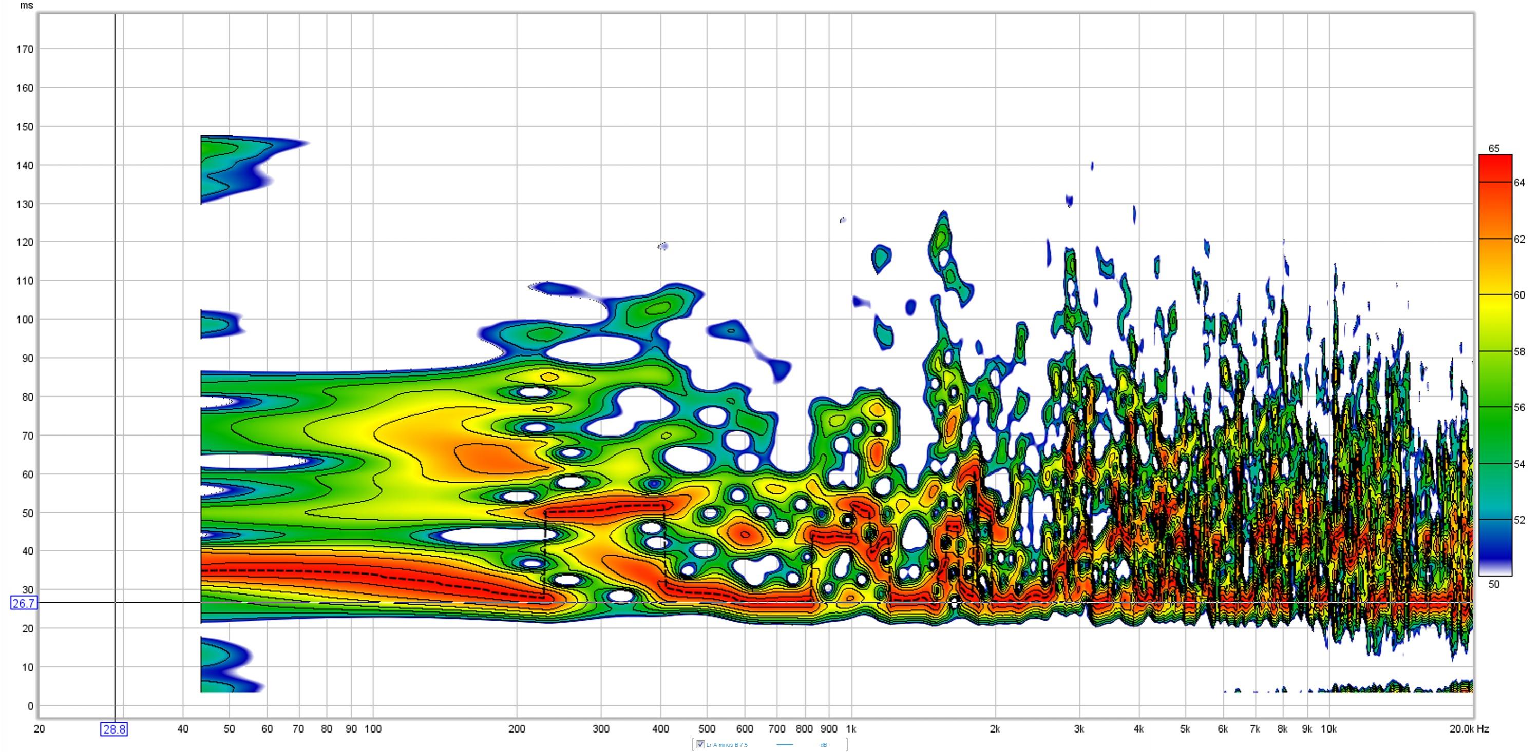

I came up with something helpful (I think). First, bear with me.
Run a measurement with ambient channels engaged and call that "A". Now run it again without the ambient channels and call that "B". Now in REW, do a (A-B) and call that "C".
What "C" represents is the ambient information only. Whats nifty about this is you can call it up on a spectrogram (see attachment) and in one snapshot, see the relative spectra in time. You can see clearly when it comes into being, in my example about 27ms, but also how it decays.
This same formula could be used to analyze the kicker.

jim1961,
I think what you might want here is the division function (a/b), no?
Explain.
edit: When I do the A-B, I get the exact same result in magnitude as running the ambient channel by itself. This seems self confirming that A-B provides the difference. What A-B gives you that a simple ambient channel sweep by itself wont is the proper time index.
I guess I'm not sure what exactly you're looking for; you lost me with the time index bit. I think I have used A/B to get the difference between signals, but we may be talking about different things...
If you run a sweep with ambient channels only, REW corrects the first wavefront to T=0, even when in reality, the first wavefront from such a source may not enter the equation until 26ms (for example in my case) when compared to the time arrival of the mains.
Where "A" = Mains + ambient and "B" = Mains only, A-B lets you see the ambient content WHEN it arrives.
Thanks that is clever tip, think reason that REW can't show real timing is because input "USB mic" run on separate physical clock relative to soundcard output and that will provide small mismatch from sweep to sweep therefor the zero align IR thing. Recently changed to analog mic setup because of above so to have synced real time of flight info, it now uses left channel I/O as measurement chain and right channel I/O is physical loopback wired, because all I/O is on same clock REW can have ticked "Use loopback as timing reference" which ensures relative correct aligned IR timing from sweep to sweep and also info about time of flight.
