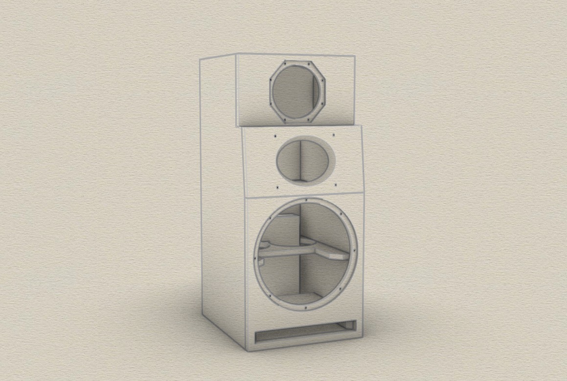

Well, TL-III will physically fit in that room. What else is in there? A fridge, or a bed maybe? Might be getting a bit cramped in there.
I'd suggest to make two cheap mockup boxes from cardboard or similar with the same dimensions as the speakers would be. Put them in the room at a position that should work well (stereo triangle and stuff). This has helped me a lot in the past to decide if things fit in or not.
The room compatibility depends on many factors, TL3 have less problem in small rooms because the bass is handled by a DSP controlled amp. But DSP can be used on normal passive speakers either.
That's a great idea, I'll do this later.
There's a bed, a desk, and bookshelves. The speakers would be placed in both corners, which are dead corners anyway since there's a desk.

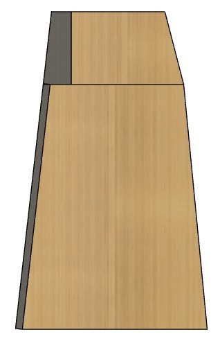

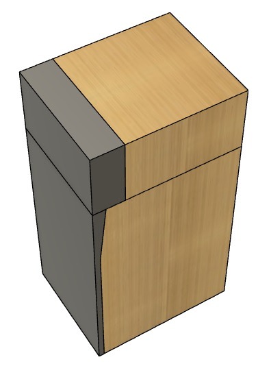

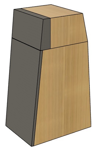

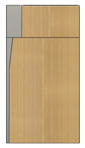

Hey guys,
I'm considering building Troels' TL3, so I made a few drawings to see what would be my preferred design for the cabinets (including grill cloth).
I haven't made any decision yet. If anyone wants to comment on which one they prefer, and why, I would appreciate it.
Version 1
Version 2
