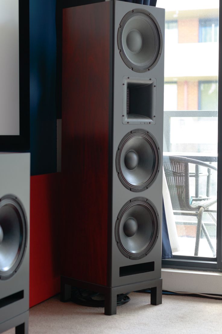

Yes, all good points. But it does not explain why this large loudspeaker has such low sensitivity. He could have used a much smaller woofer and box to get the same result. Not one of his best designs, if you ask me.
I'm starting to think a lot of people or just me, do not understand system sensitivity very well....
Each driver in this design is pretty high sensitivity....the woofer is 99db, and the mid woofer is 96db...while the tweeter is 110db....
System Sensitivity means little to me unless its showing an underlying driver issue.....unless somehow the designer found a way to reduce woofer efficiency....Sensitivity is tied to efficiency but isn't tied to excursion efficiency if the crossover is the catalyst for its change....efficiency of the input level may change but not the woofers mechanical efficiency....so as long as there is enough amplifier power...what care is it if the system Sens is 92db or 96db.....the sound quality is tied to the efficiency of the woofer.
You may already understand this and trying to say something else that I don't understand? If we had two systems with identical Sensitivity but one with much more efficiency than the other....they are not acoustically the same....
If we had two systems with matching efficiency and one system has significantly higher sensitivity...acoustically, they should be identical..
Good point camplo, furthermore the woofer is crossed actively which is better for efficiency than passive. Even with 92dB/2.83V mid-high section, this is a high efficiency speaker, because the impedance is relative high too. Normal commercial home speakers rarely reach that efficiency level.
But on closer inspection, however, it can be seen that the final combined impedance is not as high as I assumed, mainly due the shunt resistors.
The passive crossover (mainly the resistors) appears to be the limiting factor in the maximum sound pressure of this speaker.
If a speaker with all-passive filters has flat SPL response, its overall sensitivity will be limited by the driver with the lowest sensitivity. In almost all cases, the limit will be the bass driver (woofer). The bass sensitivity / efficiency is determined by the size of the woofer / box and the bass cut-off frequency. For high sensitivity / efficiency, the speaker must either be large, or must have high cut-off, or a bit of both. It is up to the designer to choose the right compromise between sensitivity/efficiency, size, and bass extension.
High sensitivity / efficiency is important in home "Hi-Fi" systems if a low-power amplifier is used (small tube amps, class-A amps, etc.). This is why "weak" amps typically go well with large speakers, and vice versa.
The motivation to sacrifice a lot of real estate for a large "Hi-Fi" loudspeaker in a home environment is almost always due to the need for high sensitivity / efficiency, i.e., if a low-power amplifier is used. With a high-power amplifier, there is no need to use a high sensitivity / efficiency loudspeaker, so it can be smaller and still produce deep bass.
Troels "Loudspeaker III" is a large "Hi-Fi" loudspeaker (as far as I can tell it's not intended for PA use or other non-home or "no Hi-Fi" applications). Therefore, one might think it's large because the designer chose the size/efficiency/bass-extension compromise in this way in order to get a high sensitivity/efficiency speaker with decent bass extension.
However, Troels decided to run the woofer from a dedicated, powerful amplifier. This removes the sensitivity/efficiency limitation of the woofer, because the gain of the bass amplifier can just be cranked up to pretty much any level that is required to match the passive mid / tweeter. Also, the active filter in the bass amplifier can be set to boost the deep bass to get flat bass down to 20 or 30 Hz without trouble, so the limitations on the bass extension of the loudspeaker system are also removed.* This means that two major reasons for choosing a large woofer in a big box melted into thin air when Troels decided to use a dedicated amp for the woofer.
I hope all this explains why I don't understand why Troels made this speaker so big, and still gets so little sensitivity / efficiency out of it.
(*) Active systems also have their limits in terms of size and bass extension, but they are still in a very different league than a passive system.
Ultimate SPL level at bass frequencies is determined by Volume Displacement, how much air can the driver(s) move.
15" Woofer 15W700 Sd 850cm2 xmax 6.5mm
8" Subwoofer SB23MFCL Sd 210cm2 xmax 12mm
850 x 0.65 = 552.5 cm3
210 x 1.2 = 252cm3
If you then compare these numbers to a volume displacement chart (below) you can see how loud each can get at what frequency (The chart is for a sealed system as it is the one I have saved but it works for comparison purposes).
This means the large driver has to use a quarter as much excursion to get to the same SPL. More Sd and less excursion makes a lot of sense to me.
.......... Any good 8" woofer can be made to go down to 20 Hz in a smallish box simply by setting up the filter accordingly. It just makes no sense to me why Troels used such a large woofer.
It is clear (when you read his website however not all here seem to do..) that Troels likes the impact that his high sensitive designs provide, especially in the bass department.
His first design, based on an 18 inch woofer, is an attempt to what can be done with a system with little compromise.
The other TL' s, based on 15 and 18 inch woofers, are attempts to what can be done in smaller enclosures.
The three-way classic designs are based on 12 and 15 inch woofers, and dome tweeters instead CD's.
It's the impact and the relatively low distortion of a large woofer, and I can understand (liked pointed out by member fluid above).
Yes, with a smaller woofer and DSP aided amplification you will have enough "bass", but it's just different.
It's also subjective, but I know what I prefer 😀

It would create some directivity between the mid and bass woofers?....
Offaxis null from mid/tweet xover is flipped? Desirable for a tall speaker at least...
