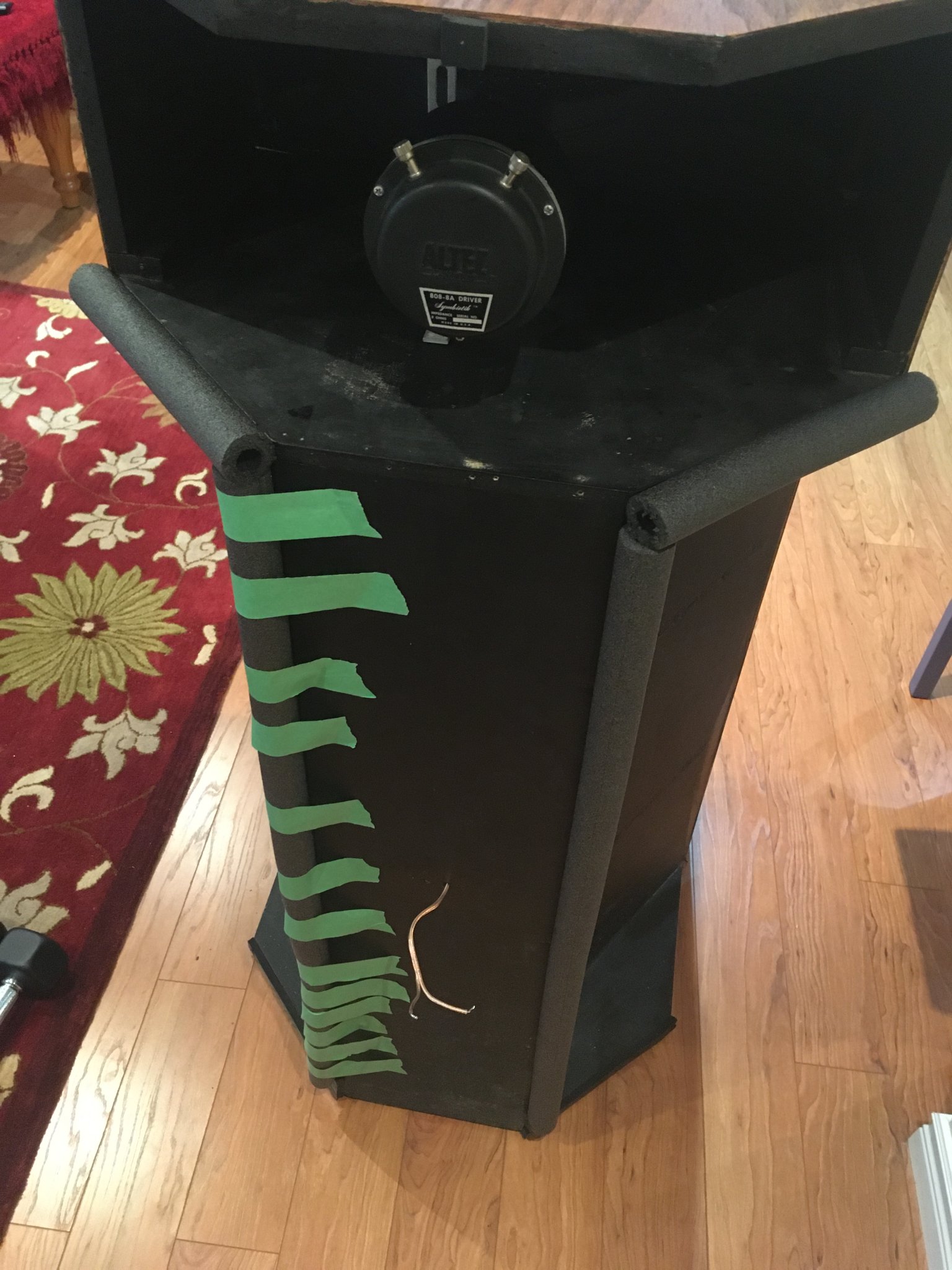

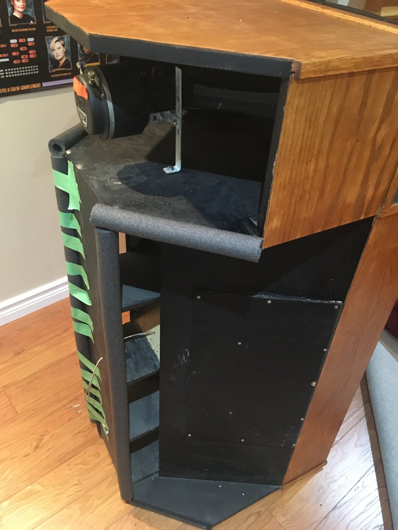

I’m slow at finishing projects… adding some pipe insulation to the edges that need to seal to the walls. Thinner weather sealing goes at the bottom against the skirting boards.

I have now made and installed an aluminium bracket, with binding posts, on each speaker so that I can plug and play with bi-amping speaker cables. It also provides cable strain relief by isolating the cables to the drivers from those to the power amps.
I then wired up a pair of 4 x 25uF Vishay film caps in parallel blocks to give me a pair of 100uF series protection caps for the CD’s on the upper horns. Unfortunately they sucked some of life out of the sound so they had to be bypassed and will eventually be removed.
On some Chesky recorded jazz, the speakers are sounding good. On pop music they are not sounding right (hey, maybe these speakers have good taste!), a little fatigue in the treble and a bit boomy in the bass. I still need to get my virgin calibrated microphone set up, it has been sitting still unused for several years.
