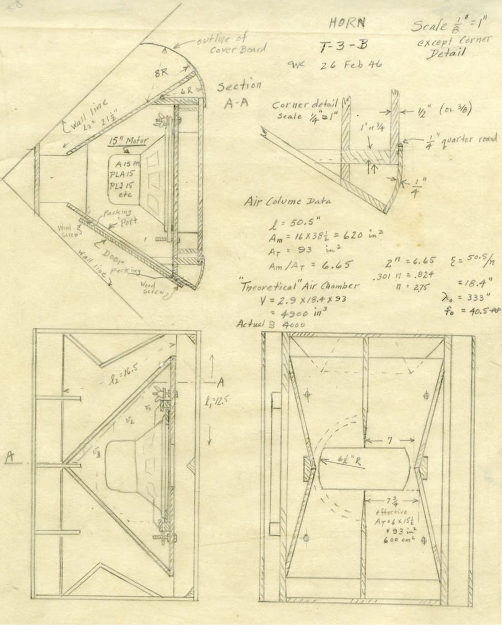

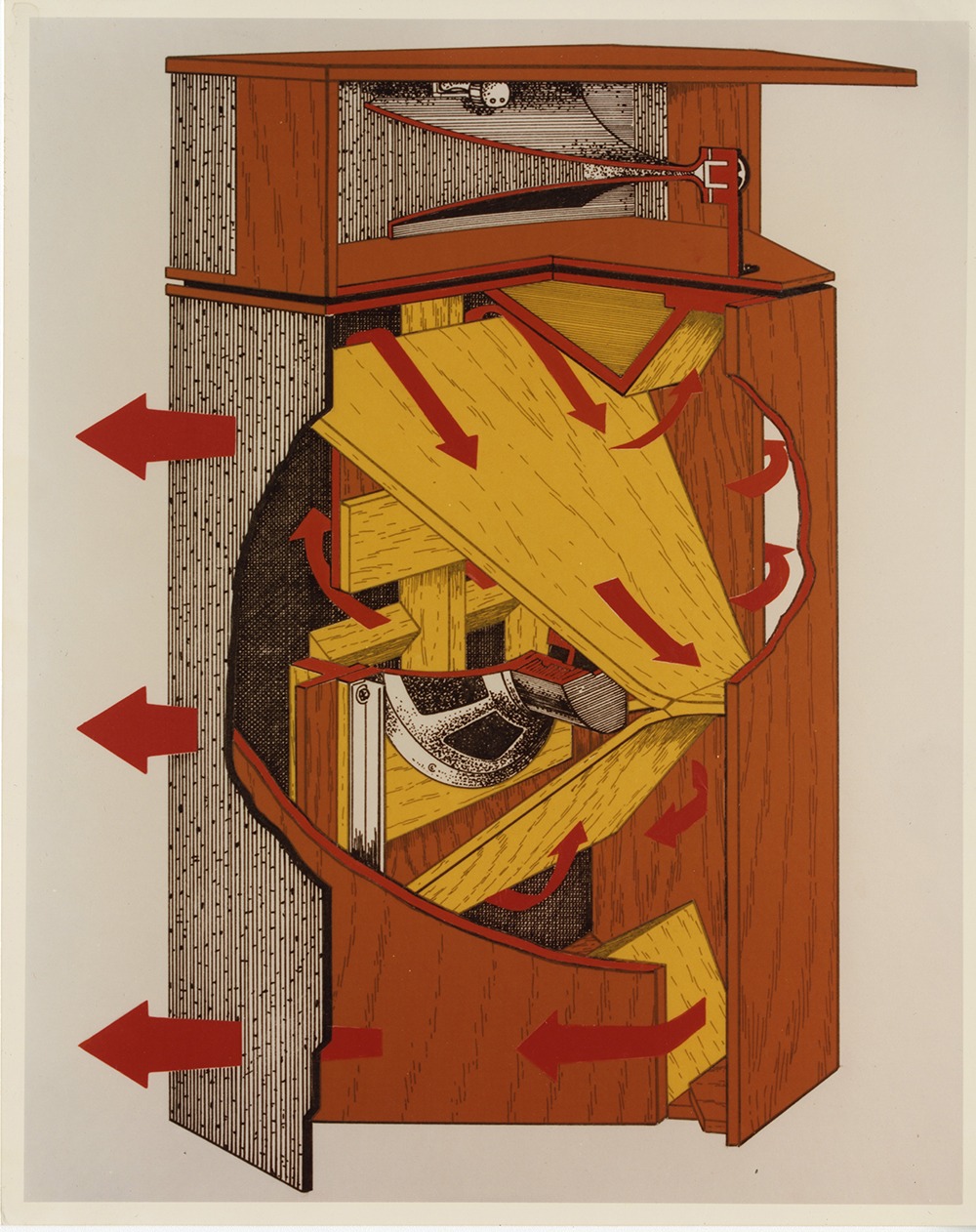

It's a K-horn, which is short for Korner horn or Klipsch Horn depending on who you ask. The original was designed and produced by Paul Klipsch around 1946 and the rest, as they say, is history. https://www.klipsch.ca/blog/klipsch-down-low-horn-speakers
The design was licensed by the British company Vitavox and 20+years ago plans derived from the Vitavox version found their way to Ontario where various models were produced (and I know of an enthusiast who's still active and who helped build the boxes that now sit in my basement).
They are capable of good imaging so one need not be afraid of corner-situated speakers: https://www.diyaudio.com/community/threads/corner-horn-imaging-faq.248444/
I'm going to approach this from a FAST/WAW perspective with an Altec 511B metal horn providing the critical range of frequencies rather like a full range driver would in some of the popular FAST/WAS projects in the Full Range forum here. The driver on my 511B horn is the Altec 808-8a CD.
The box defines the woofer horn, so the only part left to play with will be the X-over and here there are many opinions.

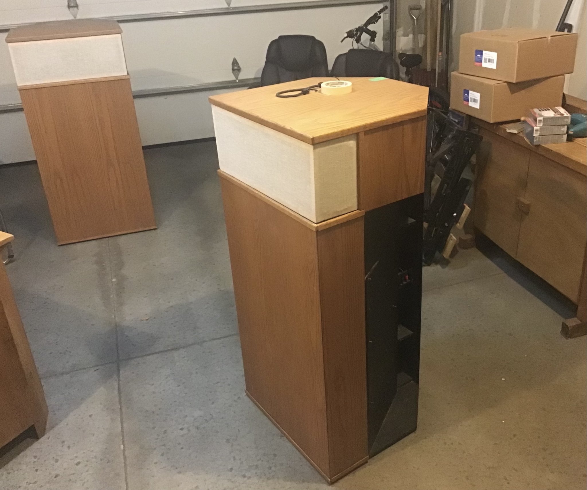

OK - I hooked up the left-hand speaker for a first listen, using my TGM8 amplifier. I have to say that it was really interesting to have such an iconic driver in my home, no idea what the history of this particular unit is but I understand from the seller that it was in active use until about a decade ago. I don't know what the phasing is, there's no '+' that I can see on the terminals. I took off the rear cover and there is a green wire and a brown wire so I made the assumption that these represent '-' and '+' respectively. The sound has an ease and a clarity that made it feel as if the voice was 'in the room' and that's not something I get from my other speakers that easily. Initial impression at least is positive and encourages me to invest in this set up.
There's a bit of history to the enclosures. They were a clone of the Vitavox version of the K-horn built by a pair of lads in the 1980's. The original owner sadly passed away and I was able to secure the enclosures. A relative had been given access to remove all the drivers and the metal horn from the top so what I got was the wooden boxes and some 'torn holes' where a couple of screws were pried out (the original woofers had been partly glued in place with hot-glue anyhow).

The original woofer was apparently a 416, which aren't exactly low cost these days. I decided I didn't want to invest in GPA new drivers so I bought some Eminence Kappa drivers from a local shop. I suspect they cost me no more than the shipping would have cost for GPA drivers. Call me a cheapskate but the metal squawkers cost me a lot more...
The speakers I obtained apparently sported Altec 511B + 806(?) when built, but I got just the empty boxes.

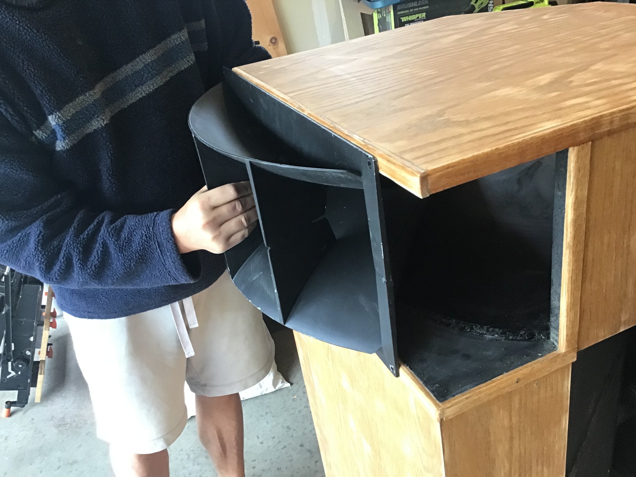

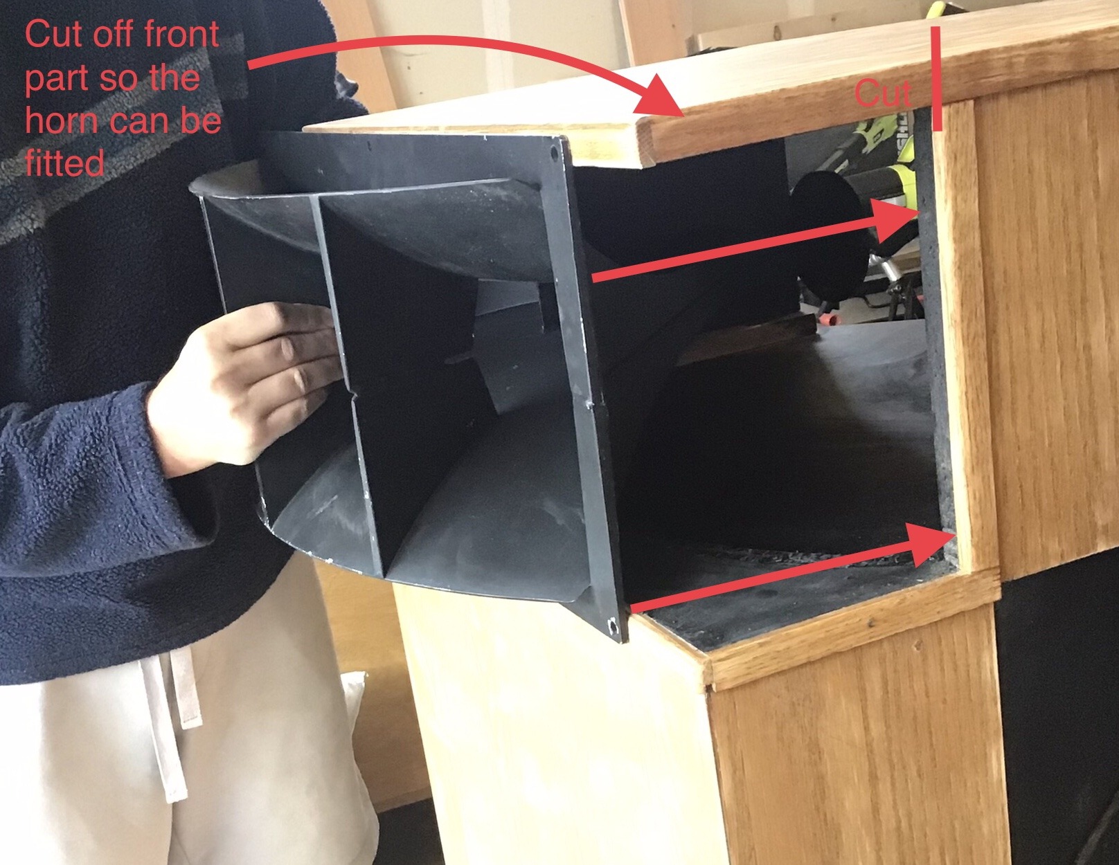

I bought a pair of Altec 511B horns (with the 808's) off ePay and to my dismay they do NOT fit the top box. I contacted the surviving member of the pair of lads who built these back in the 80's and he tells me that they 'cast their own horns' using a mold from an original. Their home-cast 511B's didn't incorporate the full sized flange so their version of the 511B was smaller and they didn't build the top box large enough for an OEM horn.
The damn horns don't fit the box!!
