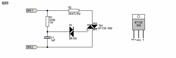

the value of the protection components varies with:
the output device SOAR,
the output device temperature,
the PSU voltage,
the charge held in the smoothing caps,
the emitter resistor in the output stage,
the transient capability of the output stage,
the transformer regulation,
the size of the heatsink,
the value of bias current.
I cannot give a simple answer. I am not prepared to investigate every different combination of all these variables.
