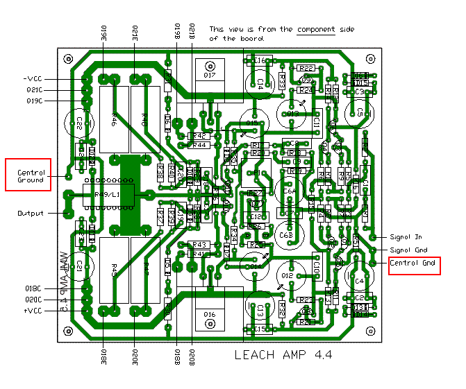

Thankyou now I have understood 🙂
On the pcb there is the connection of the mass of signal and the mass of power.
Both go connected to the central ground.
(to see the PTH...)
See you soon 😀

Samoloko,
the trick of the low-tim amplifier is to have a very linear amp, aka large bandwidth amp, with the lowest number of stages.
Which is achieved by employing a triple darlington output stage, the combined high current gain enables the relatively low fT output devices to perform at audio frequencies.
Secondly, by linearising the Vas stage with the aid of a fast small helper, Q8/Q9 in the Leach schematic.
Making it sound better means making the amp even faster or reduce the number of stages, while keeping it unconditionally stable.
Download a schematic of an early ElectroCompaniet if you like to know more.
What you can do is discussed a zillion times at the large Leach thread.
Just tossing in some fancypants parts will not make it sound any different.
C6 should be non-polar, as advised by Prof Leach, or leave it out and use a quality DC-servo.
A stereo blue velvet Alps RK27 still is best value for money, anything better costs much more, you are the only one who can look inside your wallet.

Does anyone have a list with decent parts? Im having trouble getting those out-of-date parts listed. I was thinking about MJL4281A (NPN) and MJL4302A (PNP)(end-stage), and MJE15034 (NPN) and MJE15035 (PNP) (drivers). Not sure about them, and I have no clue how to replace the others.
The drivers are fine. Flat pack devices are not recommended with this PCB, but there is a redesign by Jens Rasmussen that allows this: http://www.delta-audio.com/Leach-Clone.htm
MPS8099/8599 are available from On Semiconductor. If you are having trouble getting them then you can use MPSA06/56, they are not as good, but they will work.
I suspect the devices you are having trouble with are the 2N3439 and 2N5416. For these, MJE340/350 is often substituted but they are a different package and not easy to use with Leach's PCB.
