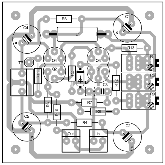

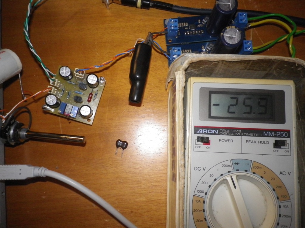

R9 is the DC trim. You may be sending ~1uA of DC through your cart (if I assume correctly that is what you're doing). Either that or your BC560 has ~250Hfe. Or possibly it is running at double it's intended current (could happen if you don't use Fairchild transistors). To adjust R9 all you need is a DMM.
Why is it recommended to use the Fairchild transistors? What is wrong with the ON Semi ones?

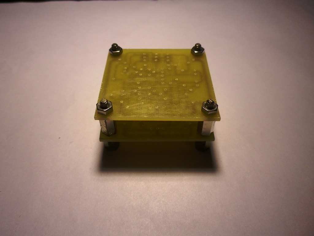

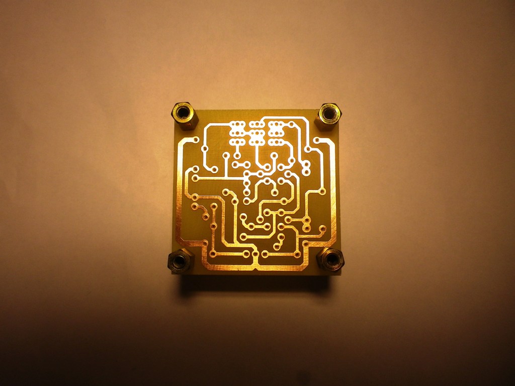

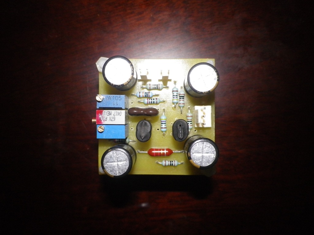

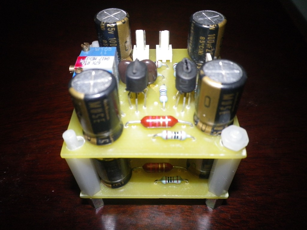

Here is my buffer from Keantoken the board is from Project16
I use unmatched ON Semi transistors , my offset is 0.1-0.2 mv.
i put total 3,7ΜΩ resistors for R12 .
i use 10uf cap before the buffer and 10ΚΩ and 50ΚΩ pot.Super quiet...

The Kuartlotron webpage schematic gives instructions for changing resistors to accommodate Vbe. There is also a possibility it could be unstable, but I haven't seen it so far. You may get acceptable results without any changes, although your input transistors will probably be running low bias.
Thanks Kean
i will decrease the R1 nad R2 to 52Ω or 47Ω....and i will readjust the R5 trim ...
When i change the 15pf to mica cap i put 5pf the only available , the sound change for the best ,sound completely clean...now

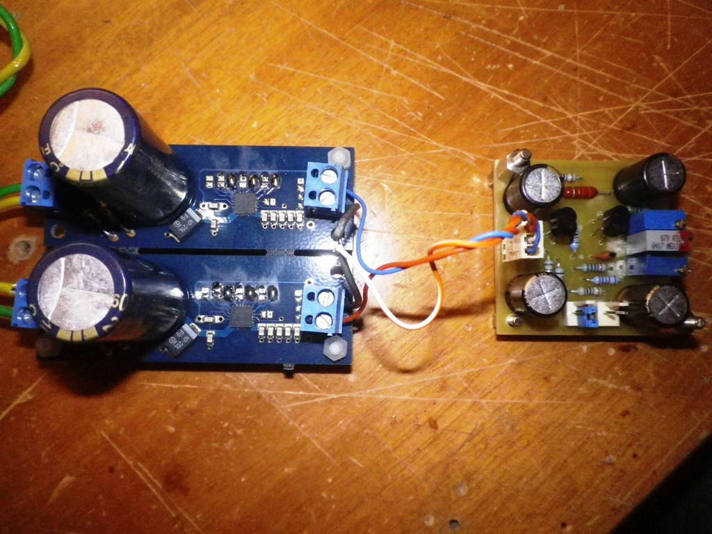

the 25mv on multimeter are the output from my amplifier Golmund clone 9.2.
with SuperBuffer after my DAC AK4490.

Yesterday i had make some tests with Buffer after the dac 4490 Discrete (the Dac has 0.1Ω output impedance) i put on buffer 100ΚΩ without any pot just the buffer
at the high levels volume via foobar understand some correction of THD if that makes any sense.
