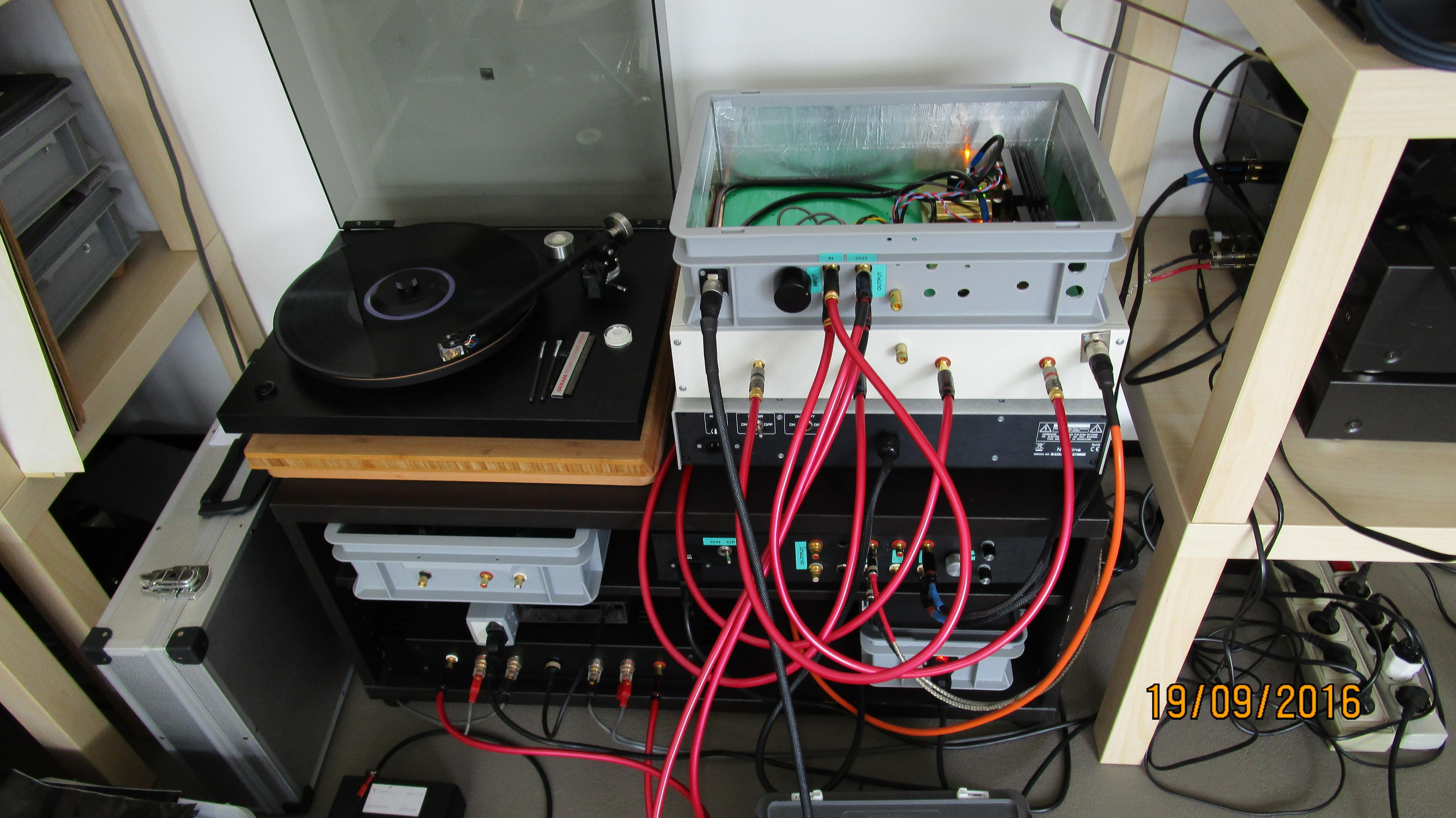

Two days ago I received two Kuartlotron boards (new version) from Kean. I started populating those asap and it was a breeze to do so... all parts are perfectly identified and the pads have good sizes. The transistors holes are far apart so soldering is quite easy to do.
I did not match the transistors better than 10% and got output offset lower than 10mv.
Second day (today) I prepared a case, connected a pot and two 10v V12r (modified) regs from Salas.
The scope showed wonderfull squares up to 500MHz and absolutely no phase shift whatever voltage or freq I dialed in.
Then I connected the rig to my lab system and guess what.... a true breath of fresh air... The Kuartlotron is an exquisite piece of elegant engineering and it delivers.
Effortless dynamics, punchy tuneful bass blending to the wonderful flowing mids and topped by some of the best highs I ever experienced.
After I built my p2p DCB1 with modified V12R I believed there could not be anything better but now I have a serious contender.
Must thank Kean for sharing this special buffer and for letting me beta test it's new board.
Some pics

Thanks Ricardo for your comments. I have very similar experience. I was almost sure that nothing can beat Erno Borbely EB325 preamp. However Kuartlotron changed my opinion in two ways.
The first - There can be even better pre than EB325, especially in low level details
The second - every preamp with bipolar input stage I have ever built/heard did not sound to my taste. The hights were almost allways harsh and some kind of wildeness was present. This is absolutely not issue with Kuartlotron.
There is no sign of anything I am used to with bipolar input stages.
Note to my construction:I am feeding Kuartlotron with +/-12V and I have no capacitor at output since there is already one at the input of my power amp. Another mod on my side is absence of trimmer R9 for minimizing the distortion. I do not have distortion meter so I just tried to set it with my ears. I finished with 1Meg resistor on this position.
Congratulations to Kean one more time.
Ladislav
R9 is the DC trim. You may be sending ~1uA of DC through your cart (if I assume correctly that is what you're doing). Either that or your BC560 has ~250Hfe. Or possibly it is running at double it's intended current (could happen if you don't use Fairchild transistors). To adjust R9 all you need is a DMM.
