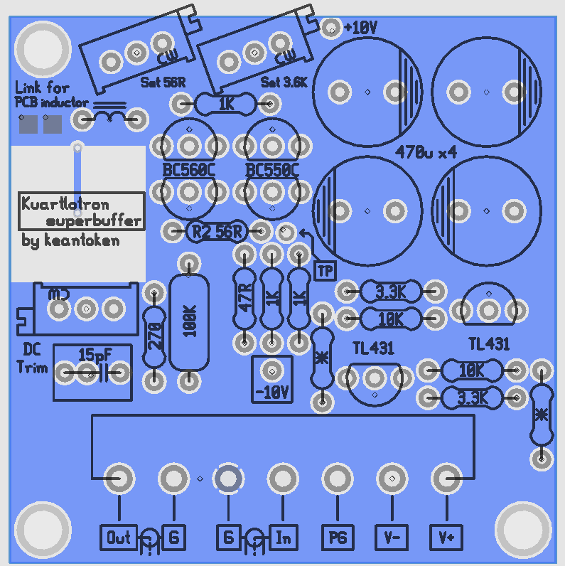

The new PCB will be more functional, but sound quality won't be any different. The first one has some errors, and I've gotten a bit better at PCB layout since then. I'm nearly out of PCBs, so it's only natural to make some updates. In short, the PCB is changing because I'm changing.
Here is a PCB with side trimmers for stacked setups, enlarged via rings for better soldering, and a hunky RN60D on the input for scale. Imagine if I tried to make all the resistors that big.

Ah, I didn't now there was EMC problems with holes in a ground plane - doesn't apply to the component holes? Ideally, smd components only on the one layer?
Can bigger clearance holes, irregular shaped apertures, slotted/sectional planes (as per Tentlabs), etc reduce the EMC reasons or does any/all perforations create problems? [Is it a design protocol and how significant to sound quality would it be to ignore it?]
Circular holes are the most benign, so the pins aren't too bad. In most cases, perforations probably don't cause problems for audio unless there is a grounding mistake. But I figure, if it has a ground plane, why not go all the way? In any case, I was able to widen the solder rings.
I've also added some random solder pads for those that might want to add stuff, as well as a pad for one of the screws if you want to connect the board to chassis (sometimes there are reasons for doing so).

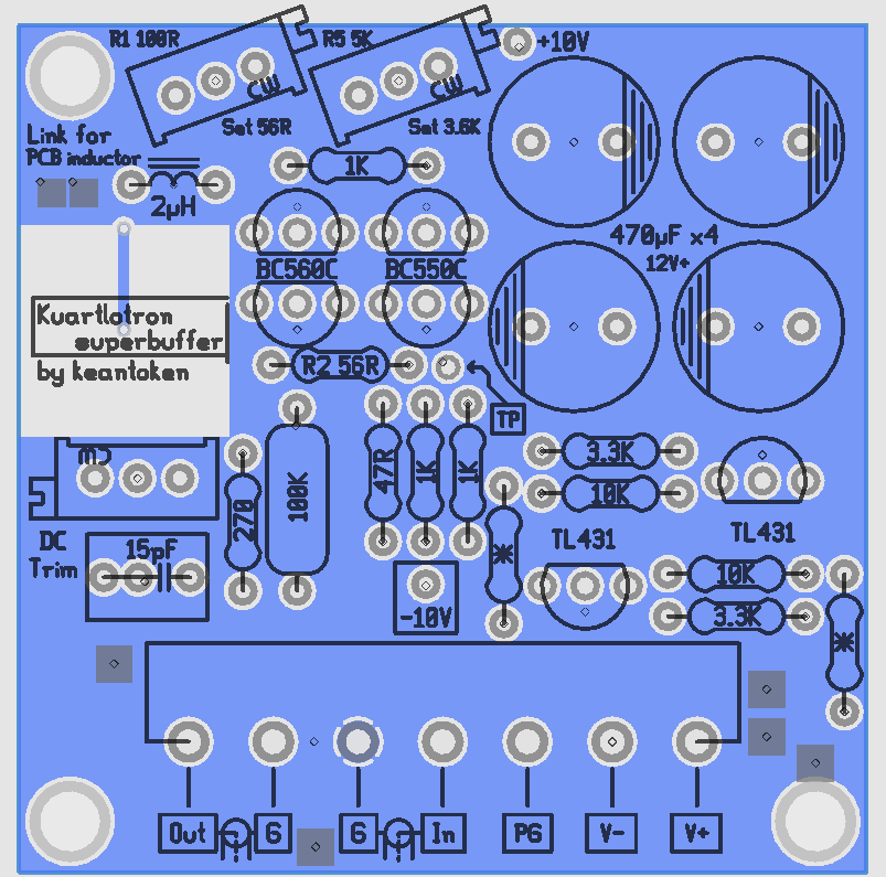

I'm close to getting this printed.

Same thoughts as I had, but then the text wouldn't fit or would be too small to read. Also there are traces running between them that need space. So I could move them closer but not by much.
Oh well, it's easy to back seat drive, I'll shut up and leave you to it. I think I can manage shaping a lead or two 🙂
