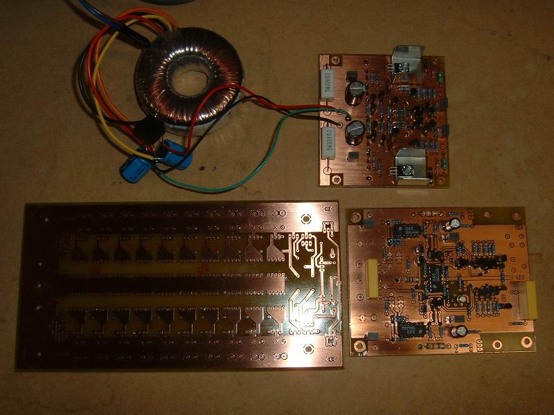

Well I’m finally getting stuck into this project again. I’m posting a progress report to give me some incentive to get moving a bit faster.
The +/-45V power supply board for the front-end is completed, tested and working. The input stage / VAS board is 80% loaded. This circuit is pretty straightforward and there really isn’t any question over whether it will work or not.
The power output stage is a gamble though. Ten pairs of these high fT (as high as ~90MHz peak) TO-220’s in parallel will have a rather high net gm. The thing may work like a dream or parasiticaly oscillate its head off.
Anyway, if that turns out to be the case I’ll just have to ditch the board and resort to a conventional output stage with some pairs of 3281/1302. The board is drilled and lacquered, should get it loaded tomorrow and mounted to the heatsink if I’m lucky. I’ve also made a few revisions to the OPS circuit posted a page back. For better temperature compensation I added a pair of diode-connected TO-126’s in series with the dual transistor VBE multiplier, which mount directly on top of the pre-driver transistors.

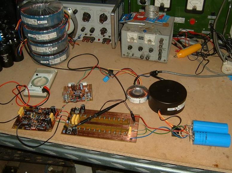

It works!
Well so far, anyway. I did not get time to get the power output board fully loaded today, but I did get the whole thing up and running minus the driver and output transistors.
I soldered in two series resistors for the resistor between the emitters of the pre-driver transistors of the triple emitter follower output stage and took the negative feedback from the centre junction.

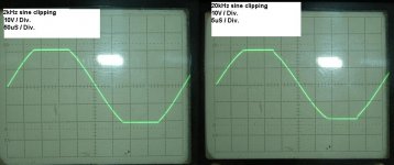

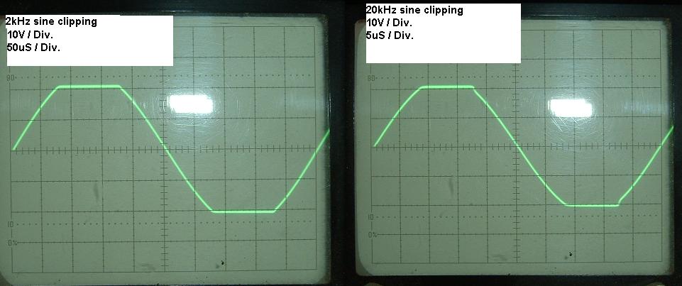

And here is the clipping performance, 2kHz and 20kHz.
The amplifier is currently frequency compensated for a unity loop gain frequency (-3dB bandwidth) of exactly 1MHz using Miller feedback compensation.
This form of compensation returns a high slew rate from the VAS, but comes at a small cost of slight rail sticking on recovering from cliping, as a consequence of the compenation which has to be applied to the Miller loop.
The sticking can be seen in the picture attached. It is only very short, invisible on the 2kHz waveform but obvious on the 20kHz waveform
I explained the cause of this sticking in post 2500 of the Negative Feedback thread here:

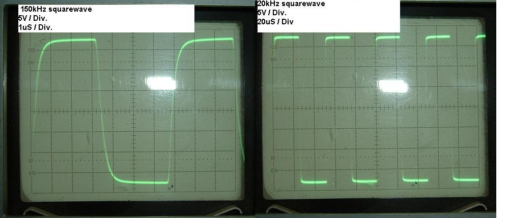

As stated in my previous post, the unity loop gain frequency is currently set to 1MHz, but this will be subject to some tweaking.

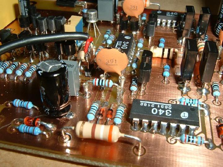

Attached below is a close up of the input/VAS board, showing how I mount the compensation components for easy tweaking. I butcher a machined pin IC socket for its individual pins and solder the into the PCB holes for the compensation components (which are then just plugged in with trimmed leads)
When I’ve found the optimal values I just solder the leads of the components into the pins.
