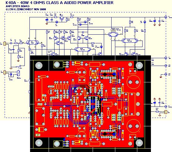

jam said:
I would like to see the board layout for this. 😎
Slowly making progress......
I decided in the end to revert to my usual method of splitting the input/VAS and OPS onto seperate circuit boards.
The +45V and the -45V regulator boards for the input/VAS supply rails are underway now....
Glen

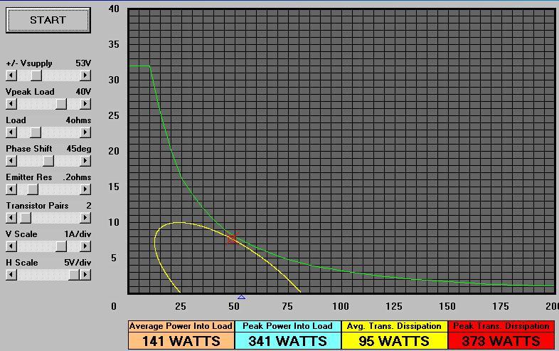

Yes and No. The thing is with modern bipolar output devices, SOA freedom isn’t as much of as issue as it used to be, even when building moderately high power amplifiers.
I’ll give you practical example of a 200W / 4ohm “single-ended” Vs bridged design with a load-line / SOA calculator I whacked up some time ago in MS basic.
Attached below is the load line for the single-ended situation. For an output power of 200W rms into 4 ohms the peak output voltage is 40V. The supply rail is set at 53V
The yellow trace is the output device dissipation through 180 degrees with the load current 45 degrees out of phase to simulate a realistic reactive load.
As can be seen, the transistor load line just fits inside the green trace, which is the SOA for 2 parallel pairs of MJL21193/MJL21194 transistors.

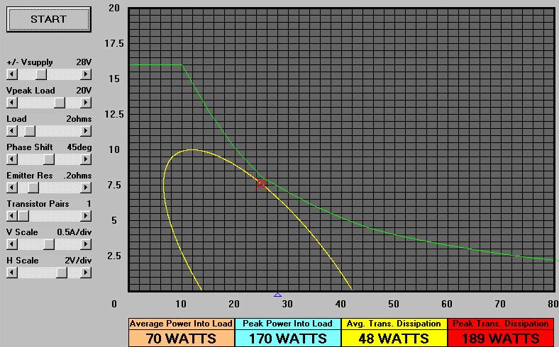

And here is the bridged scenario.
For 200W rms into 4 ohms bridged we essentially need two anti-phase output stages rated at 100W into 2 ohms.
This is what is simulated in the attached screen shot. The peak output voltage is now 20V and the rail voltage is 28V.As can be seen, the load line is now enclosed by the SOA of just a single pair of output devices, but there isn’t any greater SOA freedom over the previous case.
Now consider a summary of the two options.
With 200W into 4 ohms the peak output/load voltage is 40V.
The peak load current is therefore 10A.
In the case of the single-ended amplifier with two pairs of output devices in parallel, each transistor passes a peak emitter current of only 5A.
In the case of the bridged amplifier with one pair of output devices per side, each transistor passes a peak emitter current of 10A.
The output stage of the bridged amplifier will therefore have significantly greater non-linearity due to the beta droop at high currents. This will be offset to some degree by the cancellation of even harmonics though.
The bridged version will also have significantly less reserve for delivering high peak load currents for brief bursts into less than nominal load impedances before the maximum Ic ratings are exceeded.
Glen

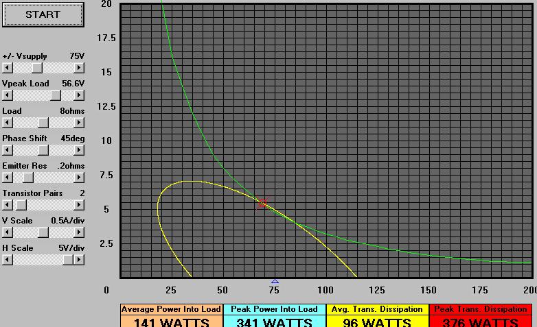

Hi Pete.
This leads to another thing that is worth pointing out. Secondary breakdown limiting for the MJL's starts at about 75V.
Even so the sum of the rail voltages is 106V for the single-ended case, it can be seen from the first graph that I posted that above 75V Vce, there is very little current requirement.
The results aren't as bad as you'd think for a higher voltage situation either. Attached below is the single ended scenario for 200W into 8 ohms with +/-75V rails, again with two pairs of output devices.
With "balanced bridge" you loose out a bit on efficiency also because to have to provide an operating supply rail headroom for two power output stages. Generally, the bridged amplifiers total voltage rail headroom will be more than that of the single-ended situation, unless you want to build stiffer supplies by spending all that dough you saved on the cheaper lower-voltage electrolytic filter capacitors on even more uF and maybe even a bigger, better regulated transformer as well.
Glen

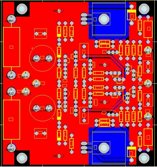

Nice!!!
I'd try to get the red base drive trace under the emitter resistors so I could get a ground plane from upper to lower decoupling on the red side though... But maybe it won't be able to get through where all resistor connections are in a row? Could be solved by moving every other emitter resistor half a resistor length lengthwise 😀 It would look a bit strange though (but maybe cool?)
Or would that give too much capacitance from output node to ground?
megajocke said:
Thanks!
Here is the complete board; should give a better idea of what I was trying to do - earth return current flows back over the supply rail tracks.
The Vbe multiplier transistors will be mounted off board with short twisted wire leads. The output inductor and parallel resistor will be mounted off-board on stand-offs.
The on-board caps are only small local bypassing (4700uF per rail). Yeah, OTT, but why not? 🙂
Top layer:
Bottom layer:
Glen

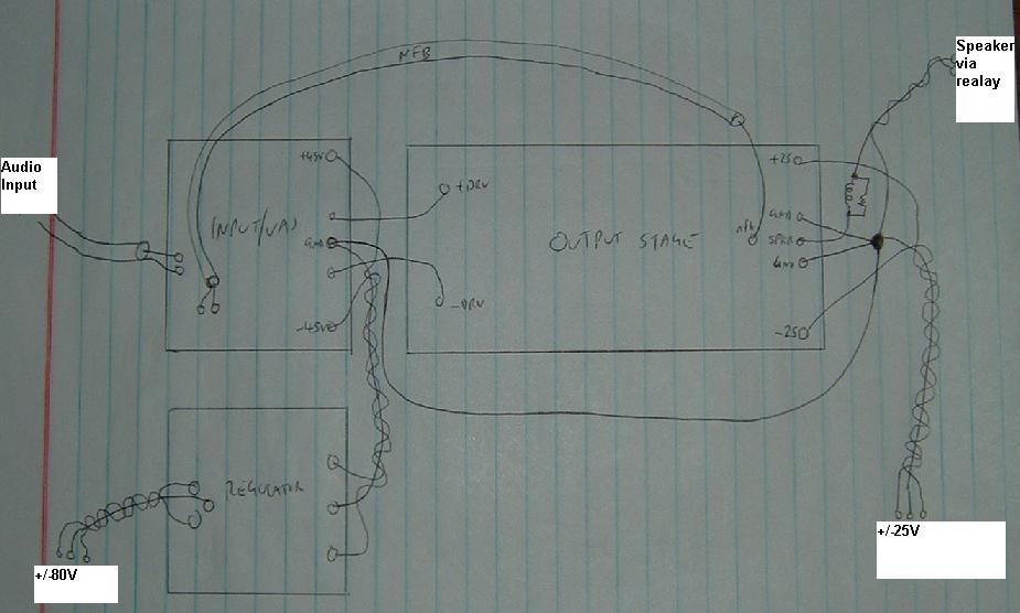

Basic power supply and signal wiring.
Now all that is left to lay out is the the uC protection / relay timer DC detect / soft start board. I'm using a thermal circuit breaker for the mains in conjunction with a telema (sic?) current transformer feeding the ADC input of the PIC uC via an averaging detector........
