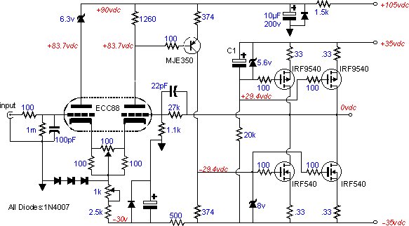

AKSA said:Kleinschwantz,
I'm glad you felt the need to explain your often verbose designs. This one is not too bad, however, the use of the tube in place of the usual SS LTP has been done before (in Italy, in fact) and would not sound much different to the real thing since its wrapped in a global nfb loop.
I did not comment personally on your use of the VAS protection scheme, if you read closely. You have some sensitivity here, it seems. The design is competent, but unoriginal.

Hello, Suzy
Never considered to let your designs be more known, group buy maybe? The pcb looks really good and I'll guess the performance is quite good also.

That should work. You'd just have to connect the negative rail to ground and use it as a single rail supply. Was the SC rated at 15W into 4 or 8 ohms? Depending on this the 10A will deliver either more or less than the rated 10W in 8 ohms, but the design is scalable either way.

Hi Glen,
perhaps I should not contaminate the air here but I have gathered sufficient courage to post my opinion, I can hardly get more odd than I already am, can I.
As with hybrid topology highest sound quality is achievable, it is a splendid idea. The details show the dramatic difference in our view regarding design principles. Guess (just once) which one I prefer, yours or the German guy`s on that site. I would omit the VAS stage and go for lower mu valves.
- The Kleinschmidt 10A
