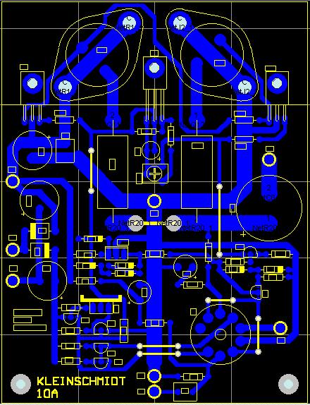

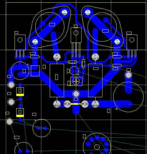

Anyway, with the big filter cap removed from the PCB, the layout of the K10A just didn't look right, so I decided to redo it.
This is as far as I have got, for now. Now I going go away to eat dinner.

The completed layout is shown below. I'll that I still need to do is tidy up the component overlay.
It will be at least a couple of weeks now before I get the boards from the manufacturer.

Leaving the heater coil connections as is ?

jacco vermeulen said:Leaving the heater coil connections as is ?
Yes, I decided to remove the 120-150 ohm series resistor from the board, as it takes up too much space (dissipates about 3W).
There are three options for powering the heater:
DC, via an externally mounted 120-150 ohm ~10W wirewound resistor from the filter capacitor + terminal.
DC, from an external regulator 12V / 12.6V regulator, for those that want to do it fancy.
AC, from a 12.6V 150mA transformer secondary.
The first one is my recommendation.

G.Kleinschmidt said:What kind of interest would there be out there for a very simple, but good performing 10W class A (into 8 ohms) rated power amplifier:
a) specifically designed to be build as a monoblock.
b) TO-3 complementary BJT output.
c) Of the single polarity supply / capacitively coupled load topology with the esoteric twist of having a common as muck 12AX7 twin triode in the front end.
d) Specifically designed to be built from non-esoteric, cheap, universally available parts.
e) All components (bar the two transformers and one bridge rectifier) PCB mounted for ultra-easy assembly.
I have design I made quite a while ago and considering the popularity of the JHL class A, I’m seriously considering publishing it and having a batch of boards manufactured (to be sold for profit in fame only)
Specifications are not subject to negotiation, and no audiophool blowhard arguments about the evils of coupling capacitors and mixing SS with toobs, thanks.
Glen
What about a simple pass regulator, with the pass element mounted on the main heatsink? Would be cheap, simple, elegant. (Of course a single dropping resistor is the most simple/elegant/cheap method. But I really don't like hot resistors.)
I decided against it because it would make the board bigger.
By leaving the heater supply off the board, the builder can choose to use which ever method suits them best.
