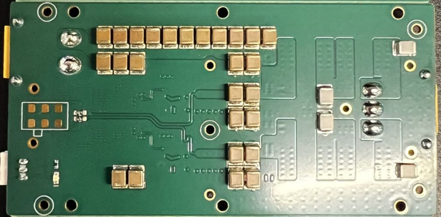

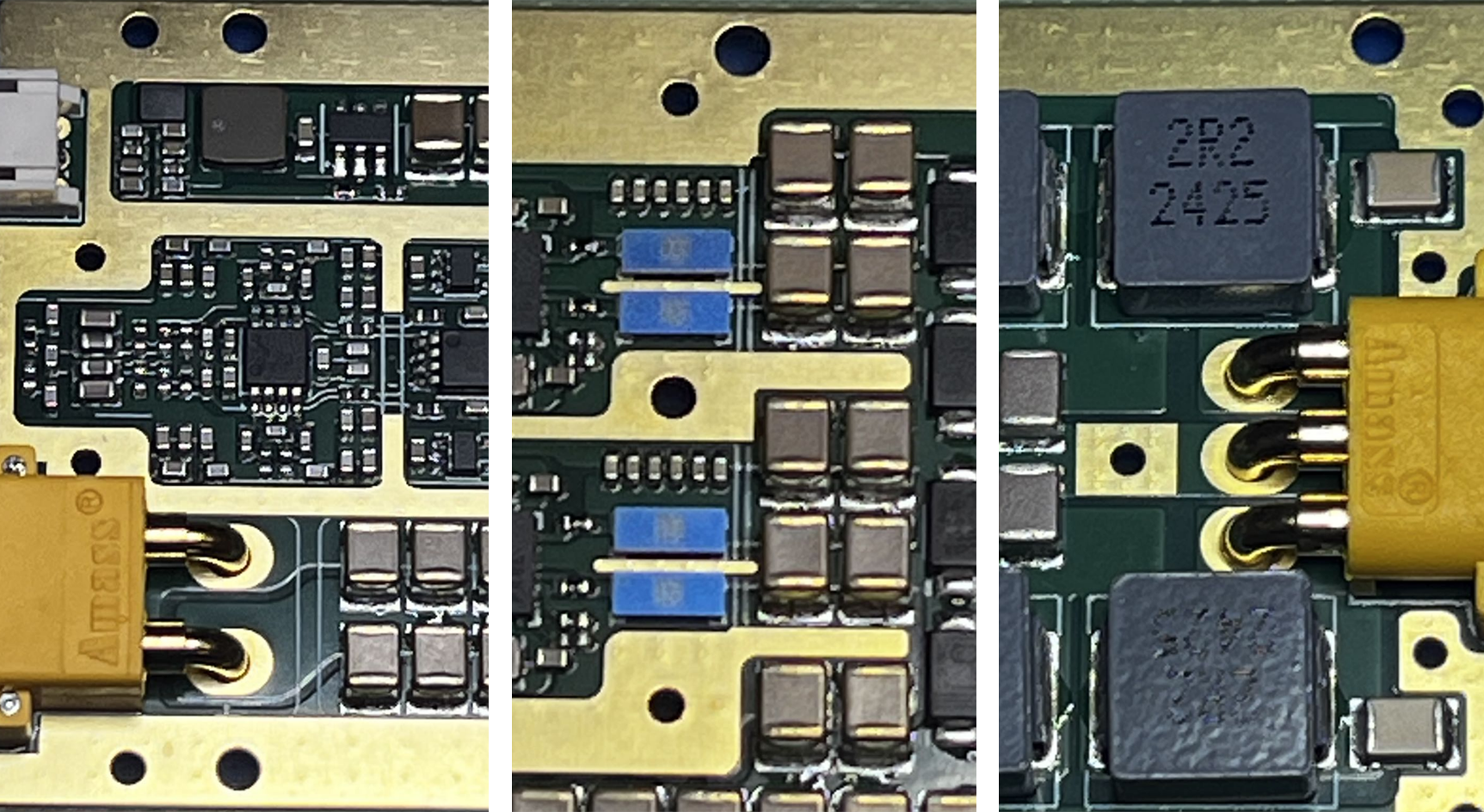

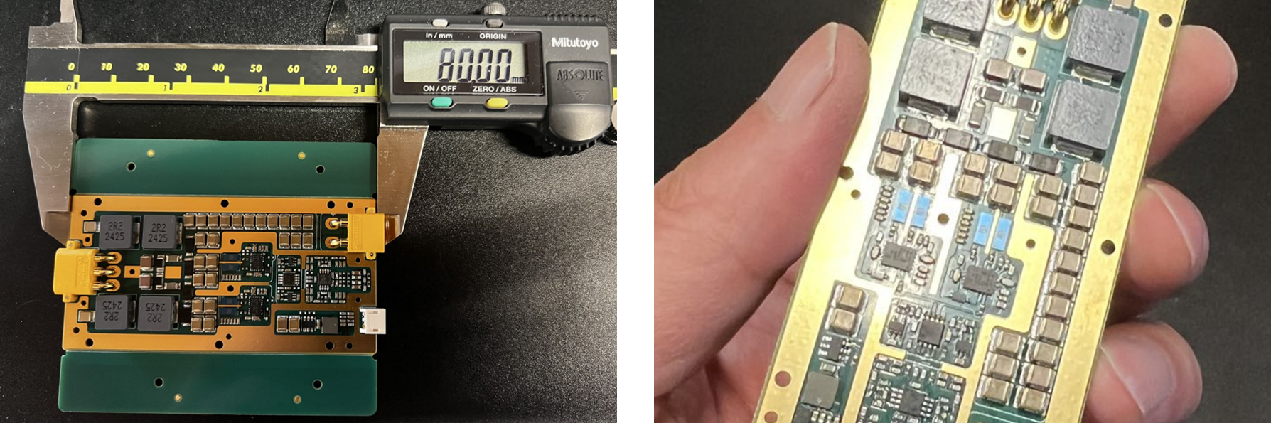

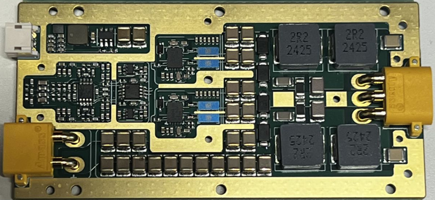

hope this small, cute board will give me a big, sweet Suprise!!!
The board was brought up today. The good news is that the circuit begins to oscillate upon power-up, and the pulse signal quality is excellent, with no ringing at either the rising or falling edge. There's only a slight overshoot, which I believe may be due to my oscilloscope's input response.
The bad news is that the oscillation frequency starts at 230kHz and increases to 368kHz with changing some caps and resistors, which is still significantly lower than designed. The static power consumption decreases from 8W to 5.5W as the frequency increases, likely because the lower frequency causes the inductors to saturate.
I will continue debugging with the following steps:
  1. Check the bootstrap capacitor for the high-side driver. I added a large 22µF capacitor there, which may need to be reduced to 0.47µF.
  2. Verify the propagation delay of the LMG1210. The datasheet states it's typically 11ns but may vary up to 21ns, which could be problematic.
  3. Consider disabling the LMG1210 temporarily after the device is powered up, until the rest of the circuit stabilizes.
  4. To prevent board damage, I added a 10-ohm series resistor to the power supply, which may impact the oscillation frequency.
Any suggestions or comments are greatly appreciated and welcome.

Yes, I change the hysteretic resistor, the frequency increases from ~200k to ~300k. the sigma-delta modulation circuit is reuse what used in my first headphone amplifier project. the problem should be introduced by the new driver and GaN Mosfet.
the same problem was found when I debug the headphone amp, it is because of value abuse of some resistor and capacitors. I will double check the circuit design tomorrow.
The resistor connecting the comparator output to the LMG1210 PWM input was accidently set to 1kΩ. This resistor was originally intended to prevent signal reflection. Assuming the input capacitance is in the range of a few pF (not specified in the datasheet), it may introduce an additional delay of several nanoseconds, potentially exceeding 10 ns.
that is bad, I will change it back to 10Ω or even 0 tomorrow, to see what will happen.

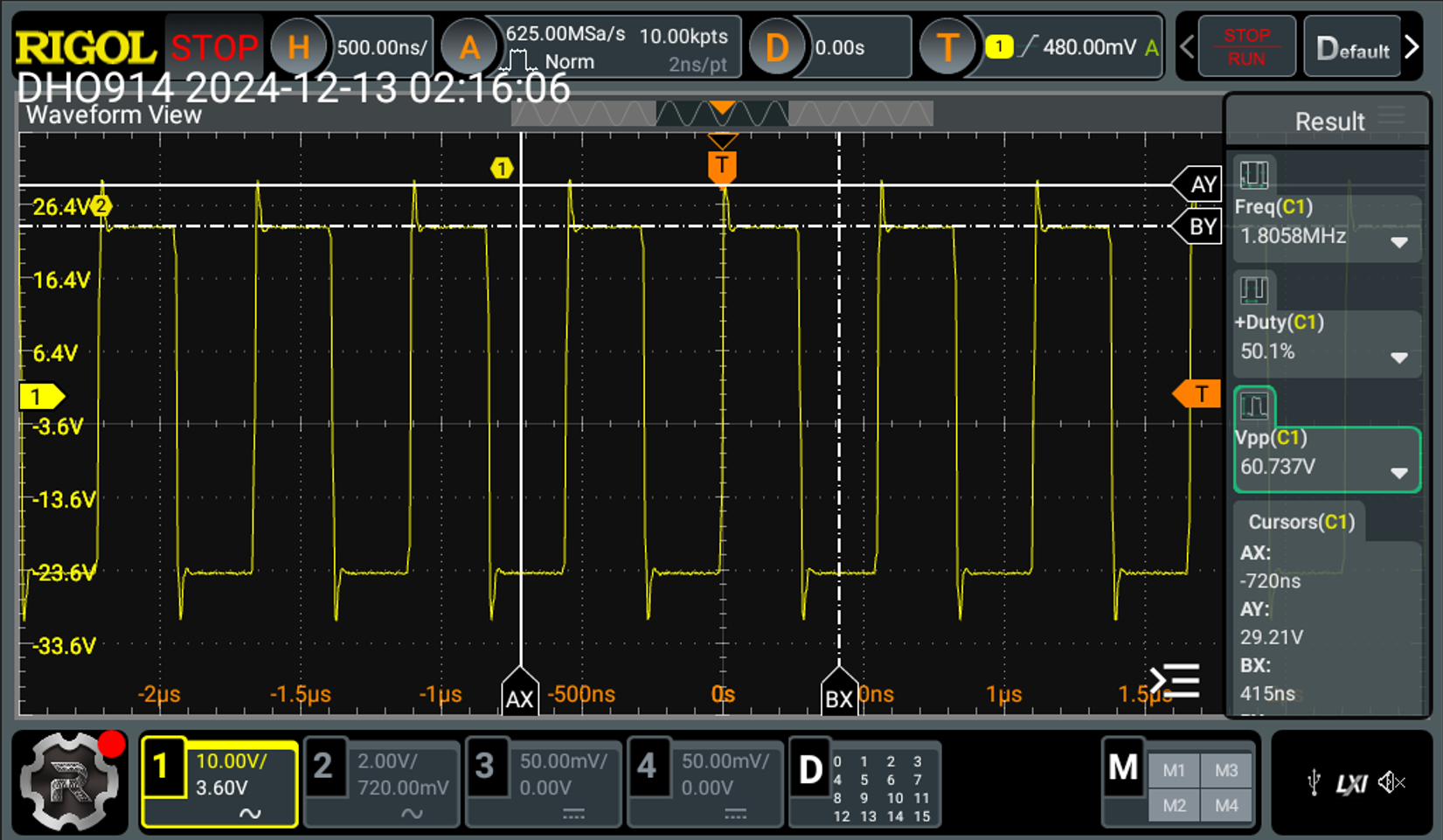

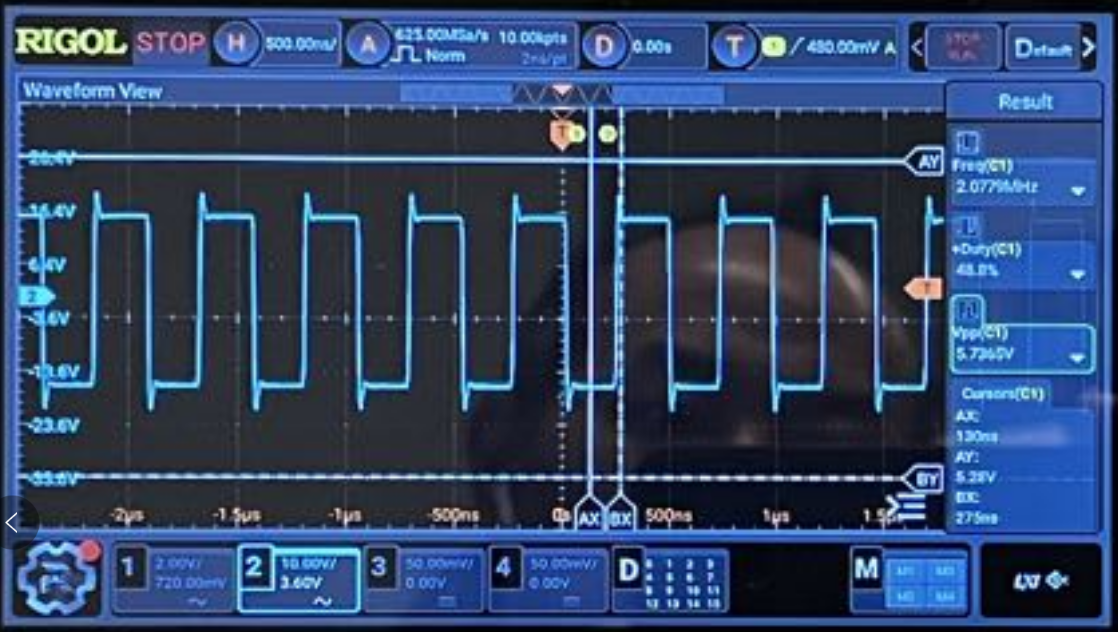

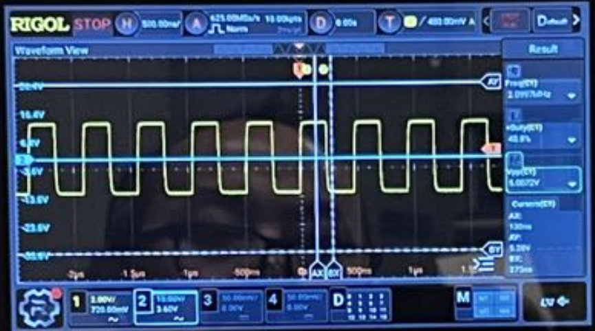

Good news! Problem solved! The amplifier can now run up to 4.2 MHz. The figures below show the frequencies at 3.2 MHz and 2.0 MHz. --the dead time is set as 8ns.
Based on my experience with headphone amplifiers, 2.0 MHz is sufficient. Its performance lies between DSD64 and DSD128 (with the highest bandwidth of DSD64 being 1.4 MHz = 2.8M/2).
However, the static power consumption is about 15W at 4.2 MHz and reduces to ~7.5W at 2.0 MHz. Due to the absence of a heat sink, the performance hasn't been fully tested yet. A quick test shows the DC offset is approximately 2.4mV.

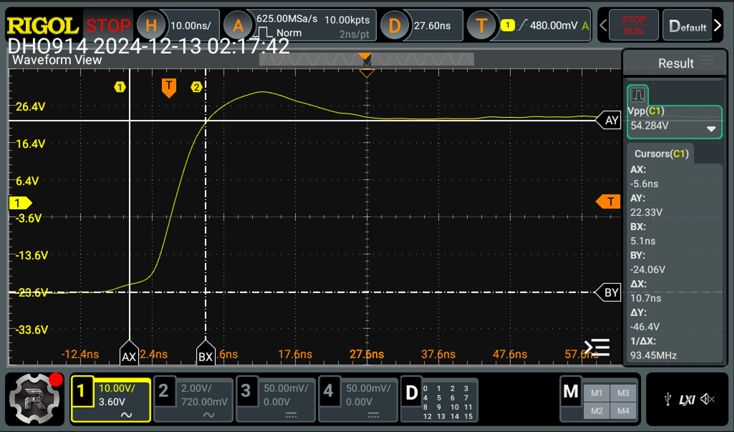

tune the operating frequency down to 1.8MHz, and with a small heat sink, I can perform a longer time test right now.

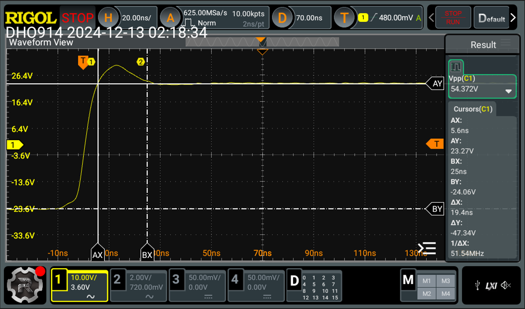

with input short together, it runs at 1.8MHz. overshoot is 6V.
the rising edge takes 10.7ns.
The overshoot lasts for 19.4 ns and damps very quickly, with almost no subsequent ringing observed.
