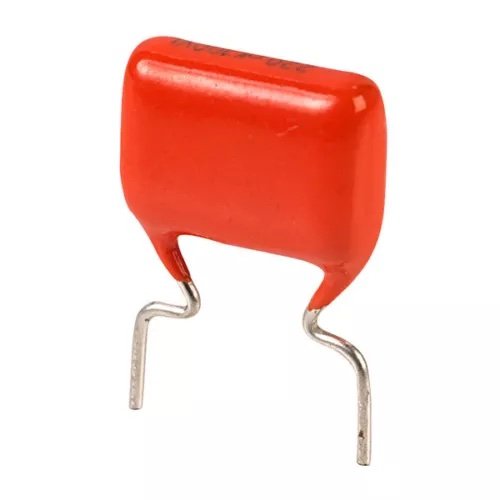

What type of capacitor are you using? The choice of capacitor is often more critical than the inductor in LC circuits.
Hi!What type of capacitor are you using?
Just this type, regular polyester.
I can't recall the source, some are from Farnell and some are from eBay but they all seem to work Ok and have much bigger voltage ratings than they see.
I know the chip types can have weird non-linearities - varying capacitance with voltage IIRC.

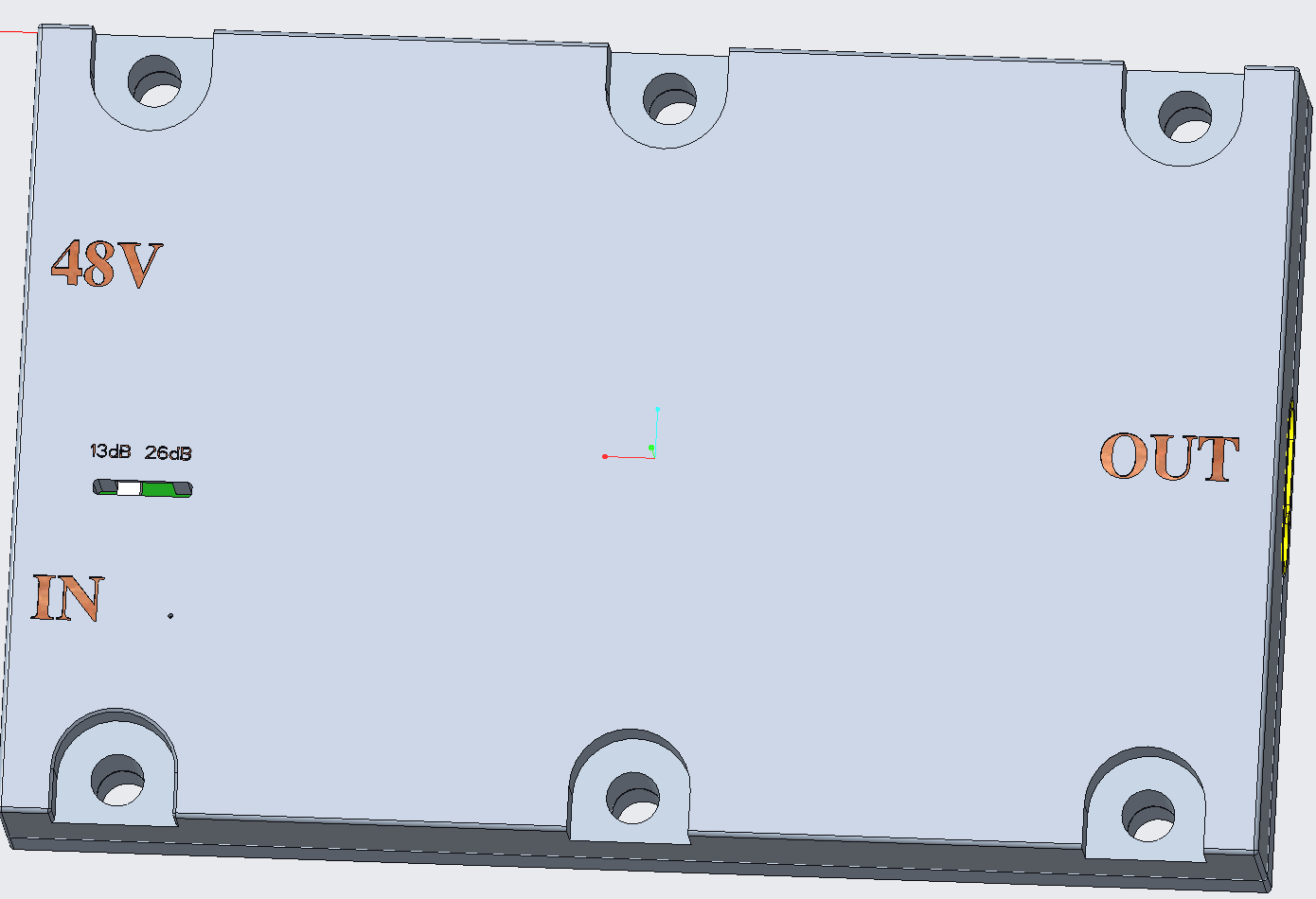

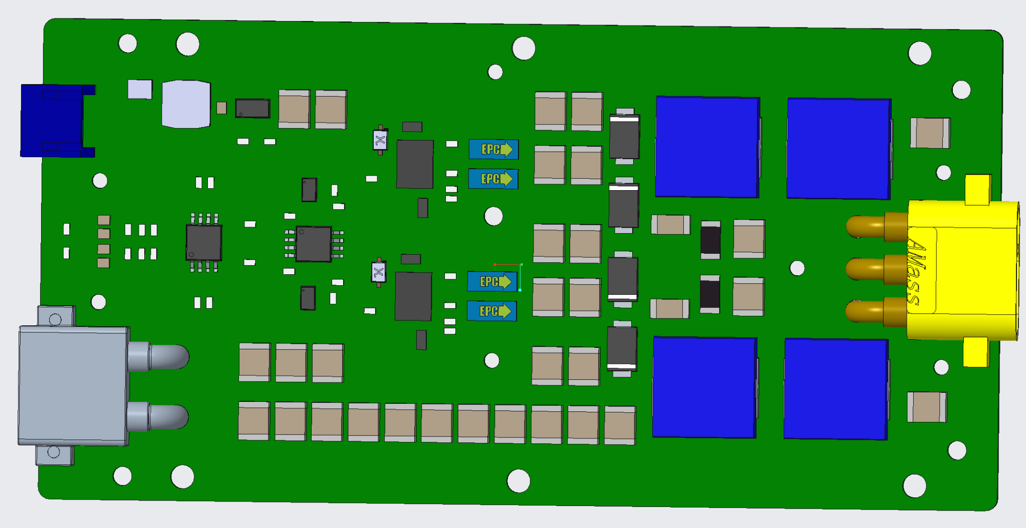

As I remember there was huge consternation about melting coils and RF transmissions, but perhaps as it's just magnetic, not electromagnetic, I didn't have any trouble with them and I found the sound very sweet.
I completely agree with you. the protection circuit will be included in the AMP, but not in this module at the moment.
If it is encased in aluminum, eddy currents in the aluminum will be shorting out the air coils, heating the case and reducing filtering effect. This is one benefit of shielded inductors, minimal interaction with nearby metal.
Worse I think would be an earth plane of the PCB, as iyt's copper and right next to the coils 😀If it is encased in aluminum, eddy currents in the aluminum will be shorting out the air coils, heating the case and reducing filtering effect. This is one benefit of shielded inductors, minimal interaction with nearby metal.
I didn't have the luxury of a new PCB, so mine stood up like trees, so the fields were on the plane of the board.
Between the two coils of each amp I'd look at the most favourable coupling / isolation.
If laying out a new PCB, I'd want holes in the PCB and the coils firing up and down, and then use 25mm standoffs do give them 25mm space above and below, and of course great cooling.
In my testing I just popped them back into the chinese case, they got slightly warm to touch, I'd reckon 10C above ambient perhaps. I did it to more then one amplifier and each time I liked the sound, and with a custom PCB I wouldn't consider ferrite, simply due to the shortcomings.
What is the DC resistance of your air coil?they got slightly warm to touch, I'd reckon 10C above ambient perhaps.
From my old link above 🙂What is the DC resistance of your air coil?
I decided on AWG21 (0.72mm) wire giving a 0.05ohm DC resistance for a 10uH inductor needing 38 turns.
Sent the PCB and housing to FAB today, PCB will be back in 10 days. Wish good luck for myself!

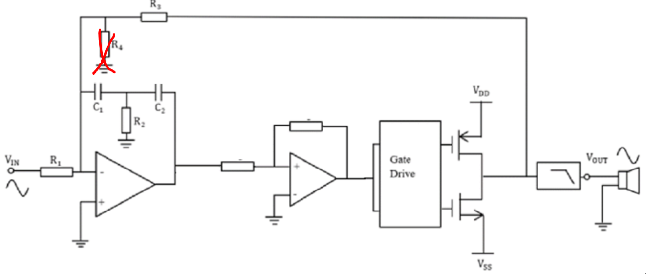

IMO, the issue whether R3 is also providing global negative audio band feedback should be simple to determine -- if, in the simulation or build, you raise the value of R3 slightly (by, say, a factor of X times with X on the order of 1.05), does the midband gain of the amplifier go up by 20log(X)? If so, that's negative feedback in the audio band.

@bwaslo thanks for your comments and experiences sharing!
the gain of the AMP follows the ratio of R3/R1 with certain voltage of supply power for the power stage, which given by 20*log10(R3/R1), interestingly, quite similar with op amp. please see my derivation below:
Assuming the Vin is positive, within a sample period, the Vin is close to a constant. Then,
T(low) = a * C/ (Vdd/R3 - Vin/R1) and T(high) = a * C/(Vdd/R3 + Vin/R1), where a is a coefficient according to the integrate circuit configuration, C is the capacity of integrator, Vdd is the absolute number of the power supply of power stage, T(low) and T(high) are the time duration of the negative and positive modulation pulse. And Vdd/R3 - Vin/R1, in this case, should larger than 0, otherwise the capacitor won’t discharged and the there is no oscillation.
The V(out) is proportion to the duty cycle, then,
V(out) = (negative duty cycle – 0.5) * Vdd (use negative duty cycle is due to the amp output is inversed)
the Gain = V(out)/Vin
Gain = Vdd* (T(low) / (T(low) + T(high)) – 0.5 )/Vin = ((R3/R1) * (Vin/VDD) /2)*Vdd/Vin = 0.5 * R3/R1
if the Vin is negative, the derivation should be the same.
As for whether it is an audio negative feedback scheme, this is indeed a rather controversial topic, these are some further explanations following the thread you quoted. please refer to it if you are interested.
I did extensive discussion this topic with my previous and current colleague who are interested. the general consensus is:
The traditional audio negative feedback is a typical infinity impulse response system despite its non-linear correction, whereas the DIYed AMP is feedback sample-by-sample, meaning the feedback will not propagate to next sample from its previous one. this is similar to the digitize processing of SAR DAC.
Please correct me if any mistake, and any further discussion and comments are welcome!

I am not understanding the relationship between the audio feedback and gain configuration, the above gain derivation is based on the PWM modulation, without borrowing any concept of the negative feedback in audio band to derivate the gain.
Isn't the integrator a memory element, affecting infinite succeeding HF pulses? I don't see where it is ever 'reset' by shorting the caps, and I assume it maintains linear operation.
Also, am I missing something, or is there a polarity inversion not shown (maybe inside the gate driver block)? Otherwise it appears that the oscillator would just lock up -- a rising input will cause the integrator output to slope negative and make the p-channel output FET to turn on and stay on, never getting turned off.
Can you show a Bode plot of output vs input?

thanks! @bwaslo
assuming that the Vin is a discrete signal aligned with the PWM cycle. when triangle wave cross zero (0 voltage over CAP), a new cycle start, and a new discrete Vin[n] come in. I don't think, at this moment, anything can remember what Vin(n-1) is. the power stage will output a new PWM cycle with its duty cycle represent the input of Vin[n-1].
Thank you once again for your very interesting discussion! It has been a great help in giving me deeper insights into the circuits. appreciate!!!
I think so, should have an invert stage before the power stage. the diagram is cited from a paper with minor modification (might be my mistake).(maybe inside the gate driver block)
in each PWM cycle, the triangle wave will cross the zero twice, if remove the hysteresis feedback resistor (for easy analysis, will not impact the analysis result), the voltage over cap of integrator is 0 when the output is crossing zero. I think this is the so-called 'reset'. The integrator is a linear circuit; however, it works in nonlinear state because of input of non-linear digital signal.Isn't the integrator a memory element, affecting infinite succeeding HF pulses? I don't see where it is ever 'reset' by shorting the caps, and I assume it maintains linear operation.
what you want to show, analog output vs analog input? if yes, it is very time-consuming, I am not sure I can complete it in a short term.Can you show a Bode plot of output vs input?

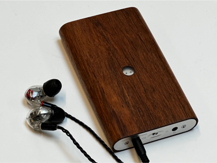

A key aspect of the evaluation is the amplifier’s noise floor. No matter how good the sound quality is, excessive noise can ruin the listening experience. My basic method of testing was through direct listening. Using Shure SE535 in-ear headphone (Figure 1) in a very quiet, enclosed room. I could hear nothing except the sound of blood pumping through my ears. This suggests the amplifier’s noise level is extremely low.
Figure 1,earphone for noise-floor test

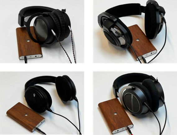

In the subsequent sound tests, I used several different headphones to evaluate the amplifier's performance. These included the Beyerdynamic T5 3rd Edition (closed-back, 32 Ohms) and Amiron Home (open-back, 250 Ohms), as well as the Sennheiser HD660S (open-back, 150 Ohms) and HD800 (open-back, 300 Ohms).
Figure 2, test headphones
Without comparing the DIY amplifier directly to other headphone amplifiers, simply listening with different headphones reveals their distinct characteristics. Below are the subjective impressions of how each headphone performed when connected to the DIY amplifier. These evaluations are a result of cross-verification between several friends and me.
Note:
Interestingly, opinions on soundstage width and height varied significantly among the friends. Some felt the soundstage was wider than shoulder distance, while others perceived greater height differences. This variance is likely due to individual subjective differences. The descriptions in the table primarily reflect my personal impressions.
Although each pair of headphones has its own unique sound characteristics, they all demonstrate excellent overall sound quality when paired with this amplifier. The common characteristic observed is the outstanding high-frequency and detail reproduction.
During listening tests comparing this DIY amplifier to several headphone amplifiers my friends and I had on hand, and based on feedback from music-loving friends, the following conclusions were drawn:
If I were to differentiate between the two, I feel the HD660S excels in delivering captivating and expressive female vocals, while the T5 3rd Edition shines in its unique charm when reproducing symphonies and instrumental performances.
These observations are the result of a collective evaluation conducted over a period of listening tests by myself and my friends. We’ve aimed to provide as objective an assessment as possible of these subjective experiences. However, since none of us are professional reviewers, please forgive any inaccuracies in the descriptions.
