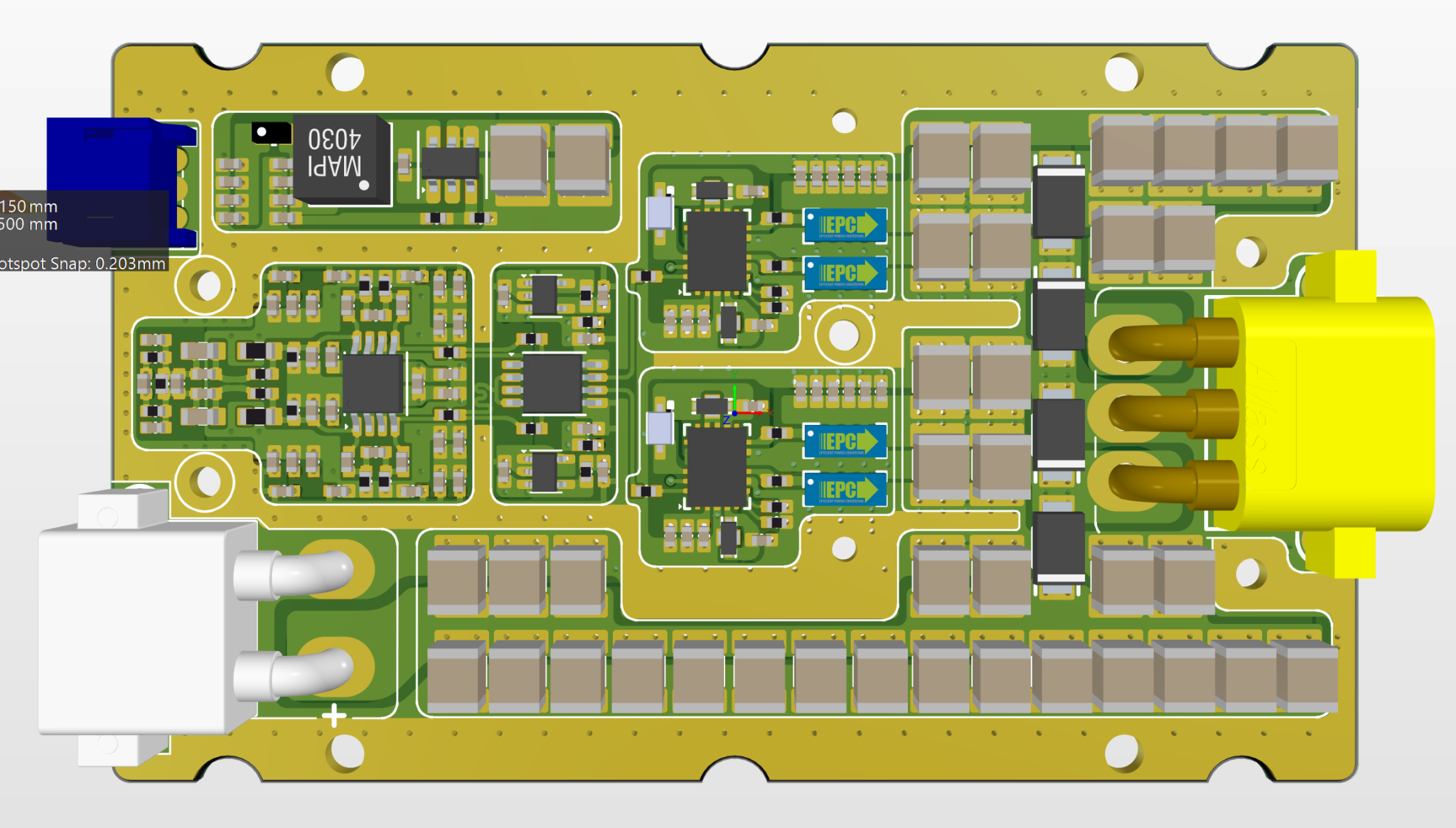

Designing a high-power version of the amplifier using the LMG1210 and GaN FET EPC2001C as the driver stage, with a 48V single power rail, delivering up to 150W into an 8-ohm load. Are there any recommendations for better GaN FETs or drivers?
This is a mono board - right? Size seems small... what dimensions?
Good luck!! Please do report findings and progress - I think this is an interesting project. What seems to be a design that don't have the rising distortion at higher frequency is one aspect that is very promising. Would be interesting to see the ordinary measurements i.e. frequency sweeps of FR, distortion, noise, phase and load dependency.
No output filter?

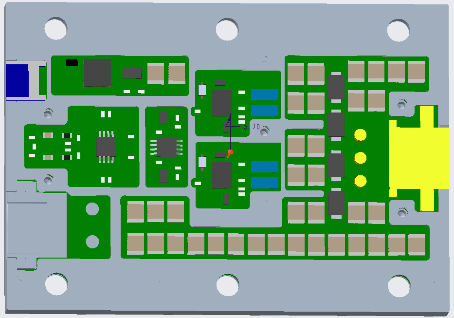

designed a aluminum house for the board for heat dispassion and shielding. the overall dimension is 68mm x 47mm x 9.6mm, it is pretty small.
actually, this project is amp module, an external filter can be connected to. I am trying to set the modulation frequency above 3MHz, no filter is needed, if the frequency can't reach as high as expected, then a external filter can be considered to filter out the high frequency components.No output filter?
Wouldn't it be prudent with a filter irrespectable of switching frequency? And most efficient if it is as close to the generator as possible?
There are probably som RFI rules that this module breaks by its own and building an amp that adheres to the rule will be harder if the filters is not on the same circuit board / ground plane?

The design screams that you have RF background but these words tell the opposite. I'm confused. 😆actually, this project is amp module, an external filter can be connected to. I am trying to set the modulation frequency above 3MHz, no filter is needed, if the frequency can't reach as high as expected, then a external filter can be considered to filter out the high frequency components.
Great point! this is the same question I thought about. to maintain the compact size of the module, the output connector (the rating current is 15A) has 3 contacts, 2 of the sides is for the audio output, the middle one is ground. if put the external filter close to the module, I think there is not too much difference than integrate the filter into the module, if keep the area of the filter loop as small as possible.if the filters is not on the same circuit board / ground plane?
RF behaves strange - there could actually be a considerable difference between a filter residing on a ground plane and hanging just outside.

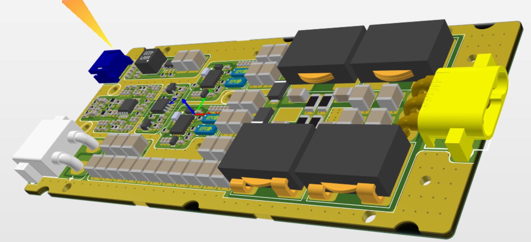

decide to add LC filter inside the module, thank you for your suggestion. modifying the PCB layout and housing right now. will appreciate if any suggestions.RF behaves strange - there could actually be a considerable difference between a filter residing on a ground plane and hanging just outside.
Add 2 level LC filters. 2.15uH+1uF and 2.15uH+0.33uF, variation of responds at 20kHz is less than 0.8dB with 2Ohm to 8Ohm load. 3dB cutoff is around 60kHz.
Looking good but I'm not knowledgable in implementation. Does this board have a load/impedance dependent frequency response? Variation described above is for filter section (stand alone) only - right?

How much longer did the unit become?
Why did you choose to make it double? Was a steeper filter needed? Typically we see two inductors per channel?

The frequency response depends on the impedance of the load because of Q factor of the LC filter. lower load has lower Q factor and the frequency response near the cut off frequency different accordingly. The LC filter design for this AMP module works with load from 2 to 8 Ohms, the frequency response at 20kHz is +- 0.8dB. BTW, the Class D AMP without LC filter is independent from load.
Indeed, the inductor is a key part for Class D AMP, it may introduce significant distortion if not select the right one especially for high frequency. the inductor I selected here following some disciplines: lower height, high current, low DC resistance, high Self-Resonant frequency etc. 2 filters are designed is for better phase responds (although phase responds is not important for the audio) and steeper filter curve too.
the board is longer by 23.4mm, the housing will be longer accordingly.
