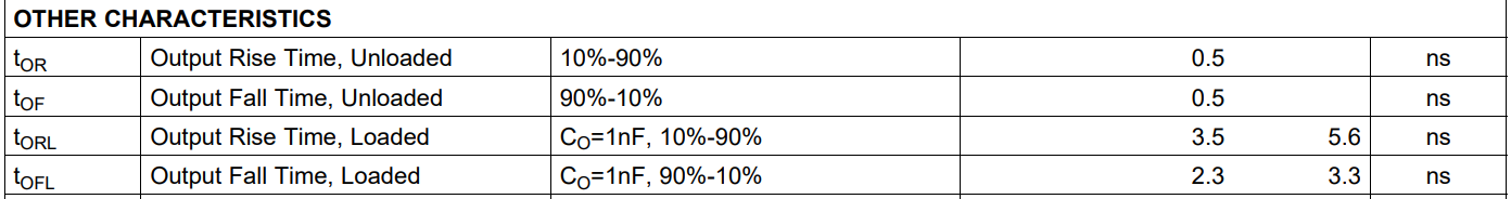

the LMG1210 datasheet announce the unloaded rise time is 0.5ns.
however, my result is 10.7ns, if it needs to minus the deadtime, then it will be 10.7 - 8.4 = 2.3ns, that is pretty close.
the inductor may slow down the rise time, I am not sure the inductor is a load or not.

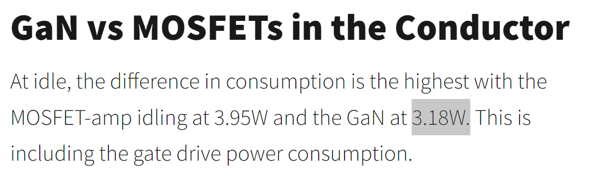

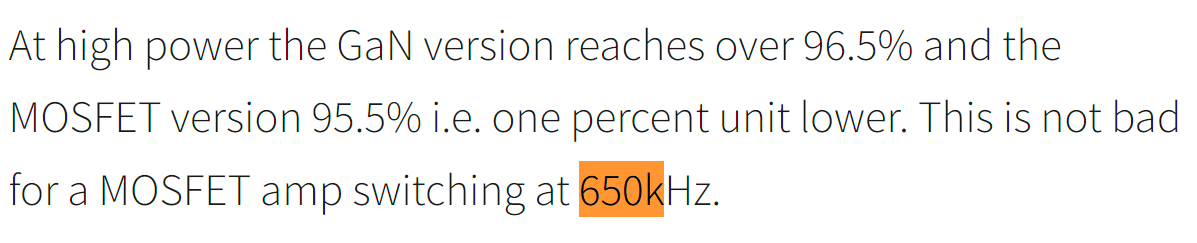

The following two screenshots are from Icepower's website, demonstrating the hard switching losses of a GaN FET operating at 650 kHz, which amount to 3.18 W.
Using this data, we can calculate the loss per kilohertz as follows:
Loss/kHz = 3.18W/650 = 0.0049/kHz
If the switching frequency increases to 3.2 MHz, the total loss can be estimated as:
Total Loss=0.0049/kHz*3200kHz = 15.66W

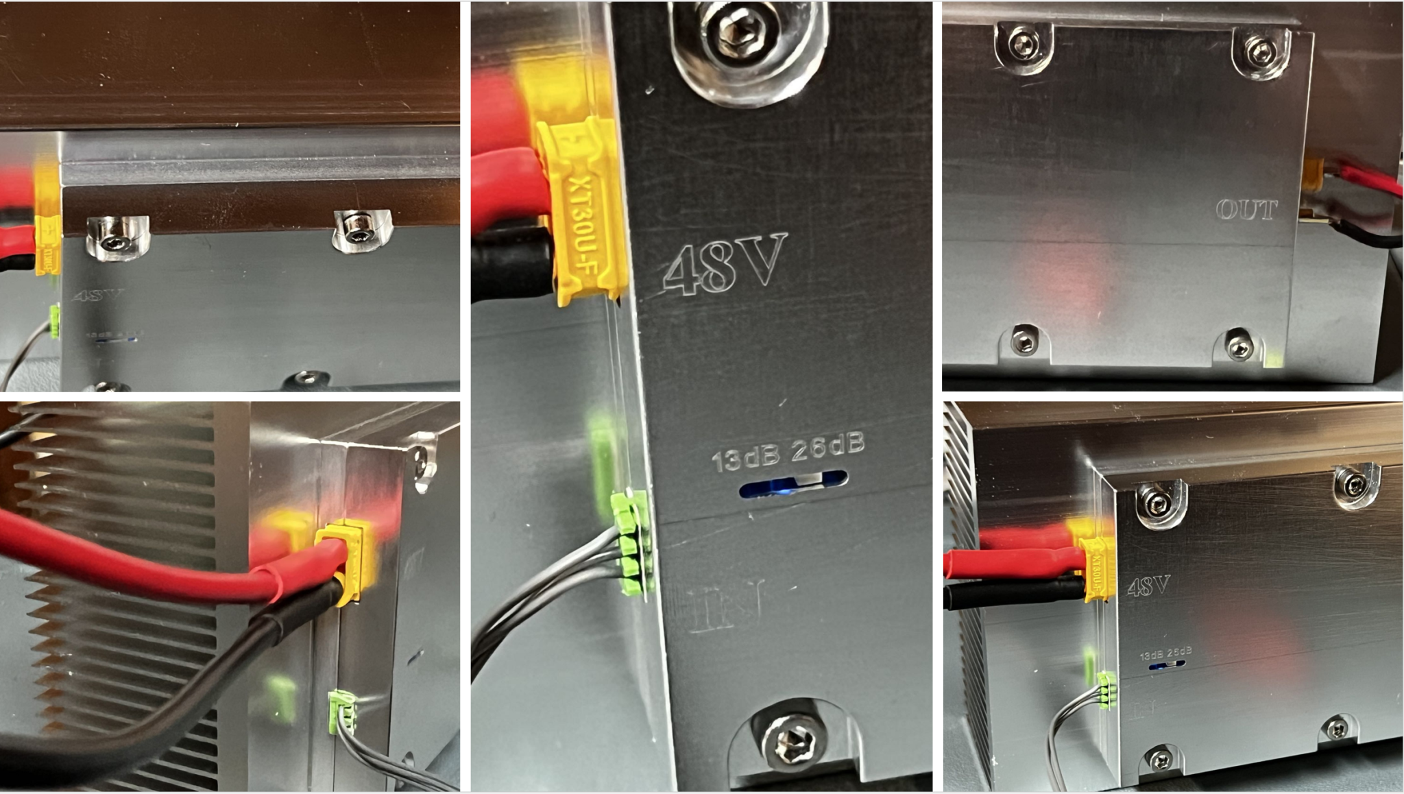

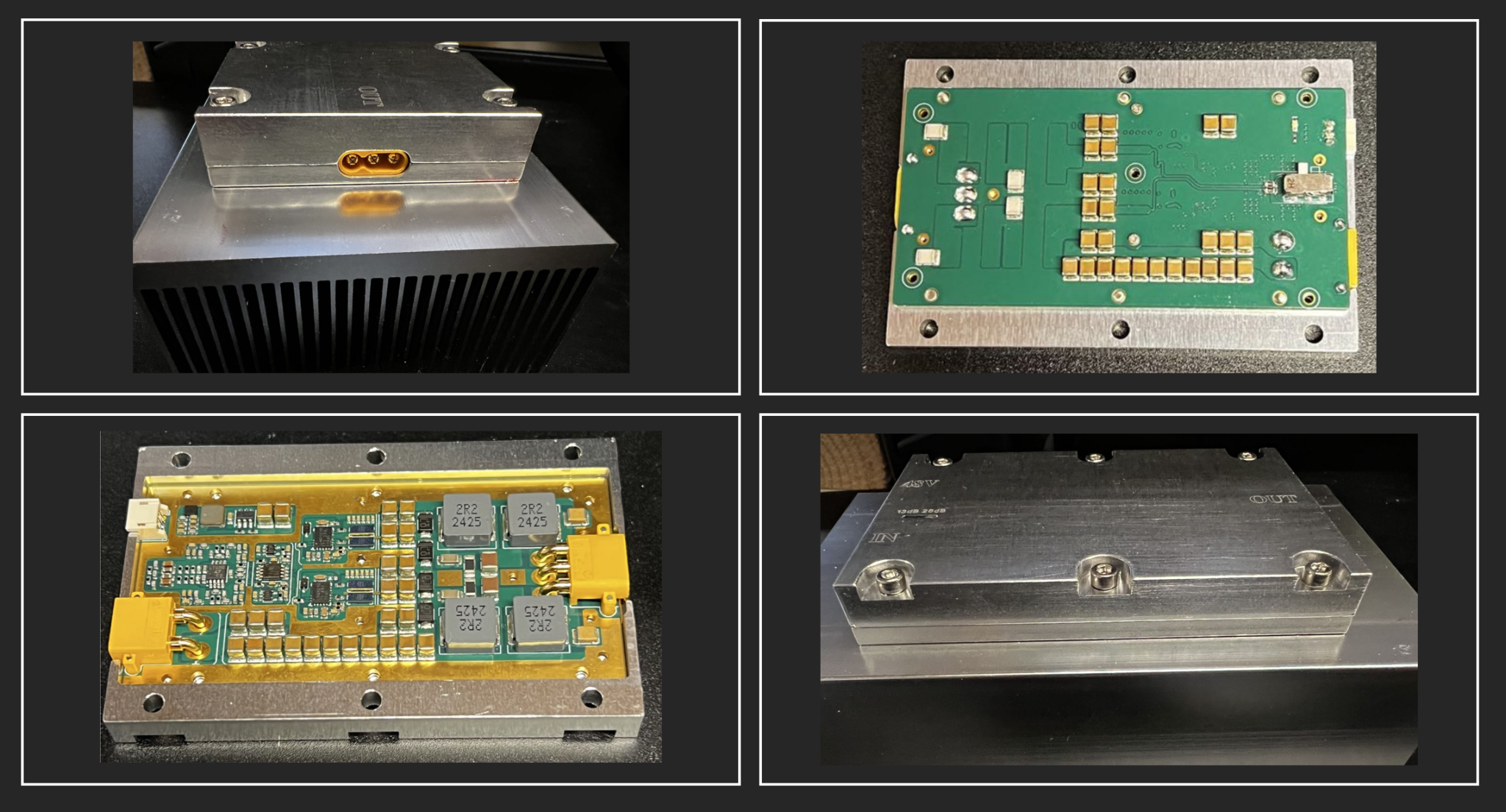

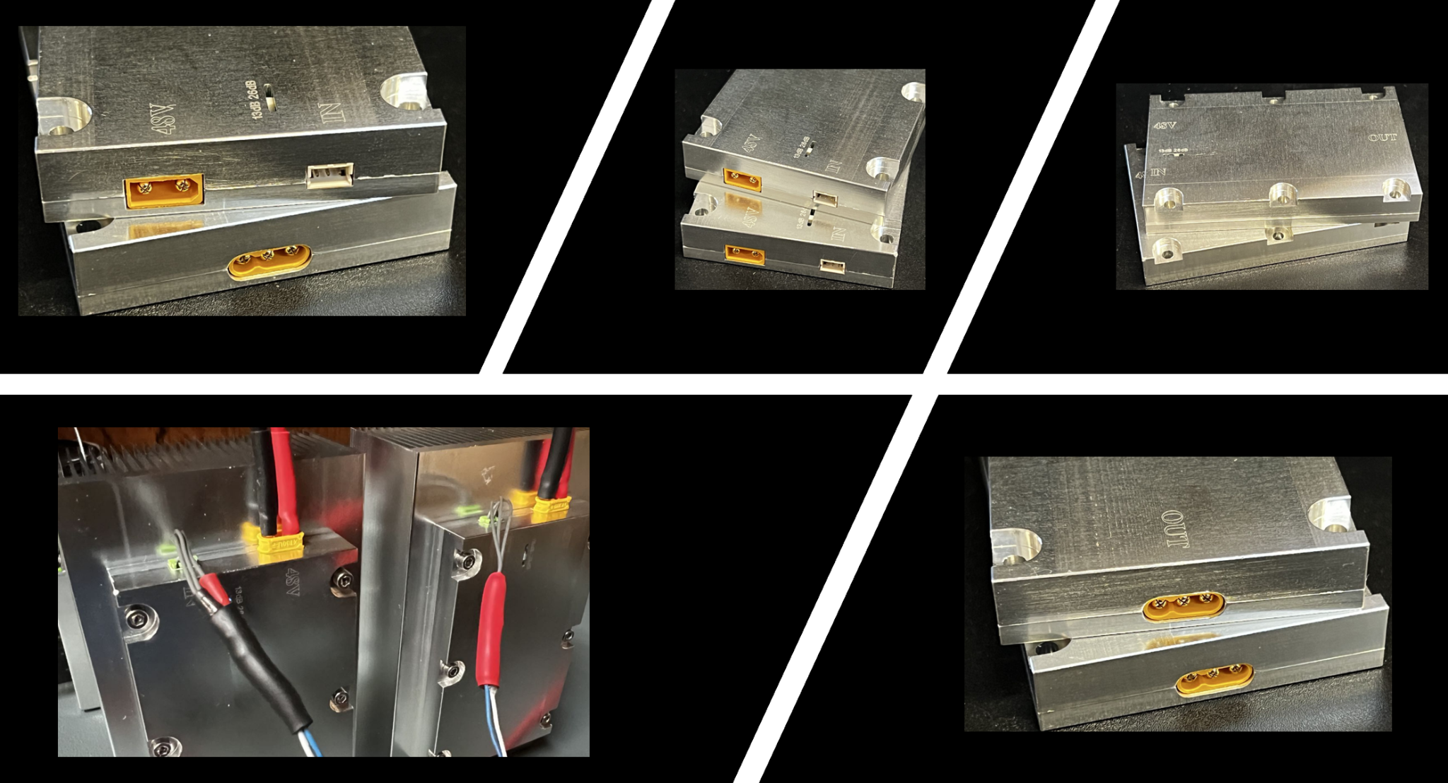

The housing arrived today. One module has been assembled, and everything fits well.
It can already drive a single speaker to enjoy music.
With my ear 'into' the speaker, I can’t hear any background noise.
The DC offset measures 2.8 mV.
Assembled three more modules today. Unfortunately, I burned one due to misusing the thermal pad. 😳
Eventually, I managed to drive a pair of speakers. 🙂
The sound is crystal clear with incredible detail.
The static power consumption of the combination of the LMG1210 and EPC2001C is approximately 5.5W/MHz with a 48V power rail. Different deadtime settings may result in varying values.

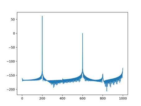

How High Should the Operating Frequency Be for a Class D Amplifier?
When considering the optimal operating frequency for a Class D amplifier, two contrasting ideas often emerge:

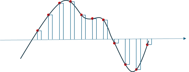

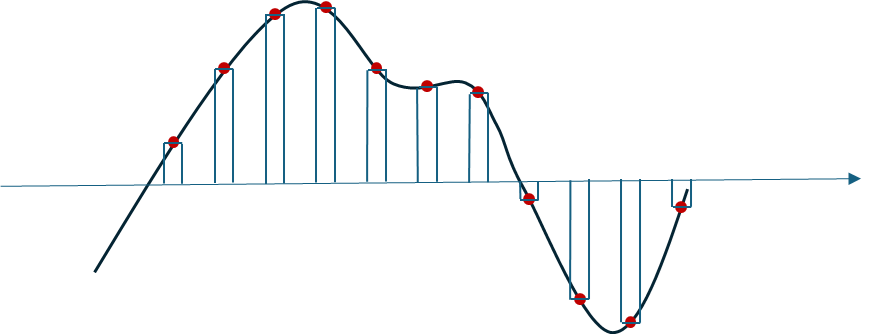

The diagram below illustrates the ideal sampling-and-hold process. In this scenario, the sampling time is effectively zero, after which the value is held constant for quantization. However, in practical circuits, achieving such an instantaneous sampling duration is impossible. Real-world implementations often require significantly longer time to sample the amplitude of the input signal, as depicted in Figure 2.
Figure 2, actual sampling scheme

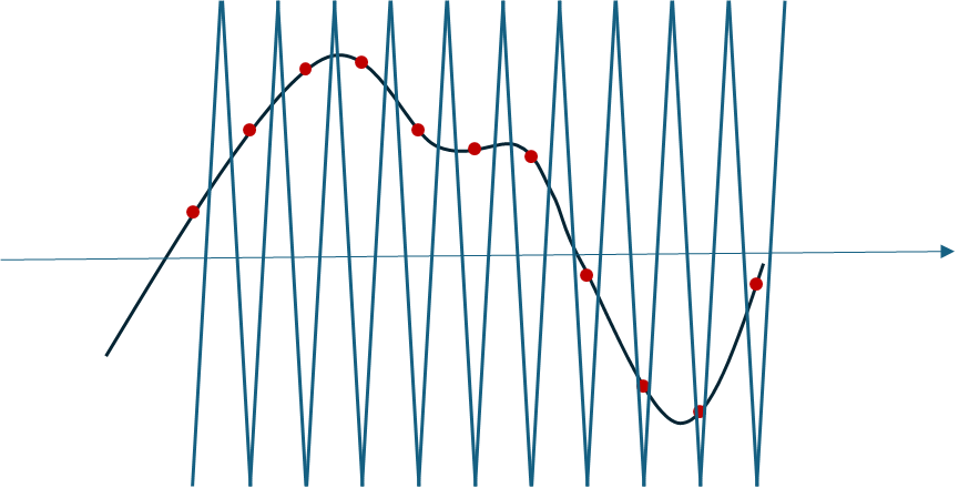

Class D operation essentially involves sampling the input signal first and then "quantizing" it by determining the duty cycle of the PWM signal. The sampling process is illustrated in Figure 3.
Figure 3, sampling scheme of fix frequency class D AMP

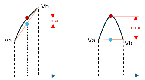

It’s easy to observe that the sampling duration in a Class D amplifier is longer than in a typical sampling-and-hold scheme. As shown in Figure 4, a longer sampling duration introduces significant errors, which lead to noticeable distortion. Furthermore, the positive half of the signal waveform is sampled for a different duration than the negative half. This discrepancy results in significant even-order distortion.
Figure 4, errors caused by the long duration of sampling

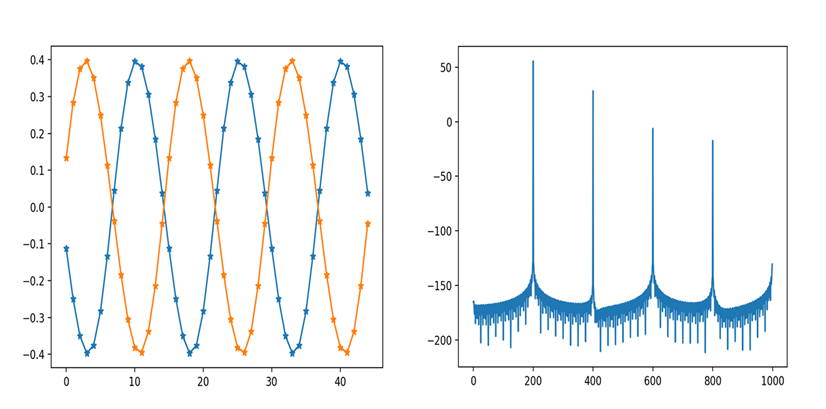

Simulating Class D amplifiers is quite challenging, as the timing of the intersection point between the signal and the triangle wave can occur at any moment. Simulation tools like LTspice use fixed time steps, making it impossible to precisely locate the crosspoint, which results in inaccurate simulation results.
To address this issue, we need to resolve each intersection point to determine the correct timing. I’ve developed a Python program to solve this problem. The program is shared at the end of this thread, so if you're interested, feel free to experiment with it.
Figure 5 below shows the discretely constructed signal, where the triangle wave frequency is 15 times that of the sine wave. Figure 6 demonstrates that the full-bridge output stage can effectively cancel out the even order of harmonics. In contrast, Figure 7 shows that there is no distortion in the reconstructed signal when using traditional ideal sampling.
Figure 5, Constructed discrete sine wave of PWM modulation and its spectrum
Figure 6, Spectrum of the full bridge output of PWM modulation
Figure 7, Constructed discrete sine wave of ideal sampling and its spectrum

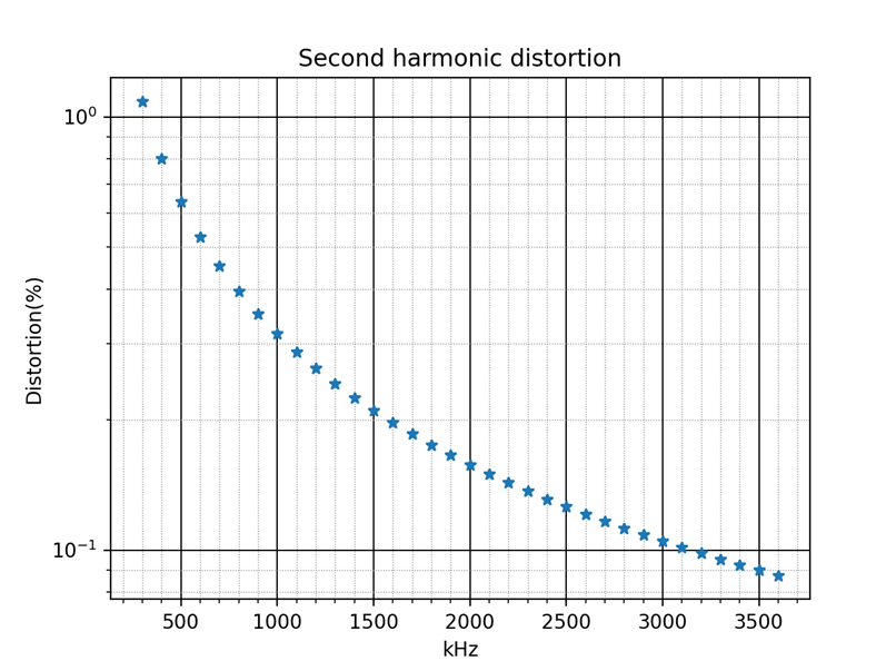

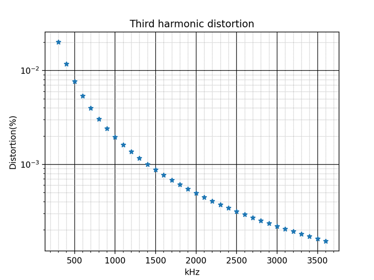

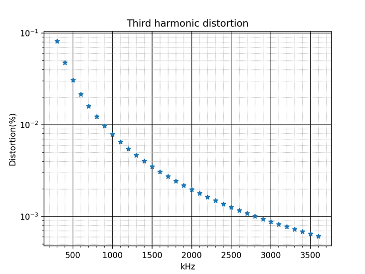

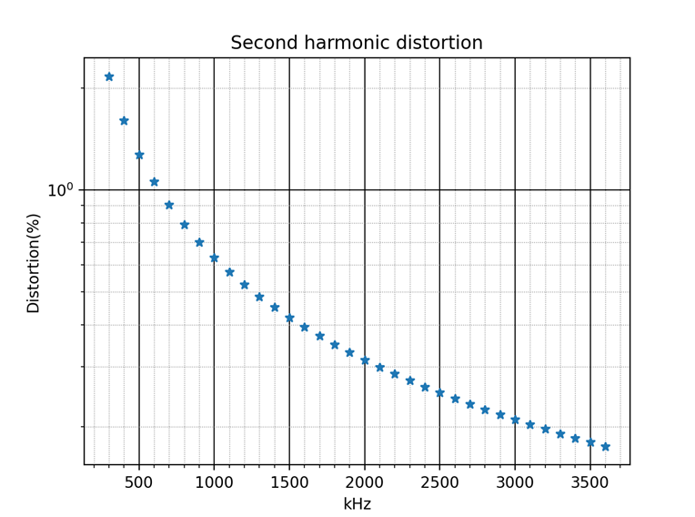

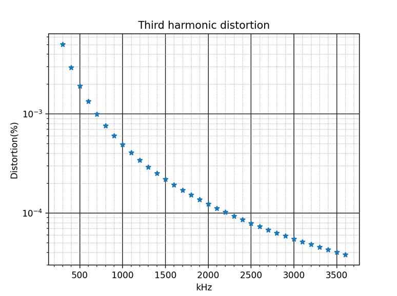

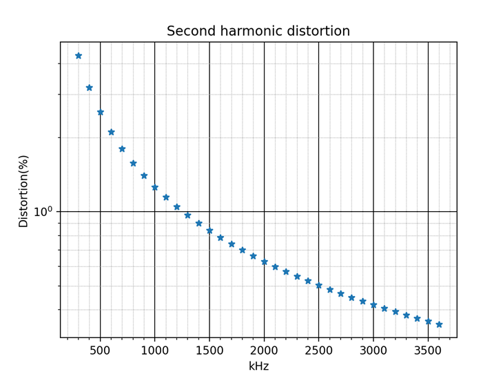

The following figures illustrate the second and third harmonic distortions of a 20kHz signal versus modulation frequency. Several conclusions can be drawn from the data:
Your suggestions and feedback are greatly appreciated. It’s possible that there are currently unknown issues with the simulation that could lead to inaccurate results. Therefore, I kindly advise you to interpret the simulation results with caution.
Figure 8, Second harmonic distortion with 0.2 modulation depth
Figure 9, Third harmonic distortion with 0.2 modulation depth
Figure 10, Second harmonic distortion with 0.4 modulation depth
Figure 11, Third harmonic distortion with 0.4 modulation depth
Figure 12, Second harmonic distortion with 0.8 modulation depth
Figure 13, Third harmonic distortion with 0.8 modulation depth
- According to Nyquist's theorem, 40 kHz should suffice.
- Based on DSD64 signals, 2.8 MHz appears to be adequate.
Figure 1, ideal sampling scheme
- Second harmonic distortion is significant.
- Higher modulation frequency results in lower distortion.
- Lower modulation depth leads to lower distortion.
- A full-bridge output stage is essential.
- As shown in Figure 13, a modulation frequency of 3 MHz can achieve a third harmonic total harmonic distortion (THD) of 0.001% with a modulation depth of 0.8.
- If possible, use a smaller modulation depth. For example, the first headphone amplifier project employs a very low modulation depth with a power supply in the range of 9–12V.

PLT_PWM = True
if PLT_PWM:
plt.plot(duty_cycle[0:3 * N], '-*')
plt.plot(duty_cycle_n[0:3 * N], '-*')
else:
plt.plot(-1*result_sampl[1:2*M*N:2][0:3 * N], '-*')
plt.show()
FULL_BRIDGE = True
if FULL_BRIDGE == True:
pwm_out = duty_cycle - duty_cycle_n
else:
org_sap = -1 * result_sampl[1:2 * M * N:2]
pwm_out_freq = abs(fft(pwm_out))
print("the ratio is in dB:", 20 * np.log10(pwm_out_freq[200] / pwm_out_freq[400]),
20 * np.log10(pwm_out_freq[200] / pwm_out_freq[600]), 20 * np.log10(pwm_out_freq[200] / pwm_out_freq[800]),
20 * np.log10(pwm_out_freq[200] / pwm_out_freq[1000]))
print("")
if PLT_PWM:
plt.plot(20 * np.log10(pwm_out_freq)[0:1000])
else:
plt.plot(20*np.log10(abs(fft(org_sap)[0:1000])))
plt.show()
