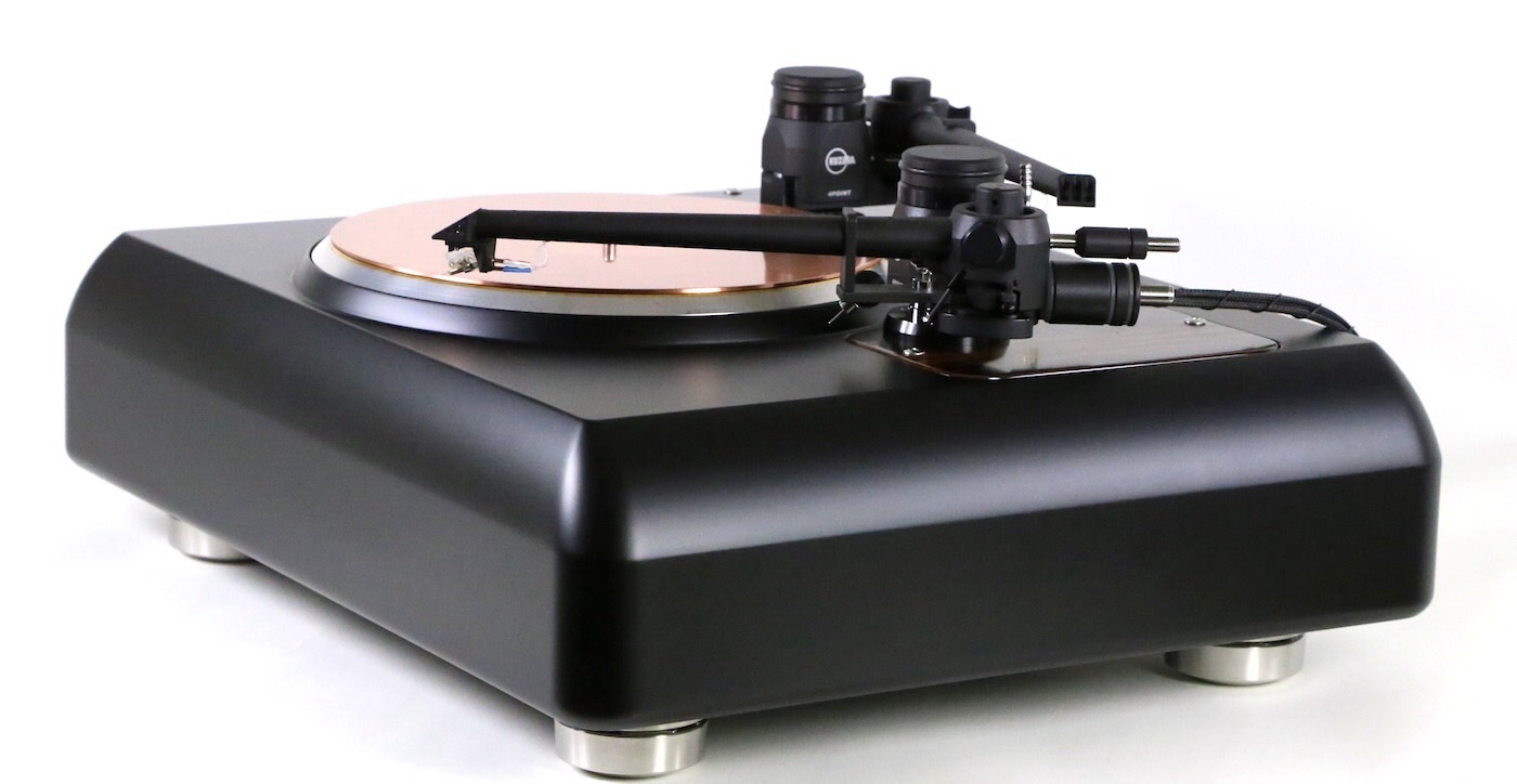

My HIFI friend here is just finishing up a 2 year build on his. Mk3 I believe. Many $10k's spent so far. Every imaginable modification and no expense spared. Plinth CNC'd from solid block of aluminum (+200 lbs), panzerholz, and Alsa Corp matte black finish. Not to mention the arms, carts, power supply, etc.
I don't plan anything this extreme, but fun to drool!
Great luck on your build!
How i love to see a no compromise diy work!

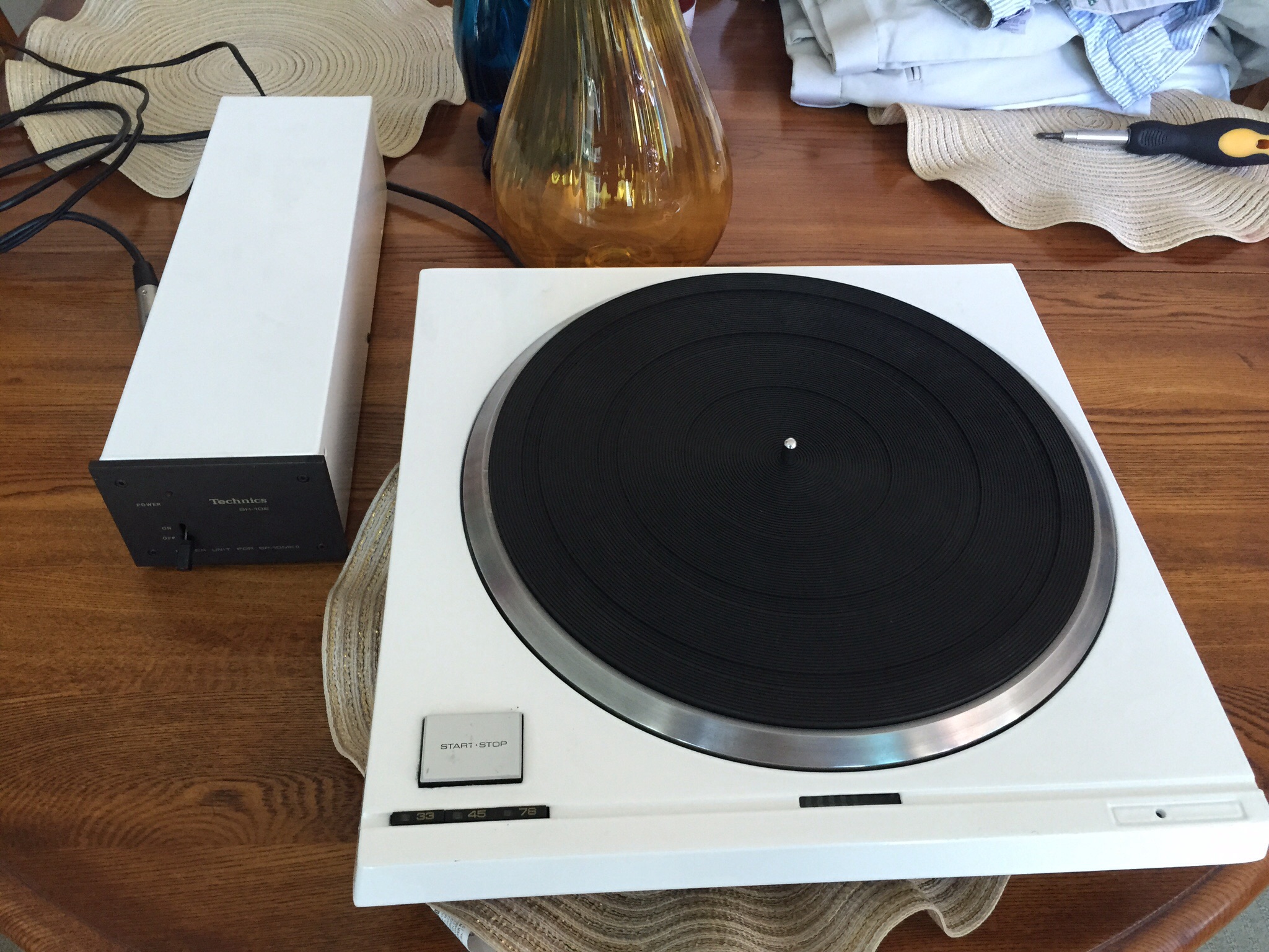

6l6, my HIFI friend gave me a SP-10 MK2 and power supply yesterday. So I'm even more interested in what you have done so far.
I guess I should start my own build thread, but can you give me some advice on what caps you changed and how you determined what to buy?
I also read about cutting some of the traces and adding regulators? Any advice?
The chassis and the power supply on the one I received was poorly painted white, but everything runs correctly and the platter is clean. I plan on building a completely new plinth, CNC aluminum block, just not as massive as my friends and only one tonearm.
Time for a refinish, methinks.
Wonderful! Take tons of photos, take notes, and post everything here.

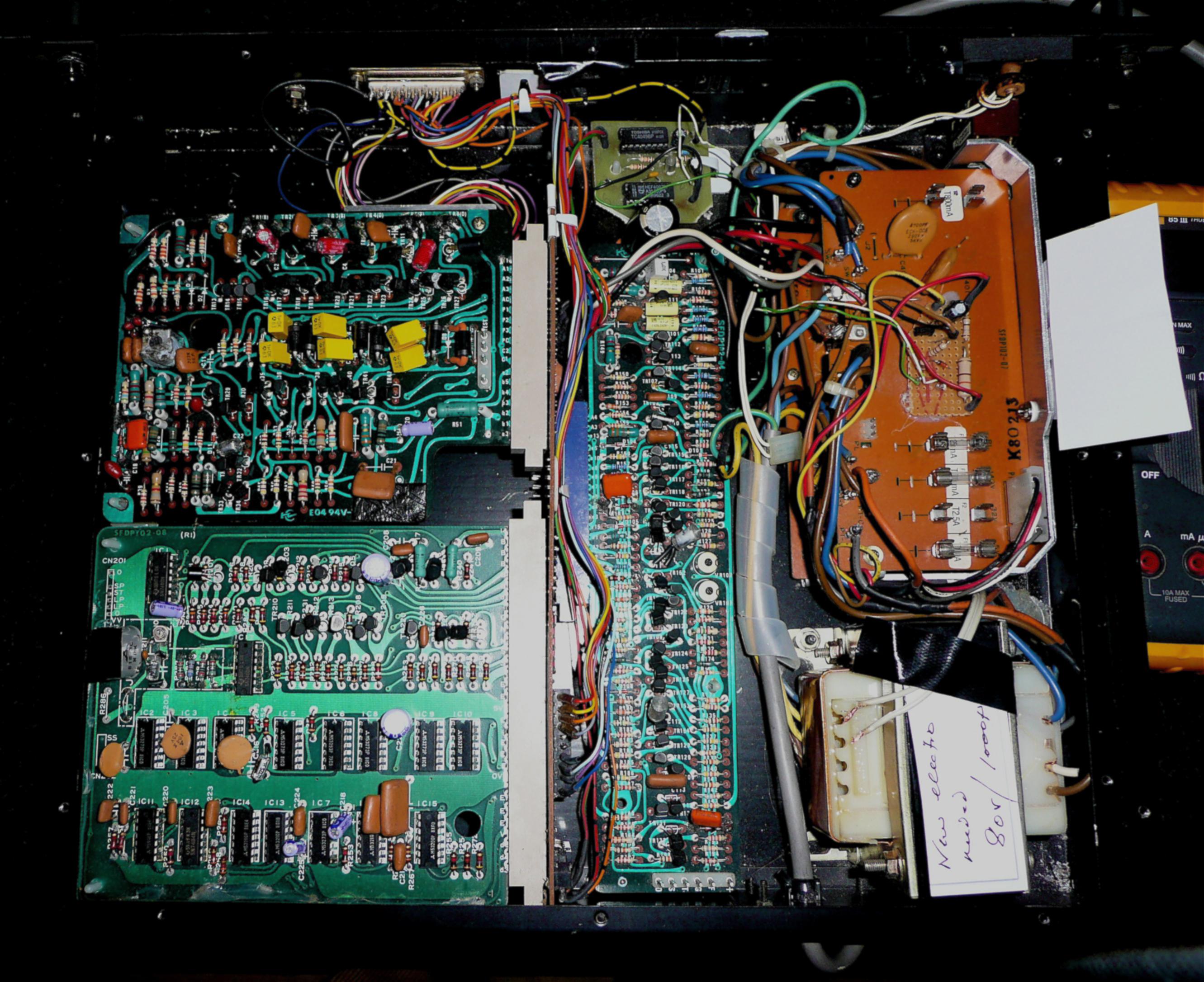

Having SP10 mkII with all electronics moved outboard and connected via a loom lead, I can say with total confidence that the subjective experience is enormously improved. This mod I believe to be mandatory and a first to accomplish before getting worried about anything else (provided that the unit is basically up to spec).
I attach a poor picture of the now outboard power supply. I sent the whole unit to an expert who is finding difficulty in being able to return it to me so (UK readers will know what I mean!), I cannot supply pics of the latest set up - it is intended to ditch the top-plate in its entirety and to mount the motor and platter only in a purpose built plinth.
Building a new plinth, only carrying over the motor and platter, and moving all the electronics into a new chassis is also my goal.Having SP10 mkII with all electronics moved outboard and connected via a loom lead, I can say with total confidence that the subjective experience is enormously improved. This mod I believe to be mandatory and a first to accomplish before getting worried about anything else (provided that the unit is basically up to spec).
Very interested in any information and photos you can provide. I can only assume increasing the length of the interconnecting wire loom requires some modifications to the electronics? Or is there enough adjustment built in to compensate?
