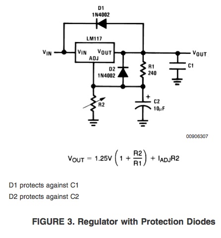

I am obviously falling into the trap of the 317 being so ubiquitous and a genuinely fantastic performer that it's being taken for granted, and I'm trying to fix a problem that isn't there.
Big bypass caps across the set resistor and the output, with protection diodes. Check.
I would just use the National Semiconductor test circuit. Nothing more, nothing less. But it really isn't that critical.

Page 9 Figure 3 is what I meant.
Also page 15 bottom right might be better is using an external reference? But I would put in the diodes and reference decoupling capacitor.

That was also my suggestion, and exactly what I did with my SP-10 suply- the caps can be quite a bit larger (100-220uF) which further reduces noise and impedance.
Thanks, yes input and output caps definitely. But not the 10uF C2, increasing that will damage the dynamics.
Huh, my dynamics seem to be intact. 😀
See the definitive Erroll Dietz paper- note particularly Figure 4 and what happens to the output impedance below 100 Hz when that adjust cap is oversized (his data show 10uF vs 1000uF).
It was in EDN (a paper publication). Reprinted as Appendix C in Bob Pease's "Troubleshooting Analog Circuits."
Dave, I believe this is the Dietz article SY is referencing. - http://electrooptical.net/www/sed/ErrolDietzRegulatorNoisePeaks.pdf
And this is the circuit you are suggesting -
That's what I'm thinking, with 220uF on the output.
The version in the Pease book is more complete, but the critical graph in this version is Figure 2. Look at the output impedance difference with a big cap on the adjust pin.
220u caps are small and cheap.
This does appear to be correct. I'm sure when I measured start up, that a 10uF gave a faster response as the load changed a lot and quickly. I may have to repeat that and thanks to SY for highlighting this.
No prob- many people don't realize how good those regulators can be if used properly (I sure didn't before reading Dietz!). The other interesting thing is performance changes with current draw; higher current out is a beneficial thing.
Isn't there some trick where you make R1 (Adj-Out) a different value than the suggested 240ohm for more current to be drawn? 150R or something thereabouts? The regulator need only supply 250mA...
I use 120R just because some lots of 317s didn't regulate without 10mA minimum draw. The no-load current draw is 1.25V/R1.
