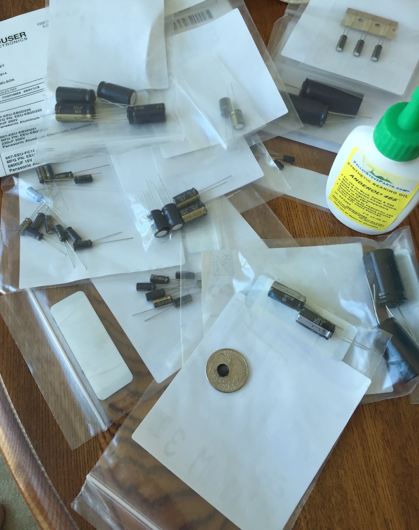

Anyway, you may get it back once you re-cap the PSU and table, you may have something in the circuit that isn't working properly as opposed to a bad neon.
You need a good 140V. If the neon has blown you can use one from what we know here as a "cooker switch" it may be small but it will work.
Or take the 140V off the strobe transistors, feed 5V and drive a LED(s) from that.

PSU - just do a recap of the stock supply and see if everything works well. If so, don't worry about something different - I bought 2 decks with no PSU, hence why needing to build my own. If they came with stock PSU, that's what I'd use.
