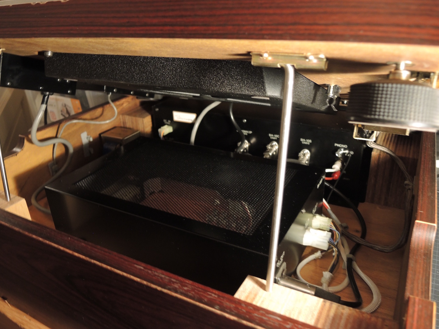

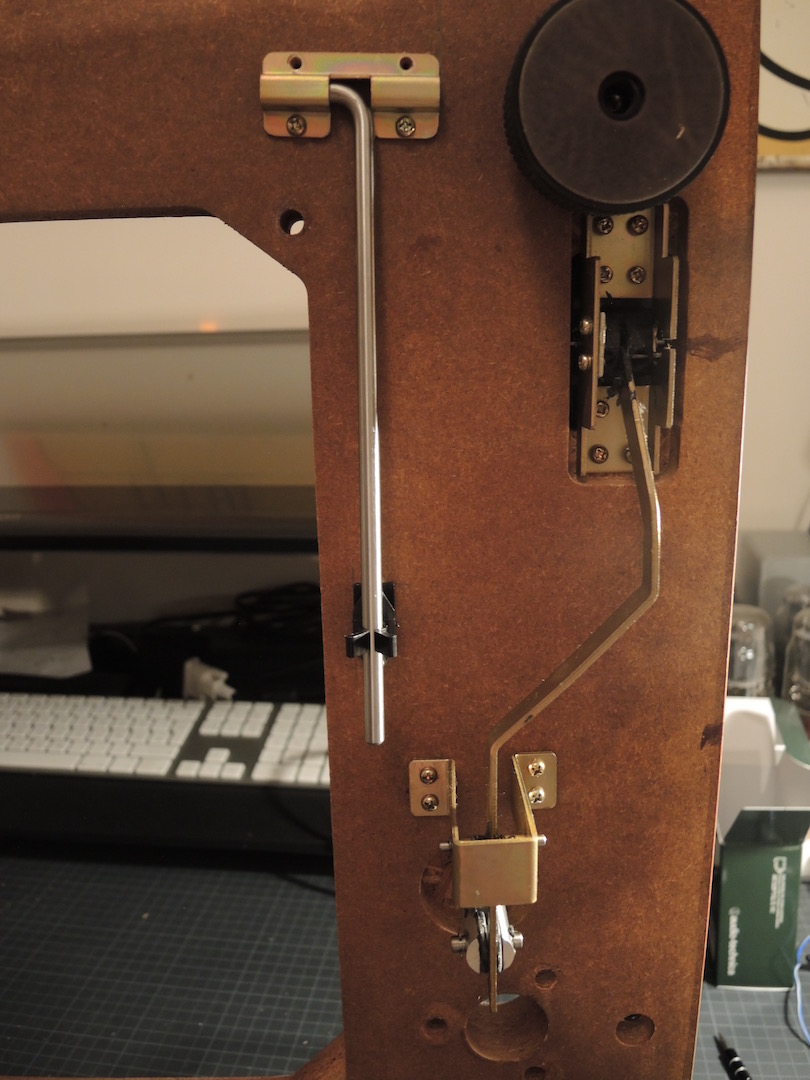

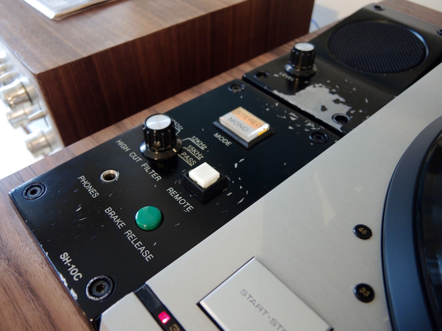

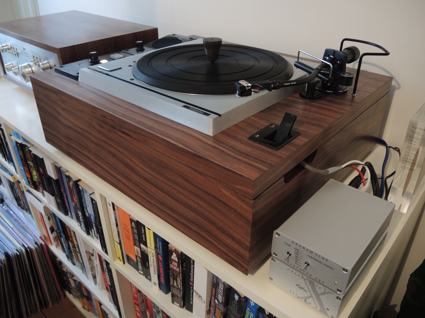

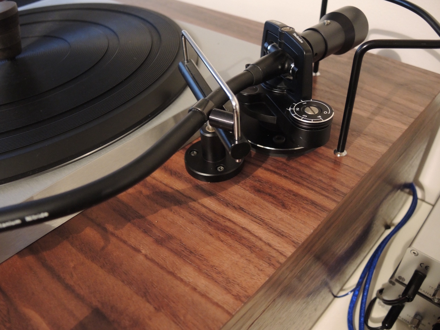

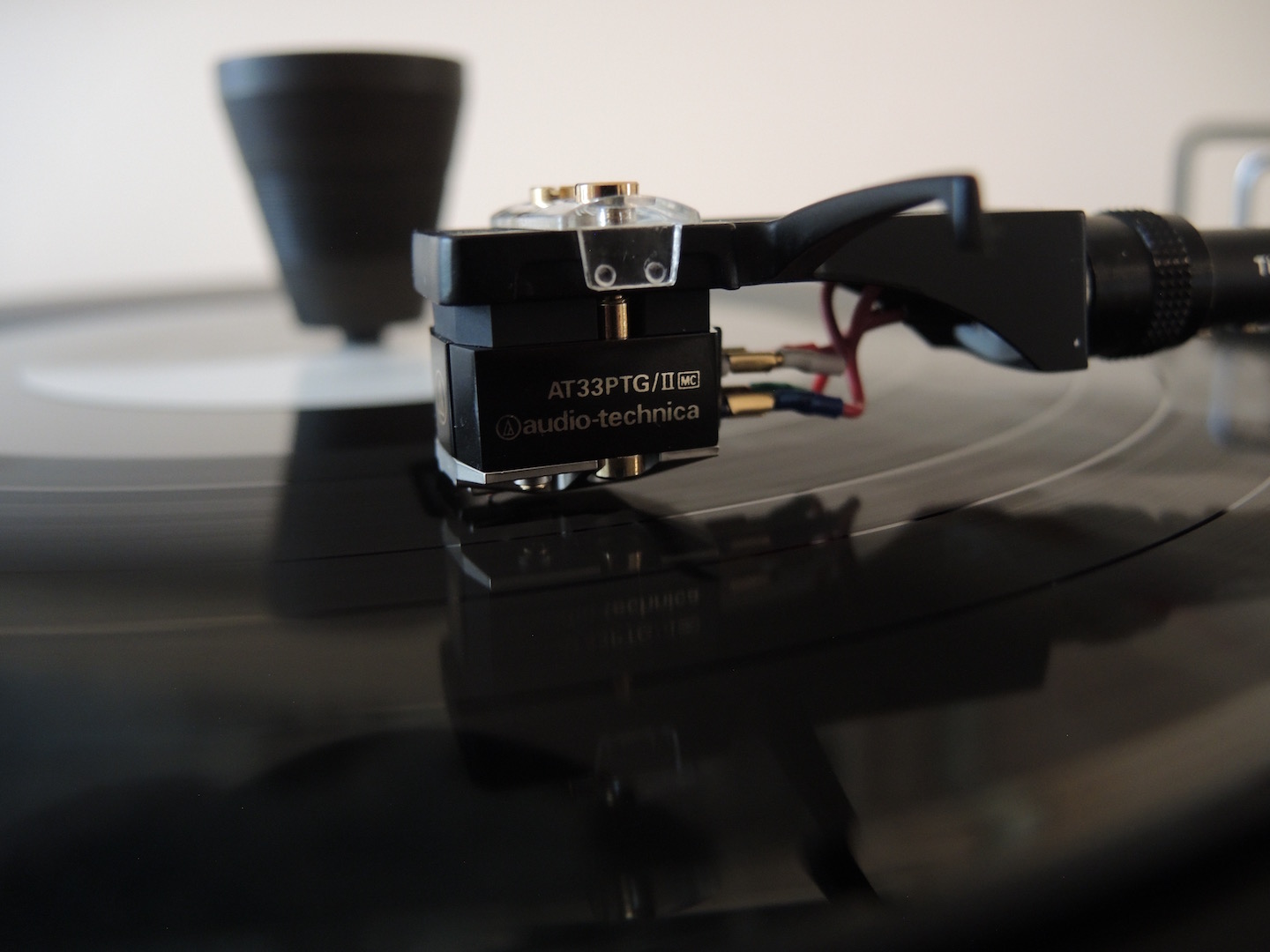

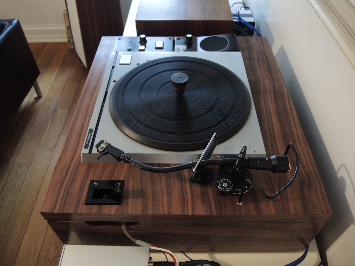

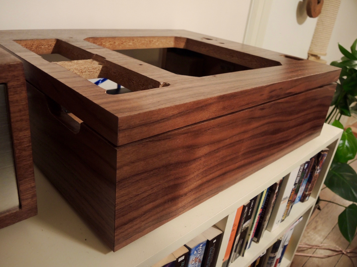

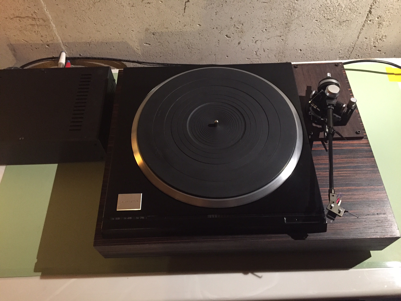

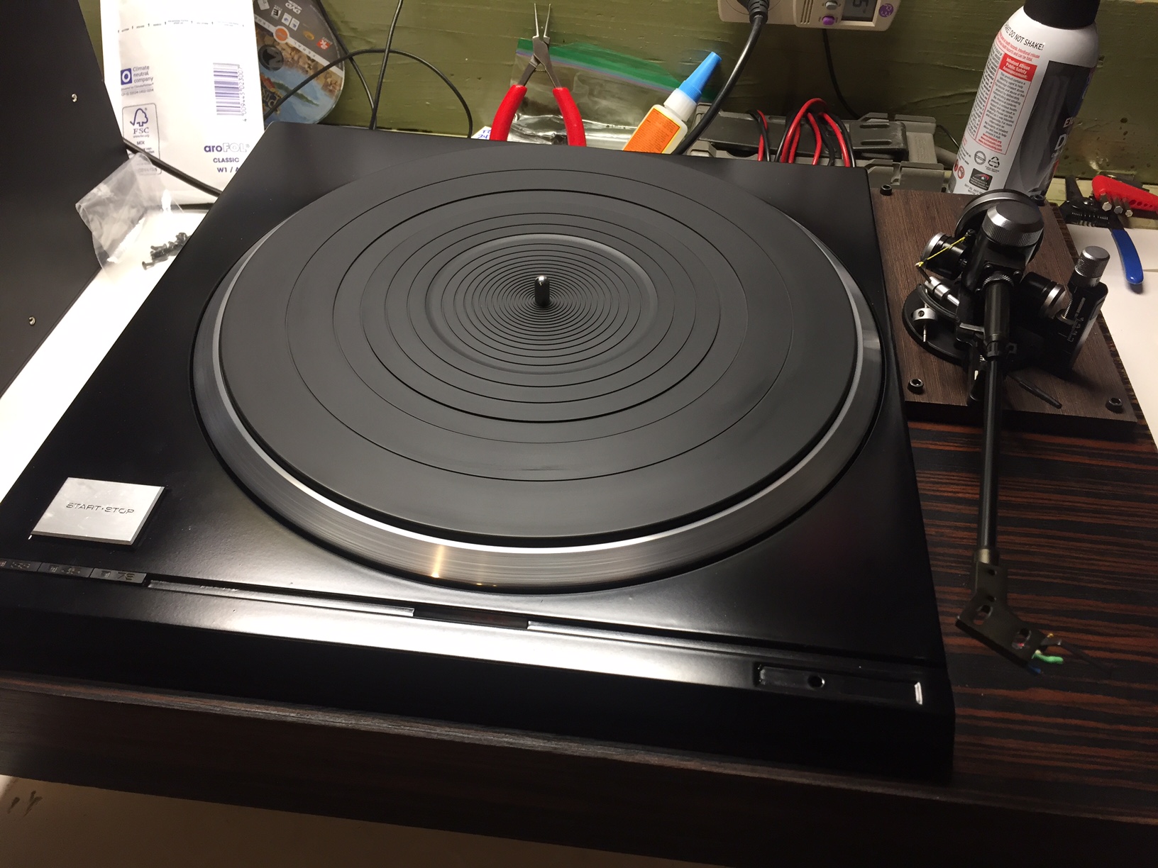

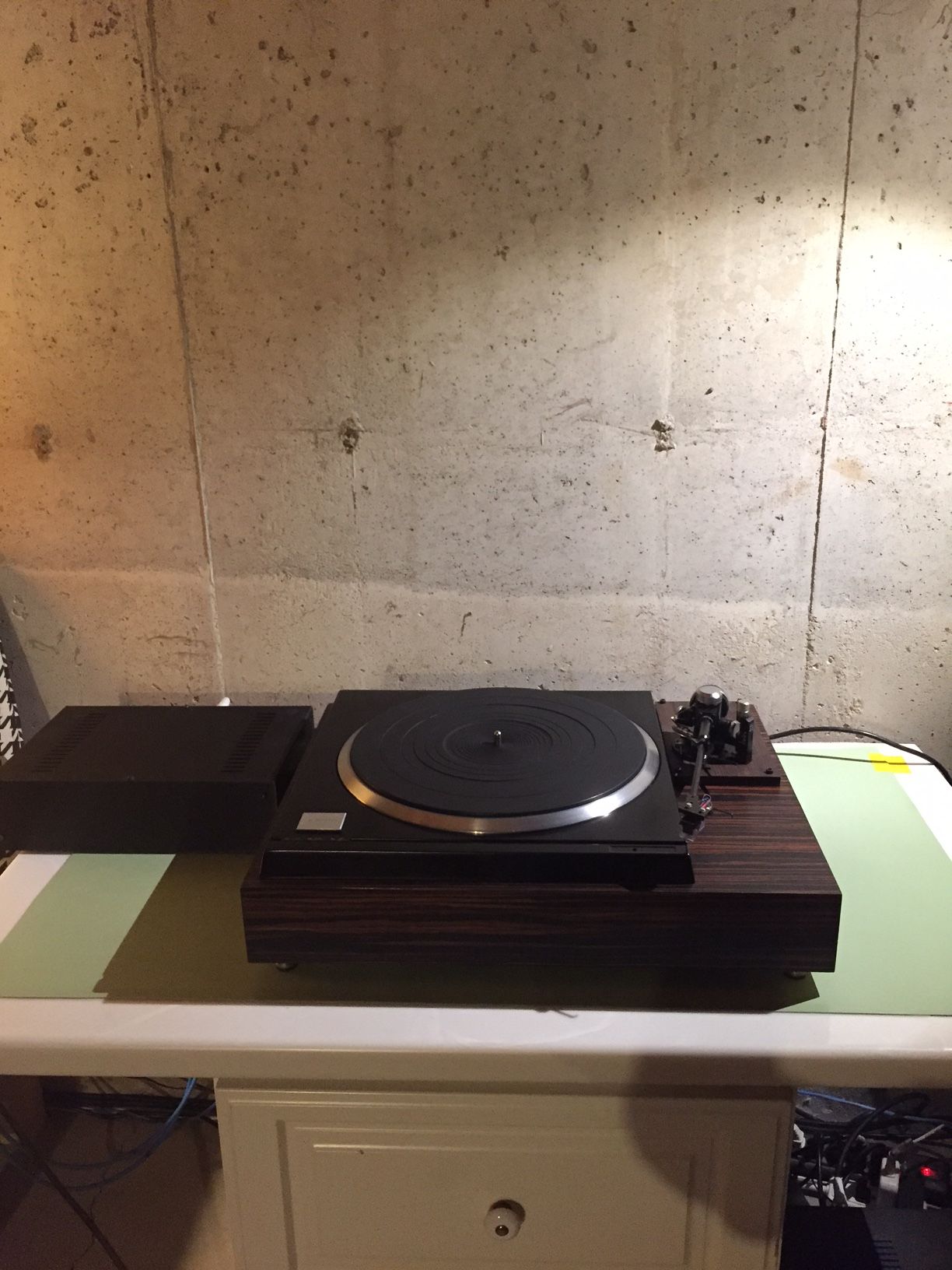

i recently acquired an old Swedish Radio SP10mk2p deck (there were a handfull up for sale here in norway recently) and decided to keep the stock plinth, as i like the look and history.

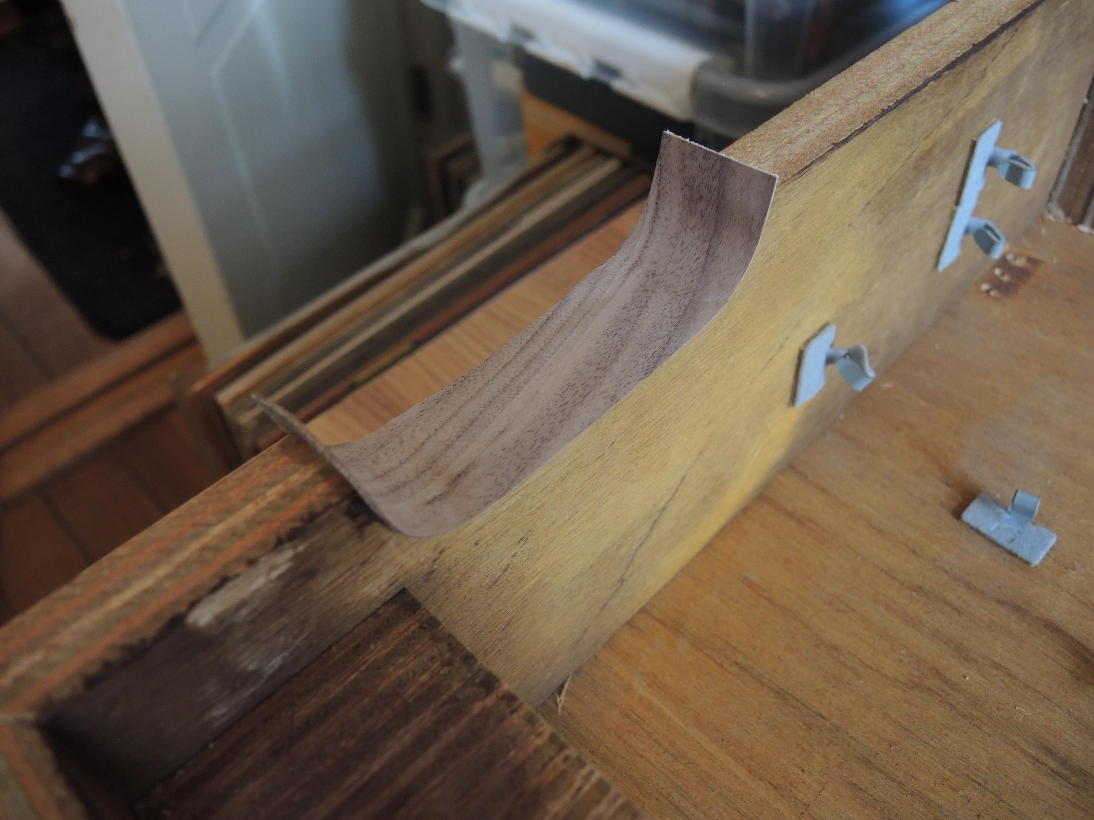

unfortunately, the vinyl "rosewood" veneer was in a sorry state after years of studio use, so i decided to re-veneer it.
lots of nice info in here, and it's good to see that i can purchase new thrust pads and silicone nitride bearings when the worry of excessive wear to my old ball keeps me awake at night 😉
I'm quite happy with the final result, and i think it sounds great as well!
(though i am currently not using the built in RIIA)
WOW!!!!!
That's incredible, I love it!
Thank you for sharing. 😀 😀 😀 The photos are great, if you have any more, please post them.
WOW!!!!!

i really like the purposeful look of this turntable, and it was a lot of fun pulling it apart and putting it back together.
veneering is both scary and fun, as one mistake can ruin everything, and you always find new challenges along the way 😱
luckily i didn't screw up anything big this time 😉
here are some more photos:

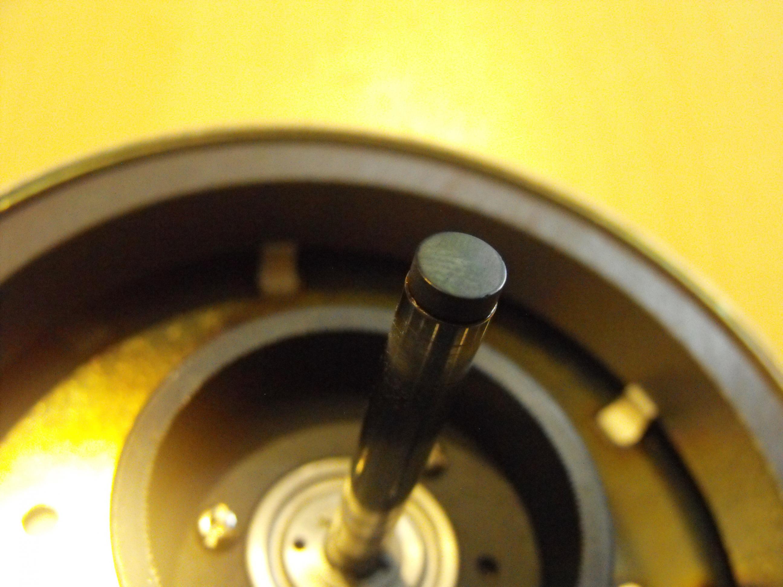

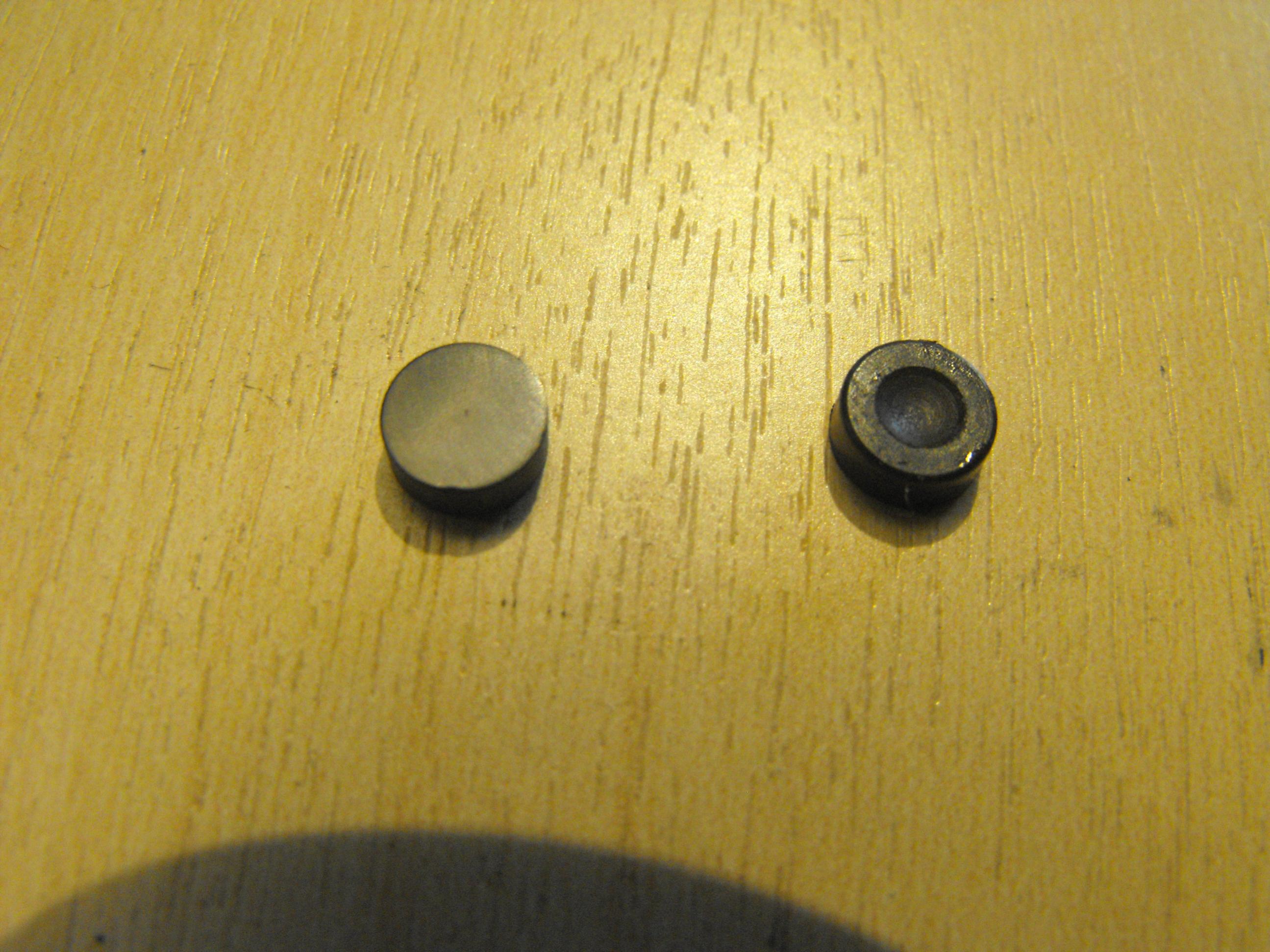

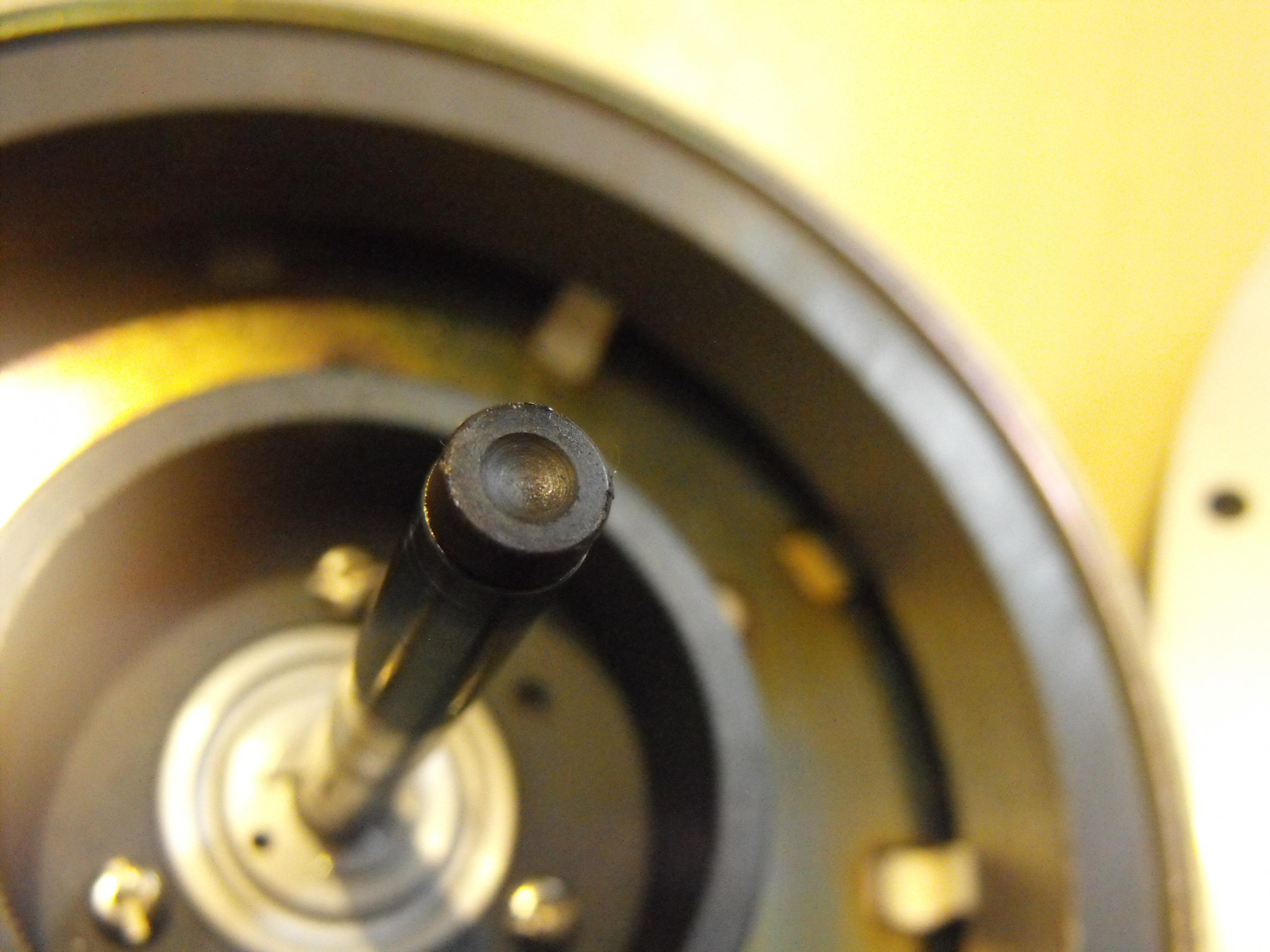

Here are before and after pictures of the thrust bearing for one of my SP10's. The images says it all. The motor date is 1978.I have lost the plot here ! Is he selling them ?
Dave
Nice job Bon.
I was the maker of these Torlon thrust caps. I have been working with Torlon as a bearing liner material and thrust pad material for the past couple of years, and am pleased with it as a bearing material. I make a bearing for the Garrard 301/ 401 with it, and also re-bush TD124 bearings with Torlon. I knew from experience that it would be a superior material than the stock SP10 MK2 thrust pad material, so I had some made up. When they arrived from my machinist I decided to look to see if anyone else (User 510) was selling replacement thrust caps for the SP10 MK2, and sure enough... and also from Torlon. I did not intend on copying someone elses work, but it seems that we have both come to a similar conclusion, that Torlon is a good material for this application. I only learned of his caps after I finished mine.
The best material for a thrust ball against Torlon, is sapphire. Sapphire is extremely hard, (9 on the MOH's scale) but can be damaged by impact.
