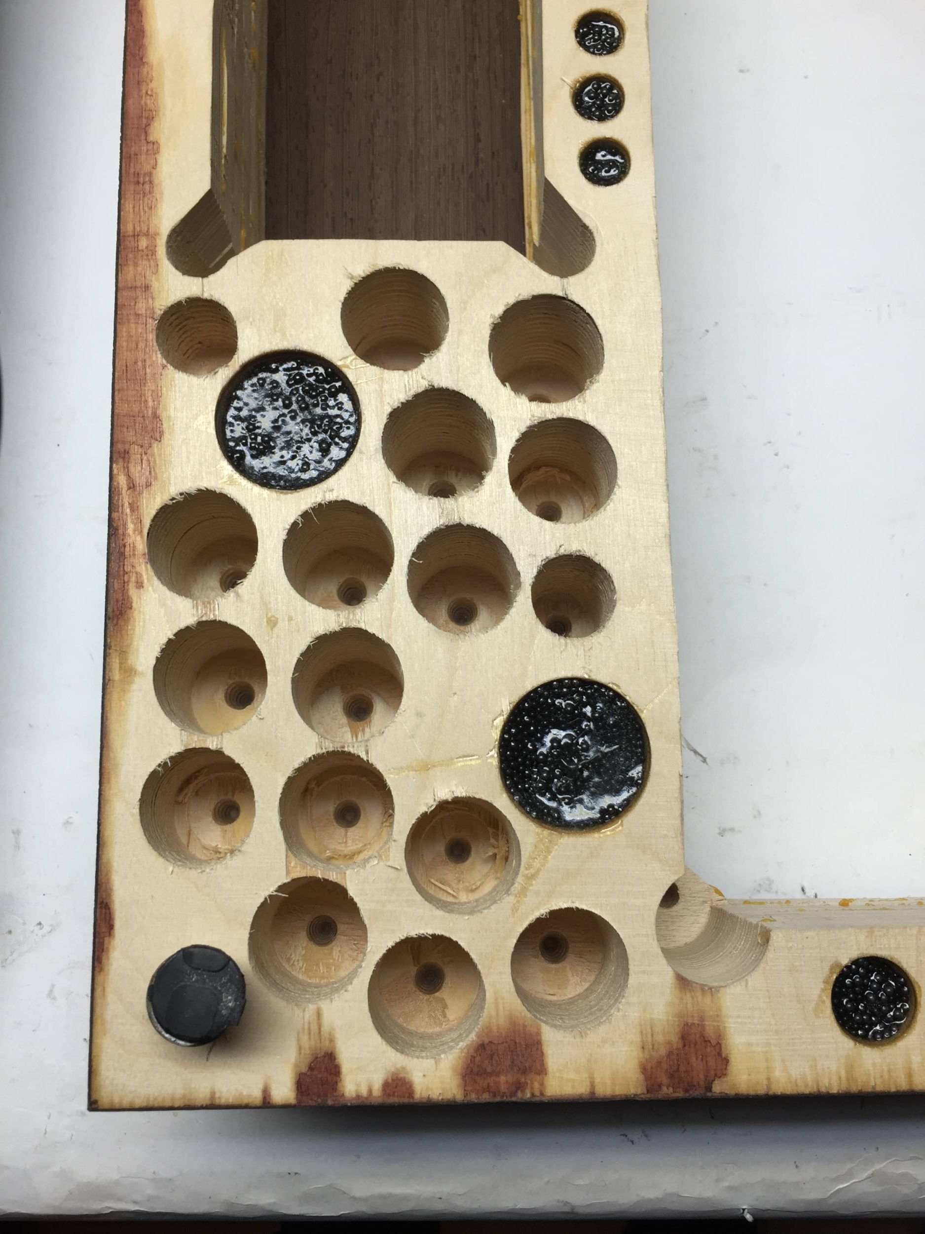

I've been in the middle of a major house renovation that is finally complete, so the next order of business is to organize the various projects, the one I'm most interested in is the SP-10 that's been lying around collecting dust for the last 18mo or so...
Ok, I've got most of the important parts -
After talking to a few people who've been down this road, I realize I need to just plain make the plinth heavier. So, the big drill bit comes out and Swiss cheese ensues. :)
"Each tuned to a different frequency. "
(One of my favorite audio marketing BS phrases...) Anyway, the green epoxy is a 3M product that never dries totally solid. The rest is just cheap 5-min.
Mass has been increased by at least 2kg. Maybe a bit more.
Next, aligning the motor drive.
