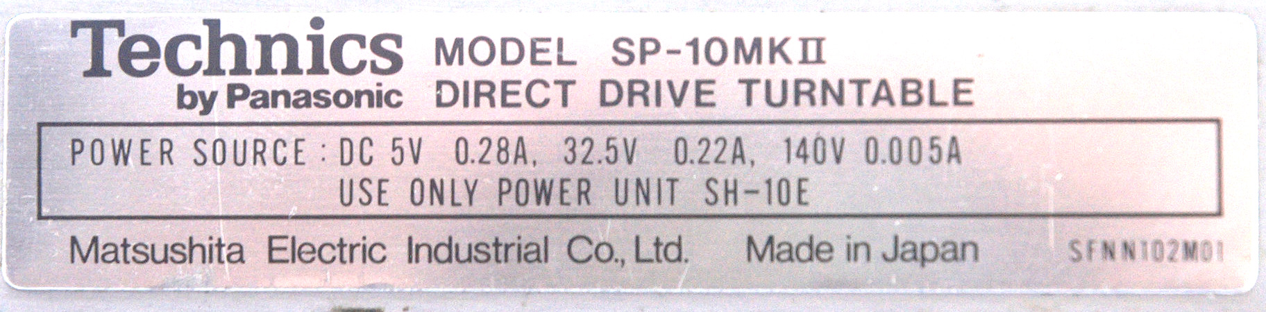

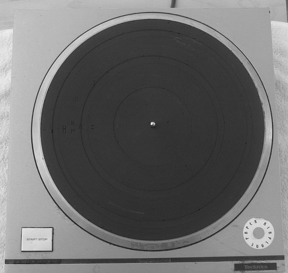

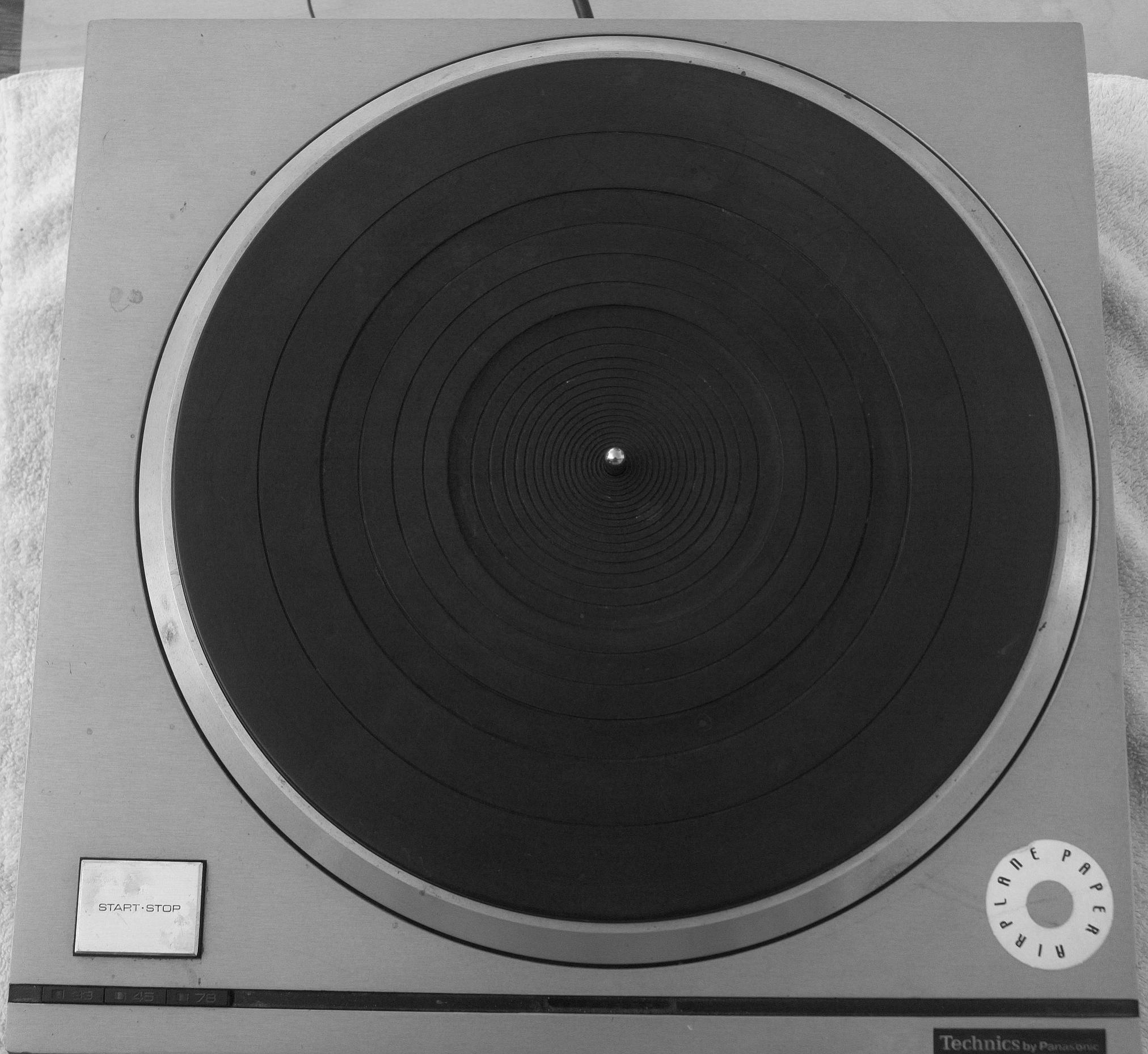

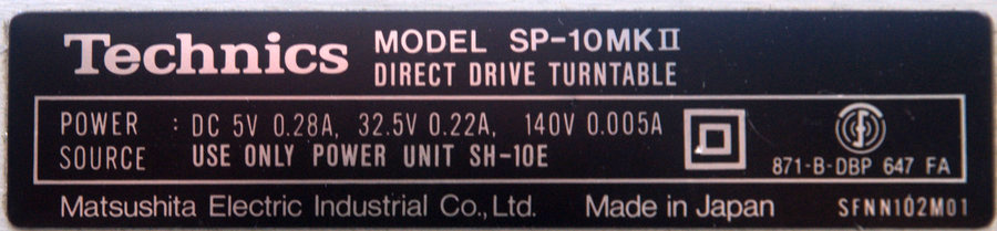

Last weekend I bought two SP10 MkIIs from an old radio station stash when I went there to pick up a Gates TT that I had bought on Ebay. The SP10s don't have power supplies, and I spent slightly more than I was comfortable with to roll the dice. If I get one good one I'll be very happy. Two would be major good luck.
They will hereby be known as Thing 1 and Thing 2. Pix below.
I have some questions of course.
1) Any thoughts regarding how to find a known working PS to see if I have a spinning turntable. I have looked at making supplies and am comfortable putting one or two together, but I'd sure like to know sooner rather than later if that's a fool's errand. I own the Fool label already. I live about 80 miles south of San Francisco CA.
2) Does anyone know what the PS connector is so I can order the PS box end that will mate with the cables from the TTs? I have the PS schematic that shows the pinout, but I am not sure about the convention that would tell me which side of which connector (male or female) that diagram indicates.
3) Does the black chassis tag versus the bright tag mean anything?
4) One table has platter to hub screws, the other does not. The ones that are present do not have shoulders as I have seen on posts. Can these be sourced, or should I make something up?
5) Not a question, but they didn't have the transportation motor fixing plates, so I will be making those from the template.
Thanks for your help -- Here's hoping.
Skip
Thing 1 tag and top photo on left; Thing 2 on right:
Thanks Bon and Dave!
I thought it looked like XLR but wanted to be sure. Don't want 140 VDC on the 5 VDC pin into the TT. I sure would like to borrow a PS for the first trial, and I'm more than willing to drive several hours with the 'Things' to test them at the PS owner's location. Hope that opportunity arises.
