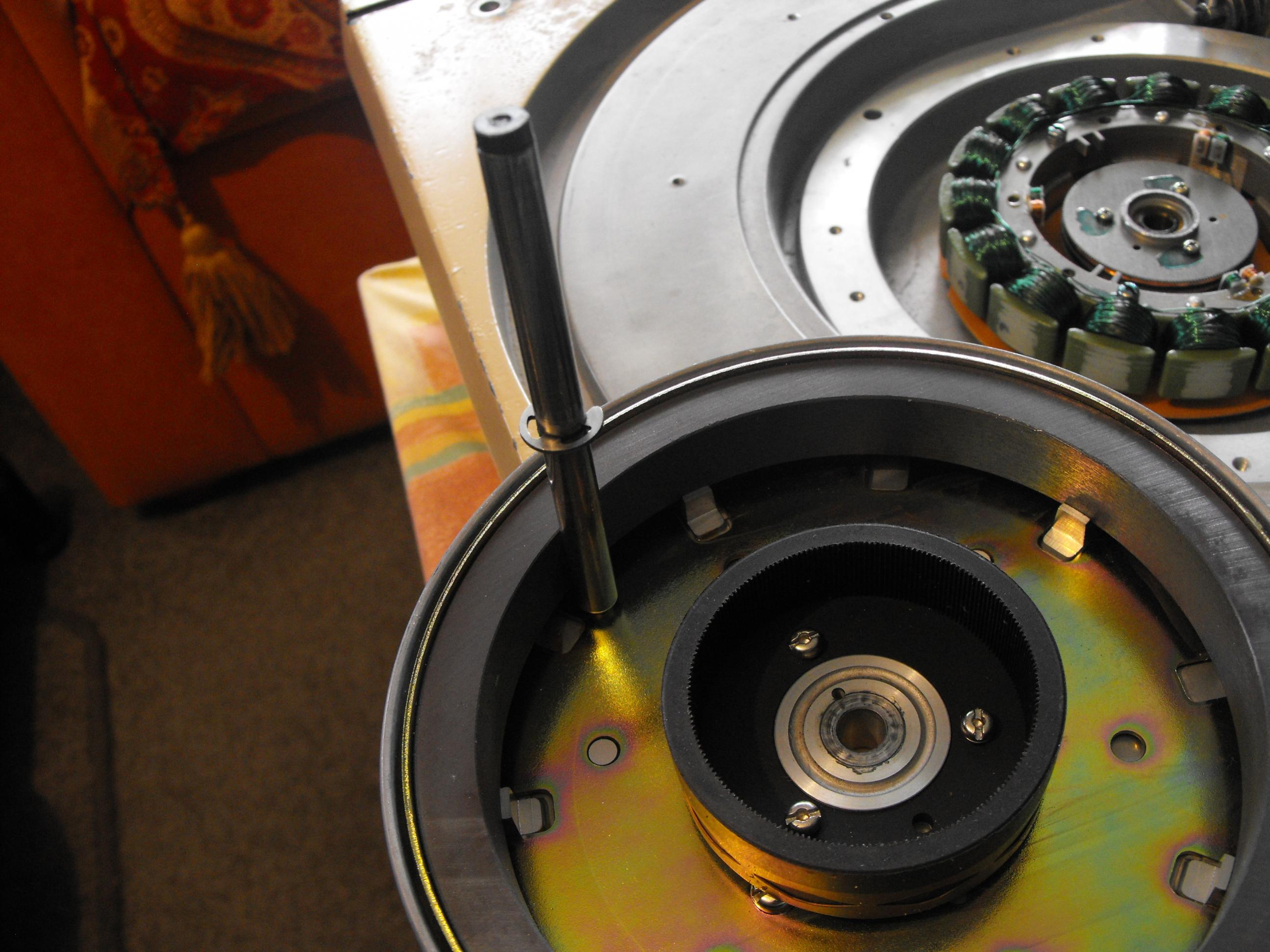

A loose bearing issue

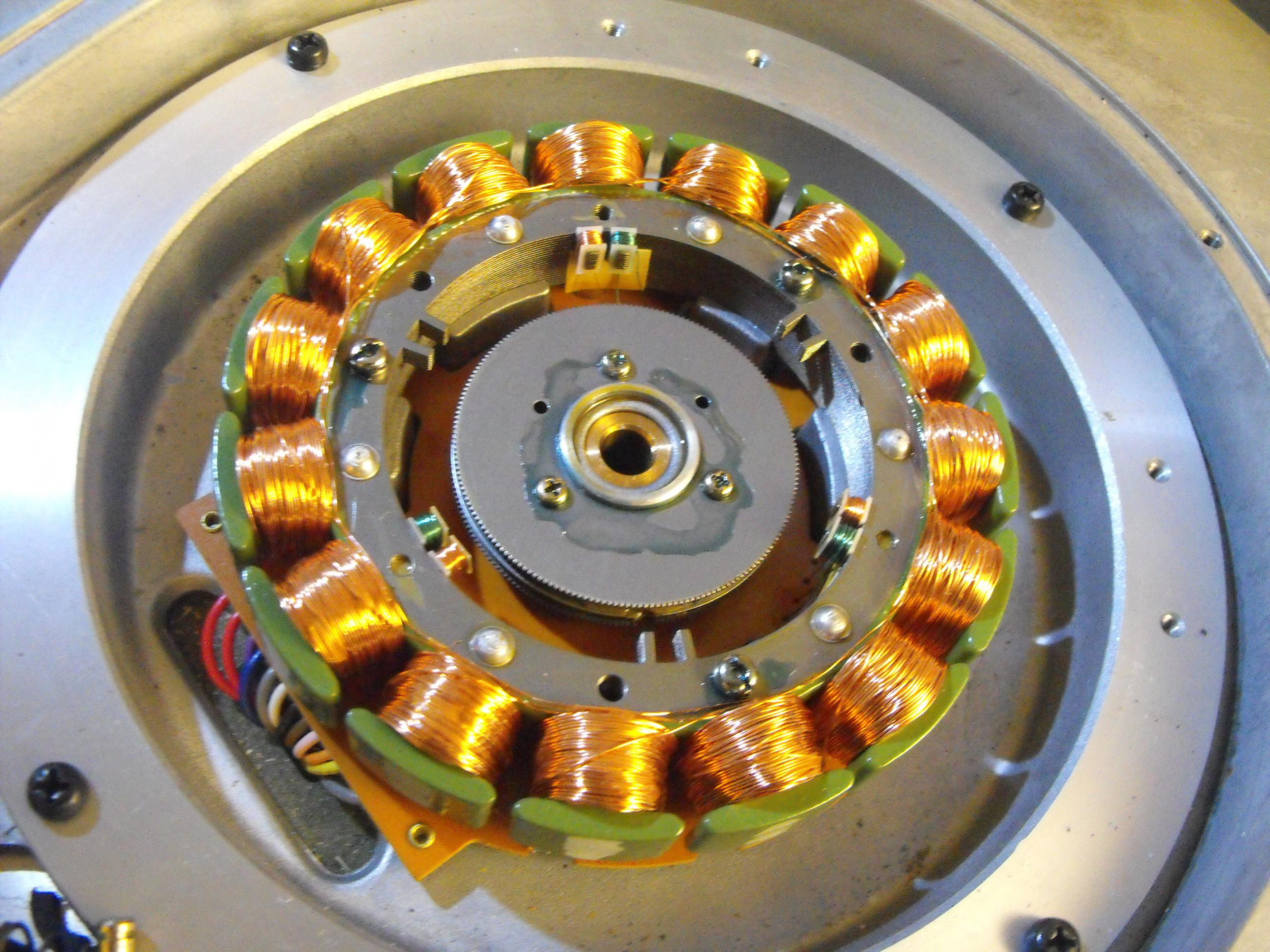

I am checking all my SP10 mkII thrust bearings for wear. This one is not too bad but still will be replaced. It has another issue. I bought it cheap for spares with the power supply cable cut off at the chassis, and no power supply. It had a poor paint job sometime previously but the boards all seem to be working. I found that the motor shaft was loose in the rotor and spinning freely. From the look of the thrust bearing, brake belt and motor shaft, it is not a high use sample. I will fit a new Torlon thrust bearing and re-fix the shaft with Loctite. It looks like the oil lubrication exit hole is quite close to the top of the shaft. Maybe over generous lubrication oil can migrate up the shaft and loosen the press fit. Just speculating.Here are before and after pictures of the thrust bearing for one of my SP10's. The images says it all. The motor date is 1978.
....and re-fix the shaft with Loctite.

I have a motor with the same problem. Except that this one was used over a period of time to the extent that there is ware in the sleeve of the cast motor chassis, such that the platter could rock. This will require re-fitting of the bearing, and will need either a completely new custom bearing or a sleeve over the old one.

One mine the shaft does not rock in the bearing sleeve but there is slight rock in the loose rotor/shaft join. I am hoping the locking compound will fix this with negligible tilt.I have a motor with the same problem. Except that this one was used over a period of time to the extent that there is ware in the sleeve of the cast motor chassis, such that the platter could rock.
So, too, in mine. The bearing seemed fine after I freed the shaft and oiled it.

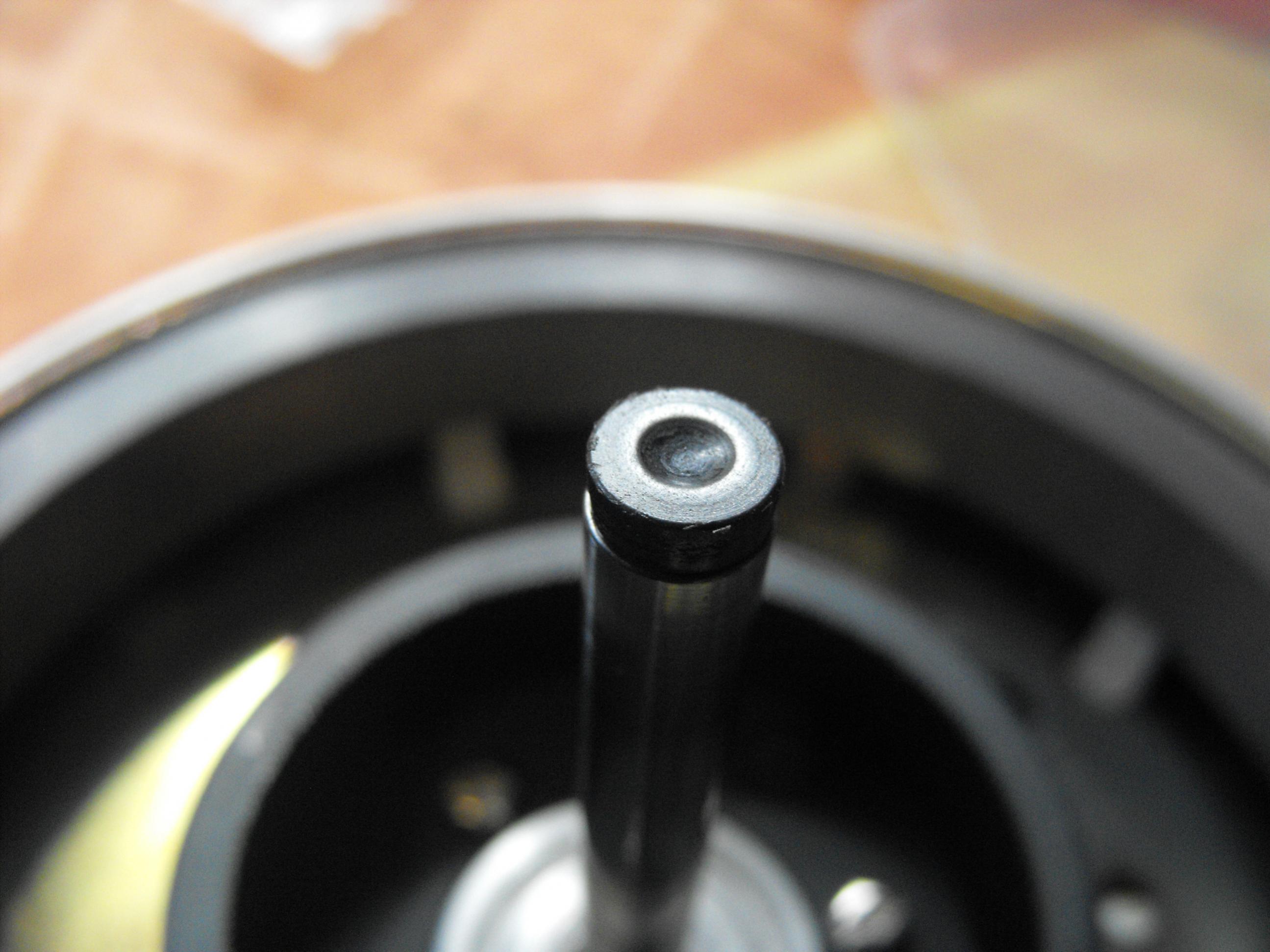

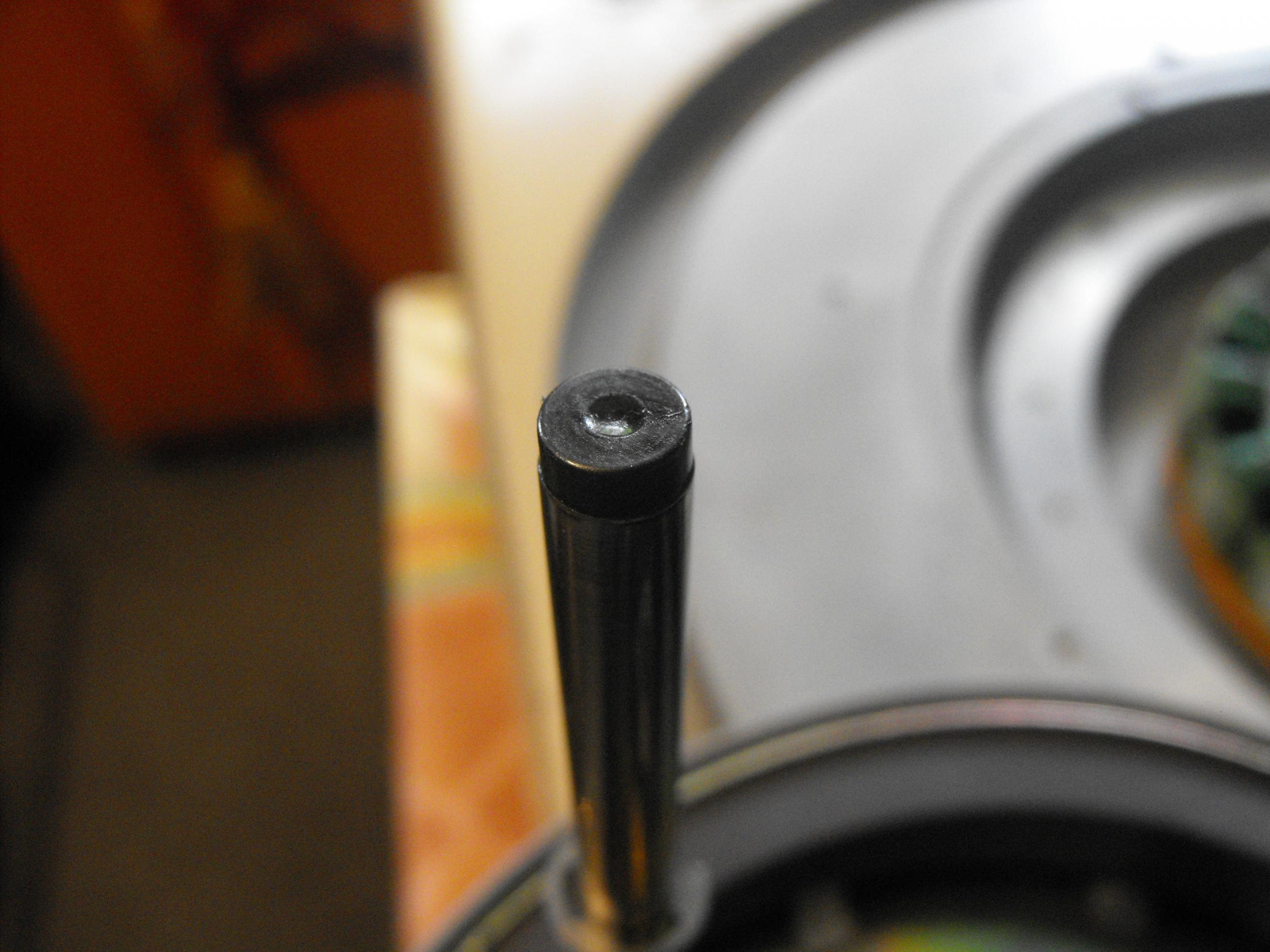

This is my third thrust bearing check. This sample came from a radio station toss out. Typical of observed wear so far. Definitely needs replacing. Two more to go. I am posting these images as a record of typical wear for well used samples. All examples are mid-late 70's. No discernible rock in the bearing.I am checking all my SP10 mkII thrust bearings for wear.
This is number 4. One more to go. Similar to previous 2.Two more to go.

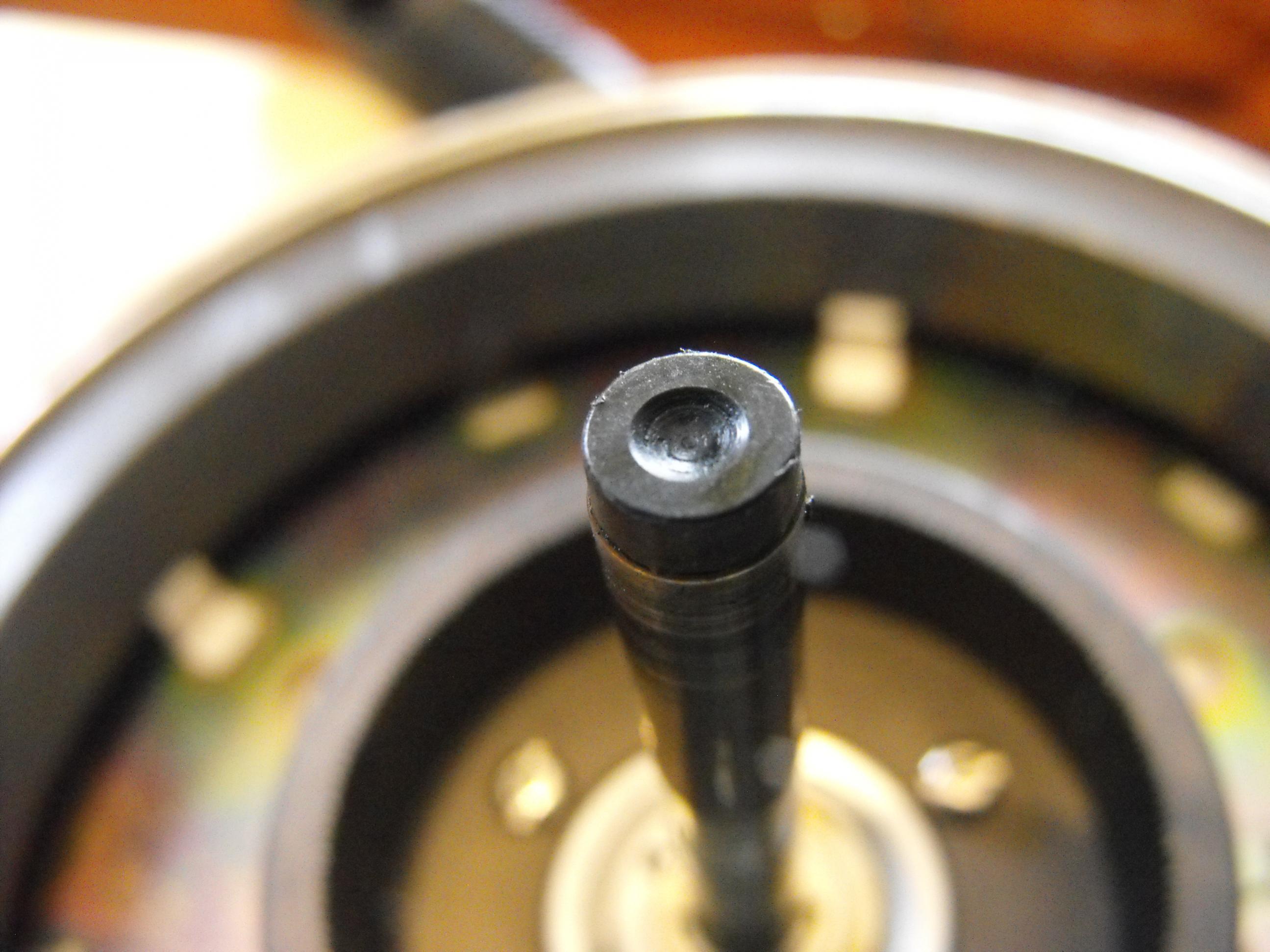

This is number 5 and the last one. It was getting a bit boring but this last one is different. Firstly it is the most regularly used with my favourite tonearm/cartridge combination, SME IV, Ortofon MC5000. It's been in regular use for 12 years but shows the least wear. In fact I will not replace this thrust cap but use it as a control for monitoring the wear of the new replacements. Secondly the motor windings are different. The varnish is clear in comparison to the green of all others I have seen. Maybe this is late sample. I will check the wear of the new thrust bearing caps in a couple of months to compare with this example.This is number 4. One more to go. Similar to previous 2.

Bon, were all these bearings wet when you have disassembled them? Have you wiped off the oil for the photos?
I have seen similar over the years, they were all wet. Never seen a dry SP-10. The oil is mostly dirty as it has picked up the worn plastic material.
Dave
Yes, they all had a slick of oil. The first and most worn of them had a black sludge that I wiped off with a cotton bud (q-tip). The best had recognisable oil but was one I had lubricated once a year.Bon, were all these bearings wet when you have disassembled them? Have you wiped off the oil for the photos?
