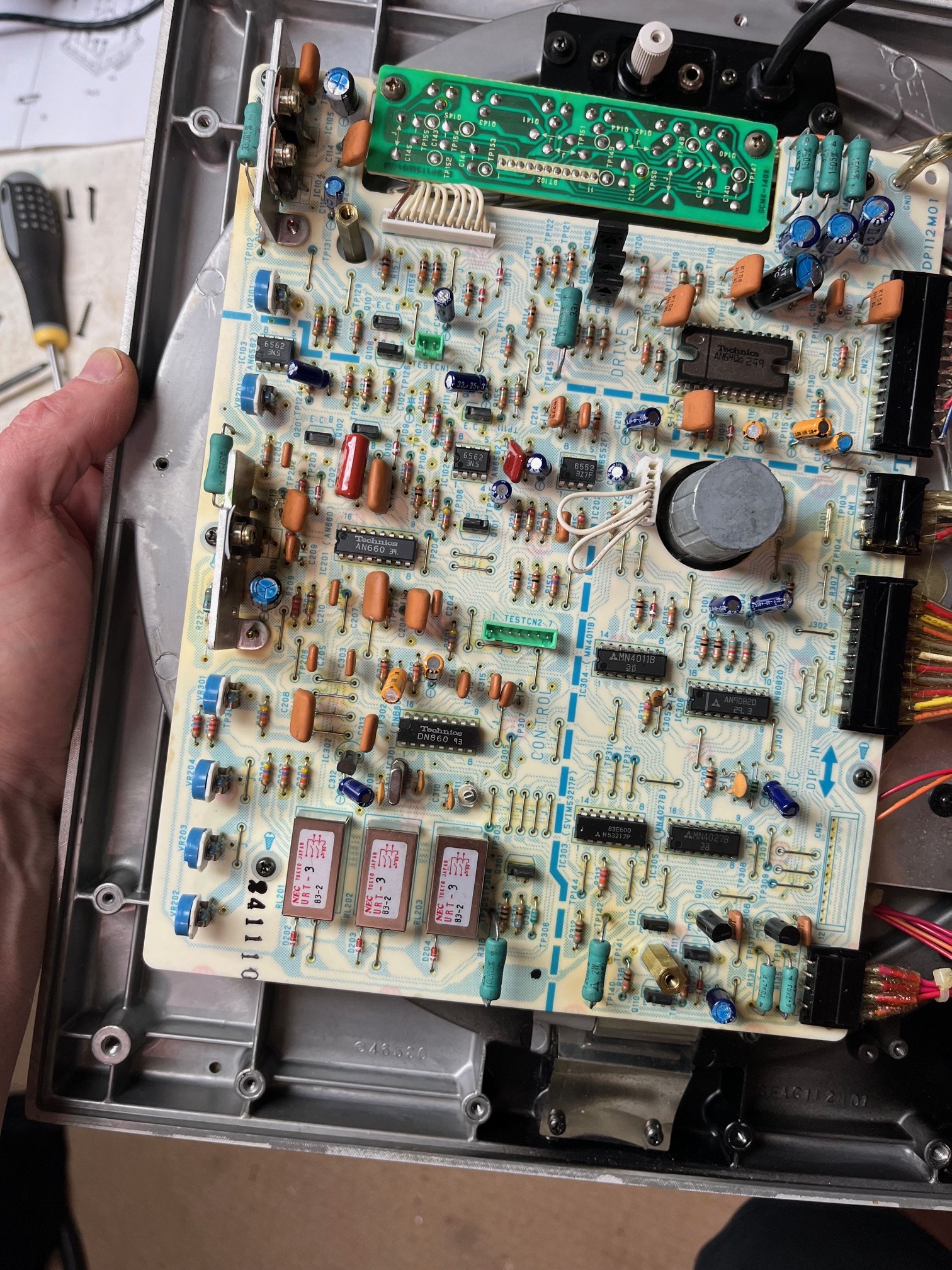

It could be a bad pot but turning the pot changes the voltage measurement consistently until I approach the goal of 0 V at which point it jumps back up to > 1 V & I can hear the motor starting to make funky sounds.

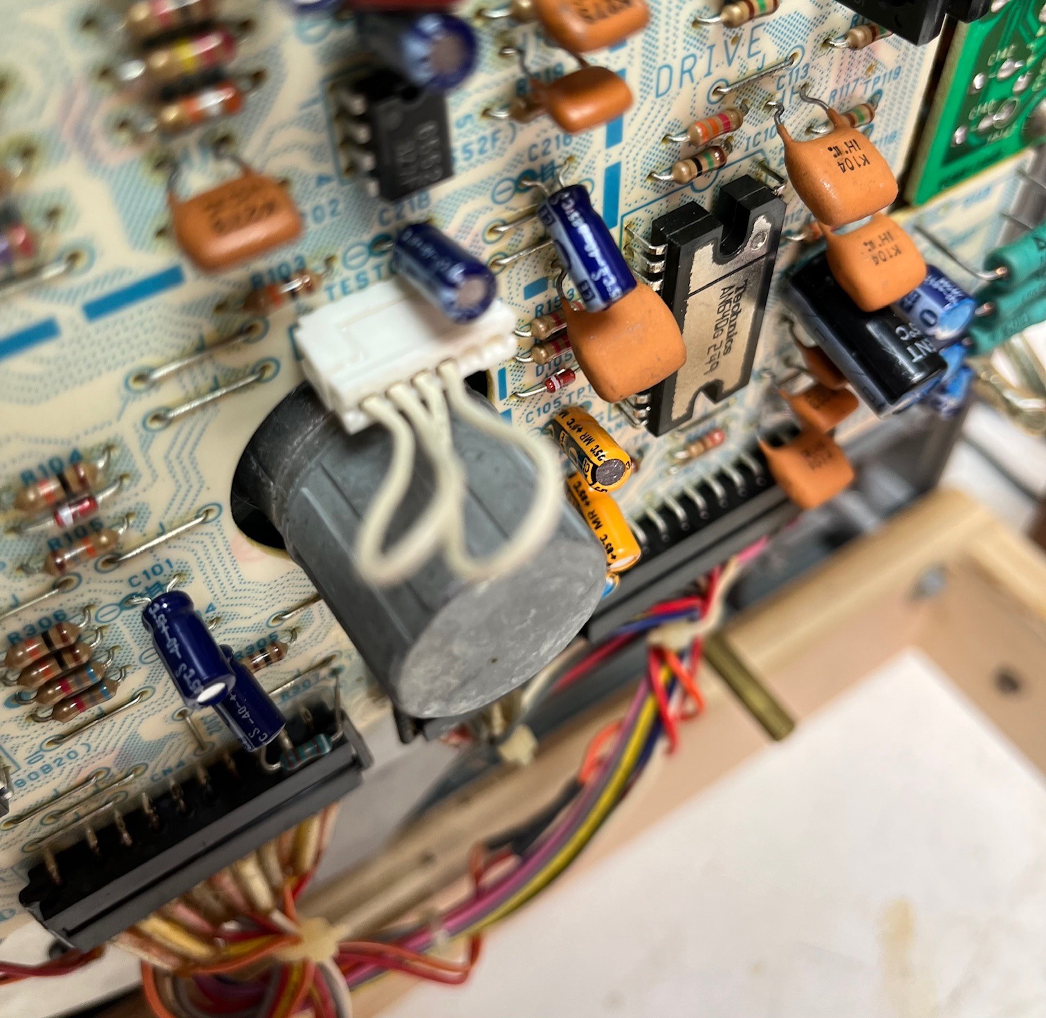

For the record, I haven't done a dogmatic recap of every electrolytic. The sticker on the motor says 1983 & it appears that some caps have been replaced because they look different from the others and it looks like someone marked them with blue nail polish perhaps to flag them? I have no idea but you can look at the attached pic.

I was able to set the offset voltage and VR101 had noticable impact. When too far off the platter would start spinning pretty fast. When it was at 30 mV the platter stops, or tries to. I've attached a link to a video showing it at 30mV - the video is about 30MB, too big to attach.
I got the RS setting down to 0.162V and everything seems to be working fine. I do feel the slightest vibration when running but it's about the same as I feel from my Denon DP-80 - something normal from DD turntables? Would it be advisable to replace VR201 or start re-capping?

I followed the procedure:
Removed Test CN3 and applied 40mV between pins 5 & 3
Turned on TT power supply and hit start (33 rpm)
Adjusted VR101 to get 30mV across Test CN1
At 30mV the platter stops, or tries to. Turning VR101 beyond the 30mV point causes platter rotation to reverse.

The first video of the platter almost stopped was shot while performing the offset voltage setting procedure which required removing the Test CN3 plug that jumps 1-2 and 3-4 under normal operation (see photo). You then inject 40mV between 3-5 but so it's not like normal operation where the platter would spin. It seems very odd that concidentally when I got close to the target output of 30mV, the platter comes to a stop, or tries to. You can see in the video that the platter does stop & reverse then reverse again while hovering around being stopped.
