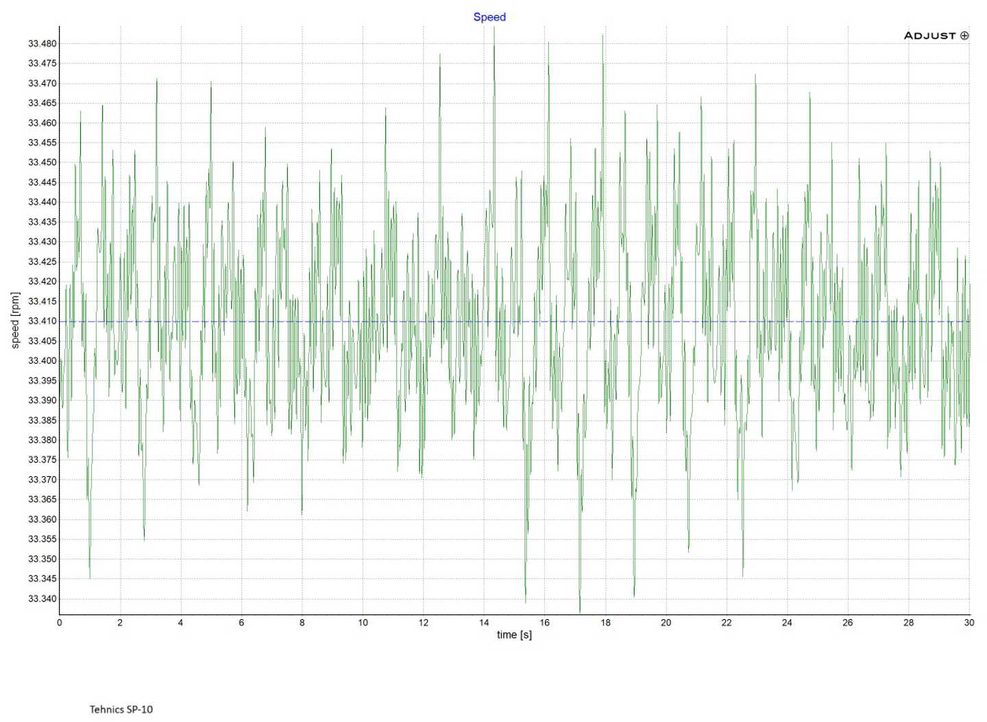

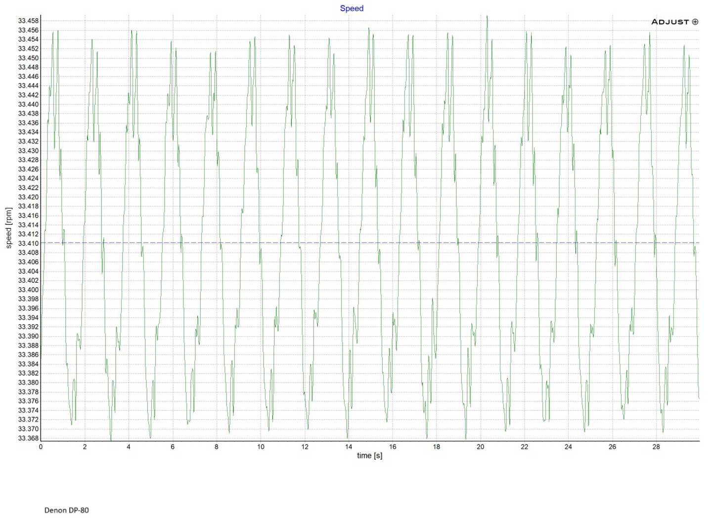

Checking w&f with the Feickert Adjust+ software & test record, I get .08% while my Denon which is closed loop gets .03%. I've attached plots of each if anyone is interested. Strangely, they're both a 33.41, possibly a software glitch.

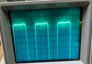

FG, frequency generator, or what the service manual calls "liquid crystal oscillation"? That's rock solid when viewing with my scope - see attached of wave form. Could this be mechanical? I do have a new thrust pad that I haven't installed yet.Something’s wrong - shouldn’t feel a hint of vibration. How much is the FG signal moving around?
FG is the frequency generator from the motor. Control board CN205 (FG Out). Mess with the platter while watching it so you get a sense of it.
The manual shows FG signal in, IC201 pin 16? When I attach my scope to that I see a clean sine wave but it's amplitude undulates (grows and shrinks) at what looks like a constant frequency. It's more noitcable at 45 & 78. The vibration I feel seems to pulse at that same frequency but the frequency of the vibration doesn't change.FG is the frequency generator from the motor. Control board CN205 (FG Out). Mess with the platter while watching it so you get a sense of it.

What does the motor drive look like? Scope the collector of one of the drive outputs Q140, Q142, Q144.
I scoped the collectors on those transistors and they had this somewhat chaotic behavior:

Ah, my ignorance is showing. Is it easier to view low frequency signals with a digital scope? This is the best I could get with my Tektronix 2235 unless I'm missing something. My multimeter displayed 5.6 Hz and other values as it tried to figure it out but 5.6 kept re-appearing.What’s your time base? You’re looking for a 5.55Hz signal
Scope was set at 50 ms/div. The signal appears somewhere arount 5 Hz.
