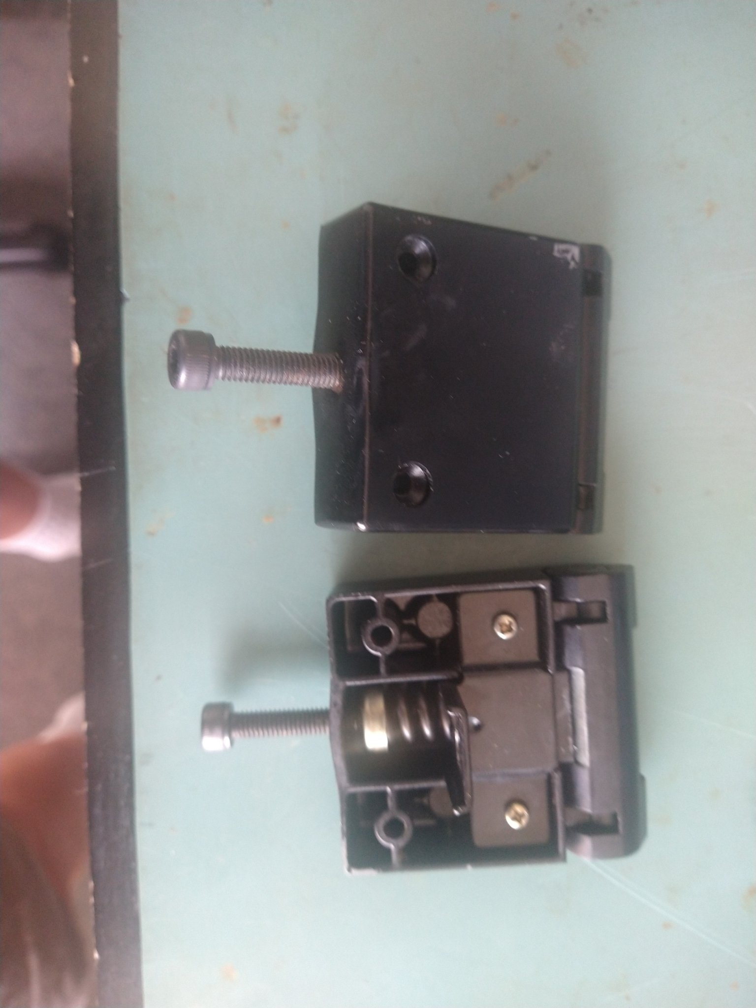

Was there a post somewhere on modifying the obsidian cover hinge with a bigger screw ? Can't find it ? Thanks DaveBlock
I'm guessing you're talking about the the bolt that adjusts the hinge spring tension. These hinges were bent and needed straightening before being drilled and tapped for larger bolts. IIRC these are M6 bolts.
Do you have the post number please ? I somehow thought it revolved around a M5 rivnut ? I'm considering putting a spacer inside as the spring cap has an indentation ?
Many thanks Dave
Many thanks Dave
If you tap for a larger size it’s just going to pull out again at some point. Using a threaded insert is a much better fix.

The insert is not a bad idea although if I did this again I would use a 3mm steel plate with M5 thread to spread the load on the aluminium hinge preventing it bending again.
I was pondering that too. As I have them on the bench but not yet disassembled , does anyone have a photo of the pressure-pad/cup that is on the spring ?

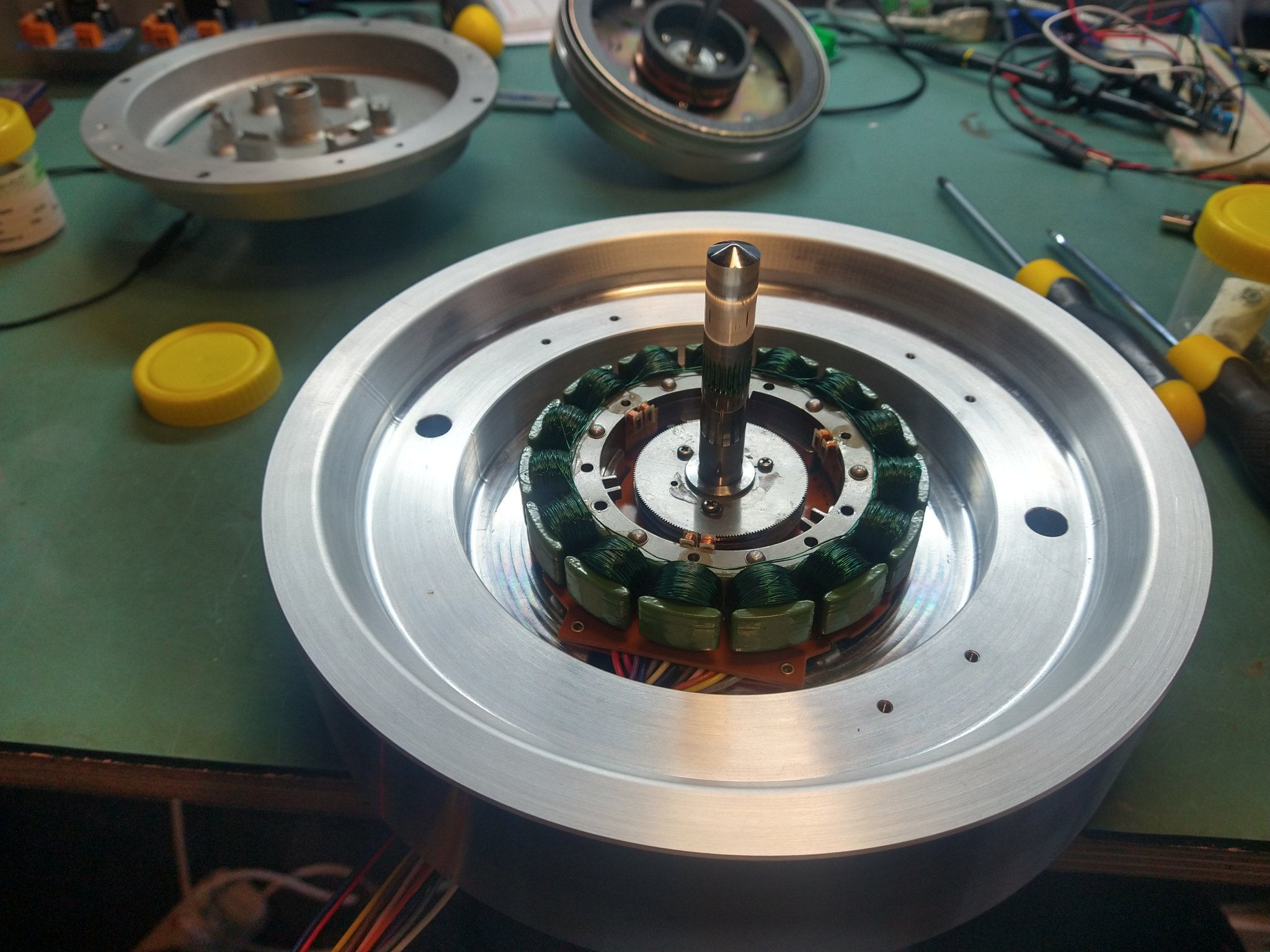

Thanks. As hinted in an earlier post I wasn't sure if it took an external drive waveform or self commutated as you describe. So it should be possible to spin up the motor at some random speed even with malfunctioning logic or control boards by giving it a suitable current limited input voltage from a bench PSU? FWIW all the waveforms on the control board look about right as far as one can tell from spinning it by hand so probably not the drive board but if I can rule it out by say feeding it 10V DC via a 10K resistor and see it spin up to say 110RPM then that would be great.
I guess this is one of those repairs where you end up spending 30 hours on it and can only charge for a fraction of that but it is years since anything beat me🙄
Sorry, missed this while on the road. Really easy - pull the logic and control boards out, and with your bench PSU referenced to the SP-10 backplane 0V line, give it around 24.5VDC and it'll start to spin. The lower the voltage the more drive current, but no need to go more than 1V lower, and watch the motor speed - you're playing with mV to reach equilibrium. You may need to push start it, or give it a negative "goose".

I ended up going for a full re-cap and underneath a 100uf 16V electrolytic on the logic board there was a leak which, whilst not visible from above while capacitor in place, had corroded through the PCB track severing it on both sides of the capacitors lead out wire.
