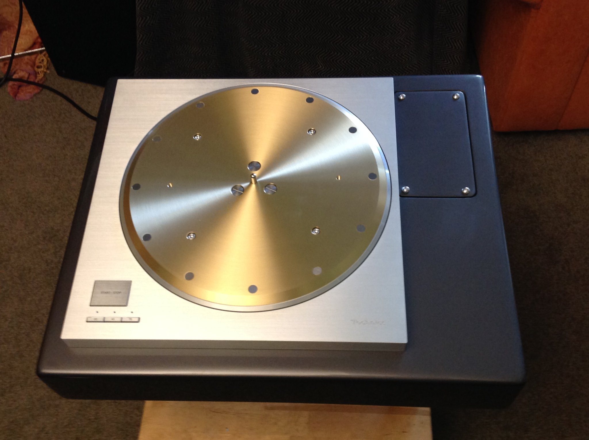

does anyone know if this plinth is real obsidian?

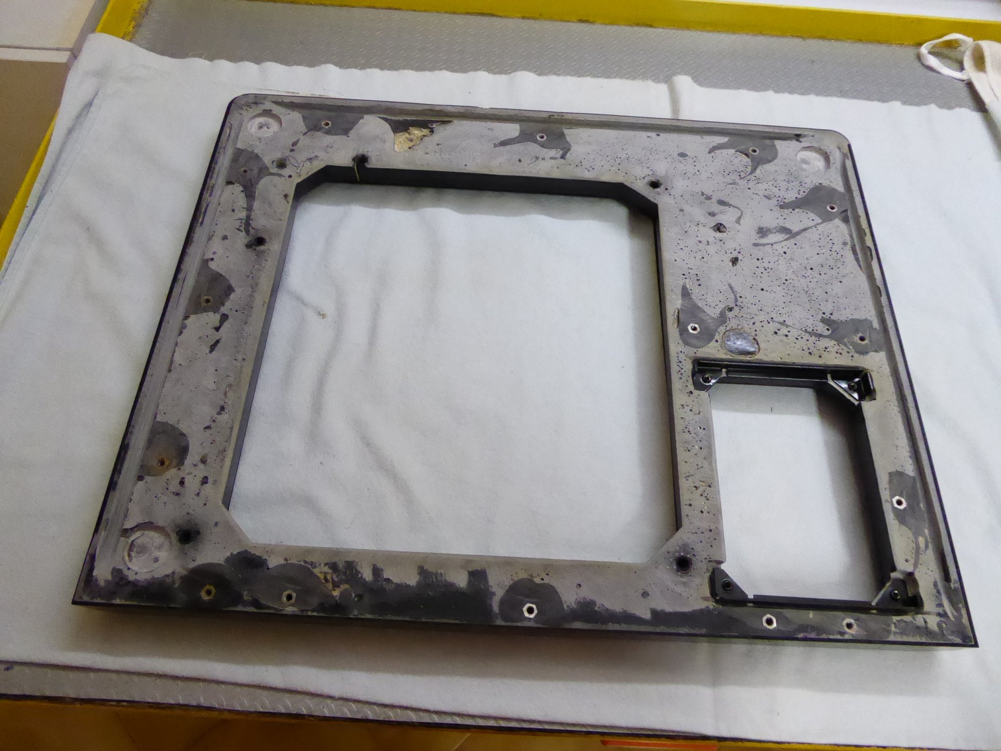

All of them are composite. The B5/7 were the last evolution and are TNRC.

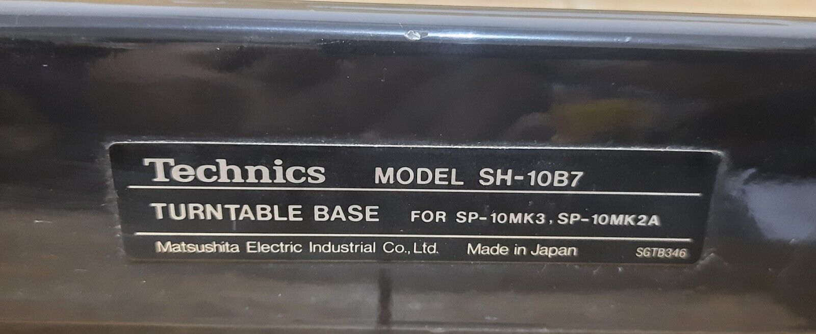

SH-10B7 obsidian plinth question:
Looking at this ad for an SP-10R with EPA-100mk2 and SH-10B7 plinth.
https://j-corder.com/shop/ols/products/technics-sp-10r-wobsidian-plinth--epa-100-mk2-boron-tonearm
Seems like a reasonable deal for the new (albeit unboxed) SP-10R and the EPA-100mk2 (claimed to be in perfect condition) alone, but my wife is taken with the obsidian plinth. Dragon glass! I think she's preparing for the White Walkers. I think this plinth is actually an SH-10B5, though the add says SH-10B7, and my question is: does anyone know if this plinth is real obsidian? I've searched and searched and mostly found contradictory information.
Sh10B5 or Sh10B7? You should ask the seller; behind the base there is a badge just read what it is,
alternatively the B5 base has the circular hole to house the motor the B7 base has the square hole.
It involves obsidian powder and binders all poured into a mold to obtain the desired shape and obtain constant production, the lead screws are applied and cemented to the lower side, finally the upper surface is vitrified with a process unknown to me... this is not applied paint.

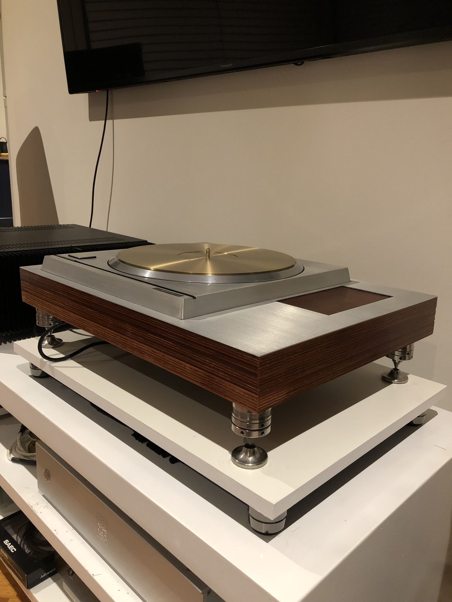

The company where I get my Permalli has a CNC router. One SP10mk2 owner had his Permalli plinth CNC cut which is what prompted me to try Permalli, here is a pic of his TT. The aluminium is necessary to prevent the Permalli from warping even though the Permalli is 2x30mm panels it can still warp.
Once everything is cut it's pretty easy to glue up with epoxy.

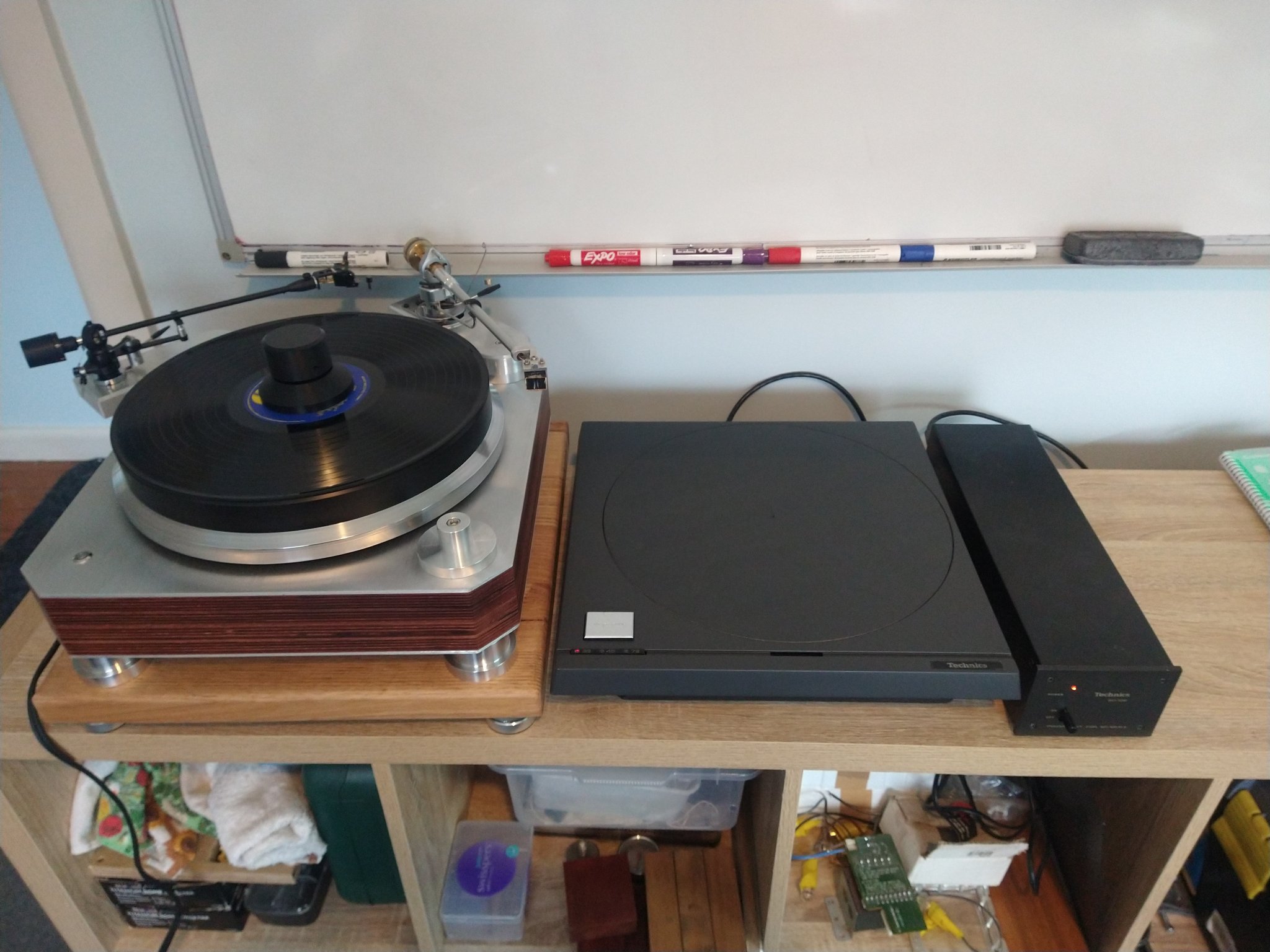

@rdb64 I am also very familiar with the Mk II used in Plywoods ranging from:
600Kg/m3 (Birch Marine Plywood ) -
850Kg/m3 (MU25 - Densified / Non Resin Impregnated ) -
1400Kg/m3 (Phenolic Resin Impregnated Densified Wood) of which Panzerholz or Permali are Brands for this material type.
Phenolic Resin Impregnated Densified Wood is the one to go for, it is also usually Delignified, creating a highly compressible wood fibre.
I have been demo'd all Three of the above Plinth Materials, on the same Mounting Set Up, withe the same design removable Headshell Tonearm and Cartridge.
The Phenolic Resin Impregnated Densified Wood is the material that has made the best impression.
As a basic description, it is hard to believe the end sound being produced can be tidied up any better once having heard the improvement it creates.
To have more option on Colour with a Phenolic Resin Impregnated Densified Wood, there is a Dymond Wood that is a suitable substitute for P'holz or P'mali.

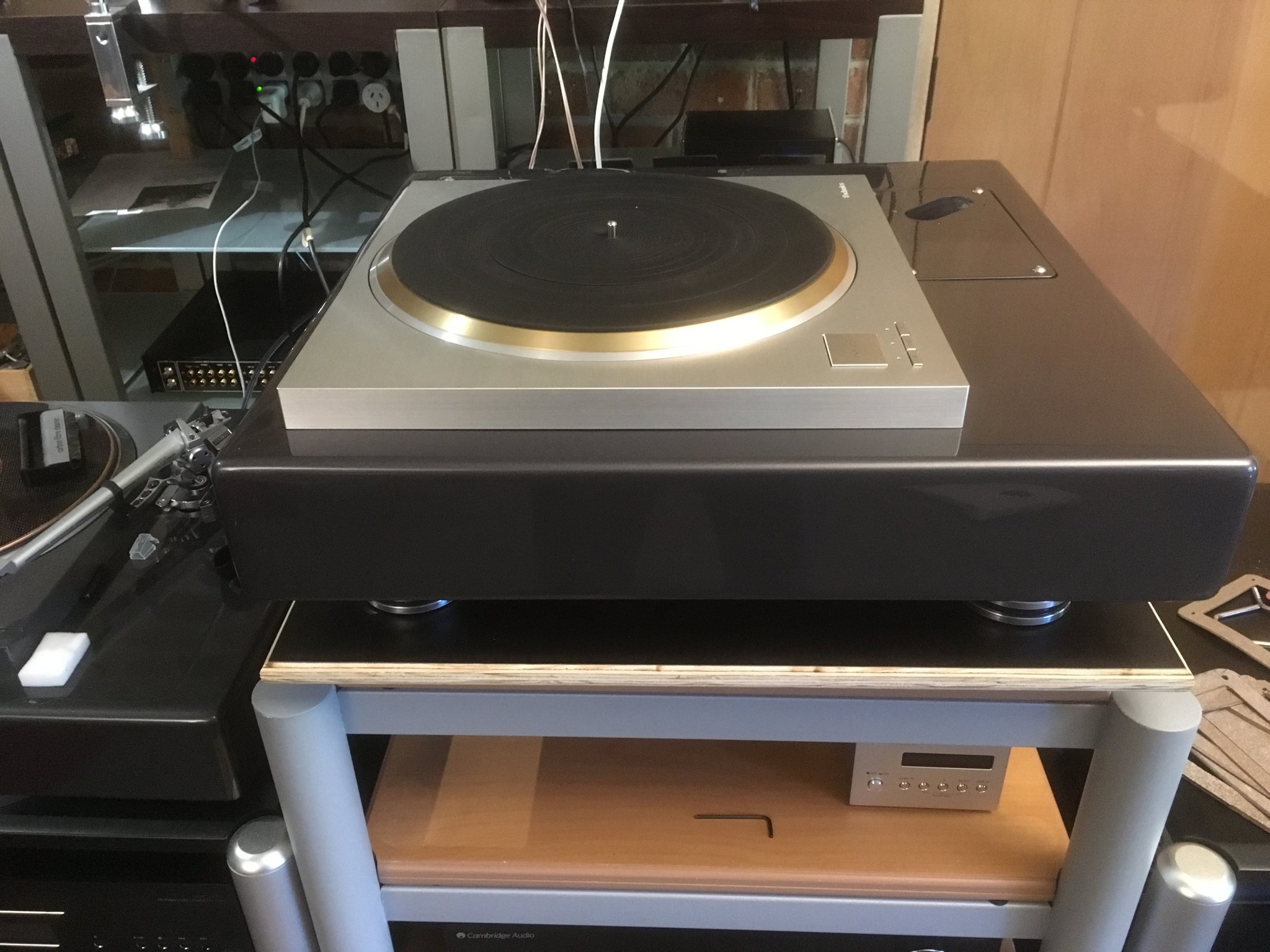

A good many people find no issue with the Technics plinths. Quite a premium on the B7 being the rarest one.

@tonyEE Once the SP10 chassis is bolted to the plinth it becomes a very rigid coupling. Even better if the motor is removed from the SP10 chassis and installed separately in a good plinth. Artisan Fidelity and Steve Dobbins have been do this to the SP10 mk2 and mk3 for years.
I owned an LP12 for 30years and when I bought the SP10mk2 it was a much better sounding TT than the LP12. The Keel is a good upgrade over the old resonant subchassis. Linn have made a plinth from Panzerholtz. Keep in mind even a spring suspended TT will transmit vibration through the springs above their resonant frequency. Those springs will transmit 1kHz with ease. The Pz plinth will go a long way to lowering the amount of energy in the plinth that will be transmitted to the subchassis and thus to the arm/cartridge.
@rdb64 The Technics plinth is definitely not bad and probably anywhere as good as a plywood plinth. I've had an SP10mk2 in an SH-10B7 plinth and I also heard the mk2 in the Permalli plinth I posted above. It was this Permalli plinthed mk2 that was the catalyst for me to build my Permalli plinth it was that much better.
