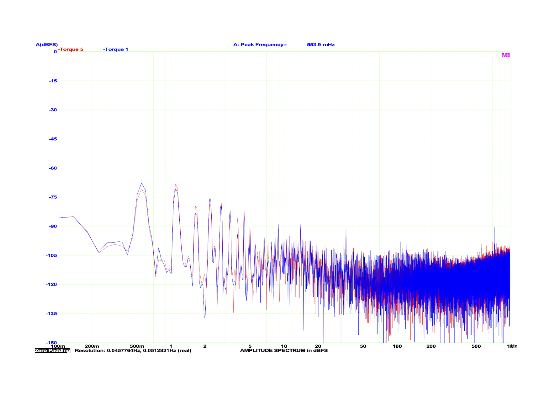

As I'm boxing up my 10R for awhile I decided to do some measurements before doing so. These were done in my basement with a 200lb maple top table with heavy duty industrial legs. The table is in the corner of the foundation, so three legs rest on foundation footers and only one on the slab. Obvious things like turning off the heating system were done to prevent as much vibration as possible. Not the most ideal environment, but the best I can do ATM.
I'm only showing torque 1 vs 5 here though I took 5 measurements of each of the 5 torque settings. I may process those later, but I doubt it.

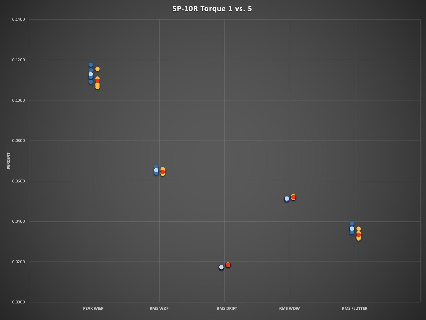

2) Scatter plot of the MI data. Torque 5 (T5) is the left set and the deviating colors on each series are the mean.
3) Spectrum of T5 vs. T1. This is only one sample of each, but the rest weren't remarkably different.

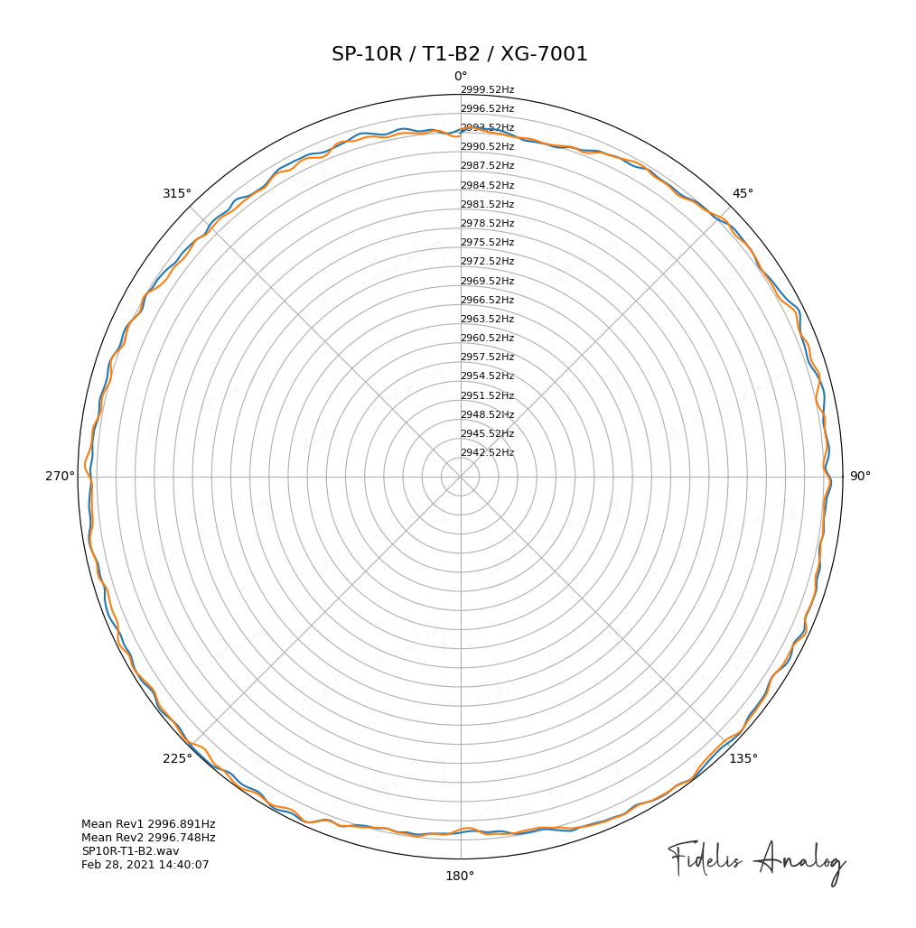

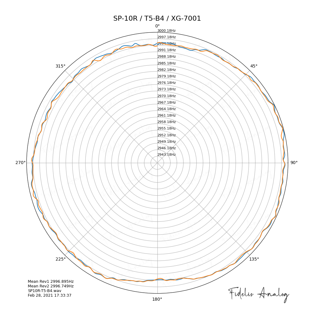

4) Polar plots of T1 and T5. These are from the same recordings as the spectrum. Also very consistent between settings.
The audio samples I used are indexed - they all start at the same point on the record and are the same duration for measurement consistency. You'll notice this on the polar plots.
The MI data is unweighted as I wanted a cleaner look at the numbers. RMS drift and RMS wow favor T5 and are very consistent. RMS W&F is close while the rest favor T1 though there is significant overlap.
On the demodulated spectrum T5 measured better at 0.55Hz every time. Not sure why Noel's measurement were so different there, but as mentioned his results didn't make sense. The most notable difference between T5 and T1 across the board were at 1.65Hz and 3.89Hz, favoring T1.
What stood out to me was the polar plots - the errors in the test record are, for lack of a better description, smoothed out with the T1 setting. Is the flutter measurement slightly better because the motor is being a bit lazy reacting to dynamic changes? This aligns with the better drift and wow figures for T5.

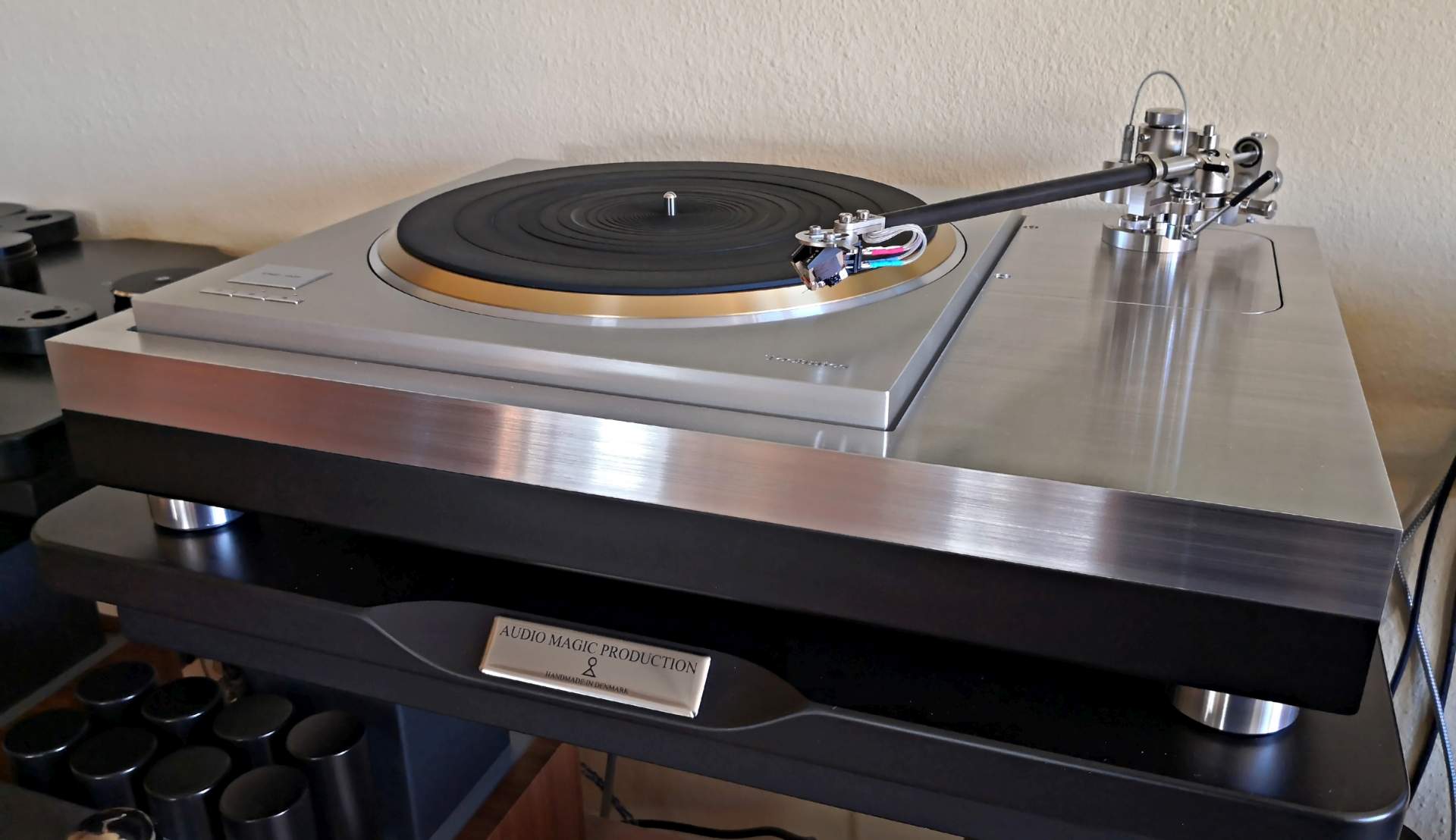

As the SP-10MKII/2A, MK3, and R chassis are essentially the same size one can just image search to find pictures of the combo. I found this one: SP10 advice - 2 Channel - HiFi WigWam
Due to the chassis shape a 9" arm has to be mounted quite far forward. It'll work fine, but the aesthetics and use-ability are a bit out of the norm.
Thanks for the link. Doesn't look too shabby. I guess it's even possible to mount a bit closer to the chassis and further back.
