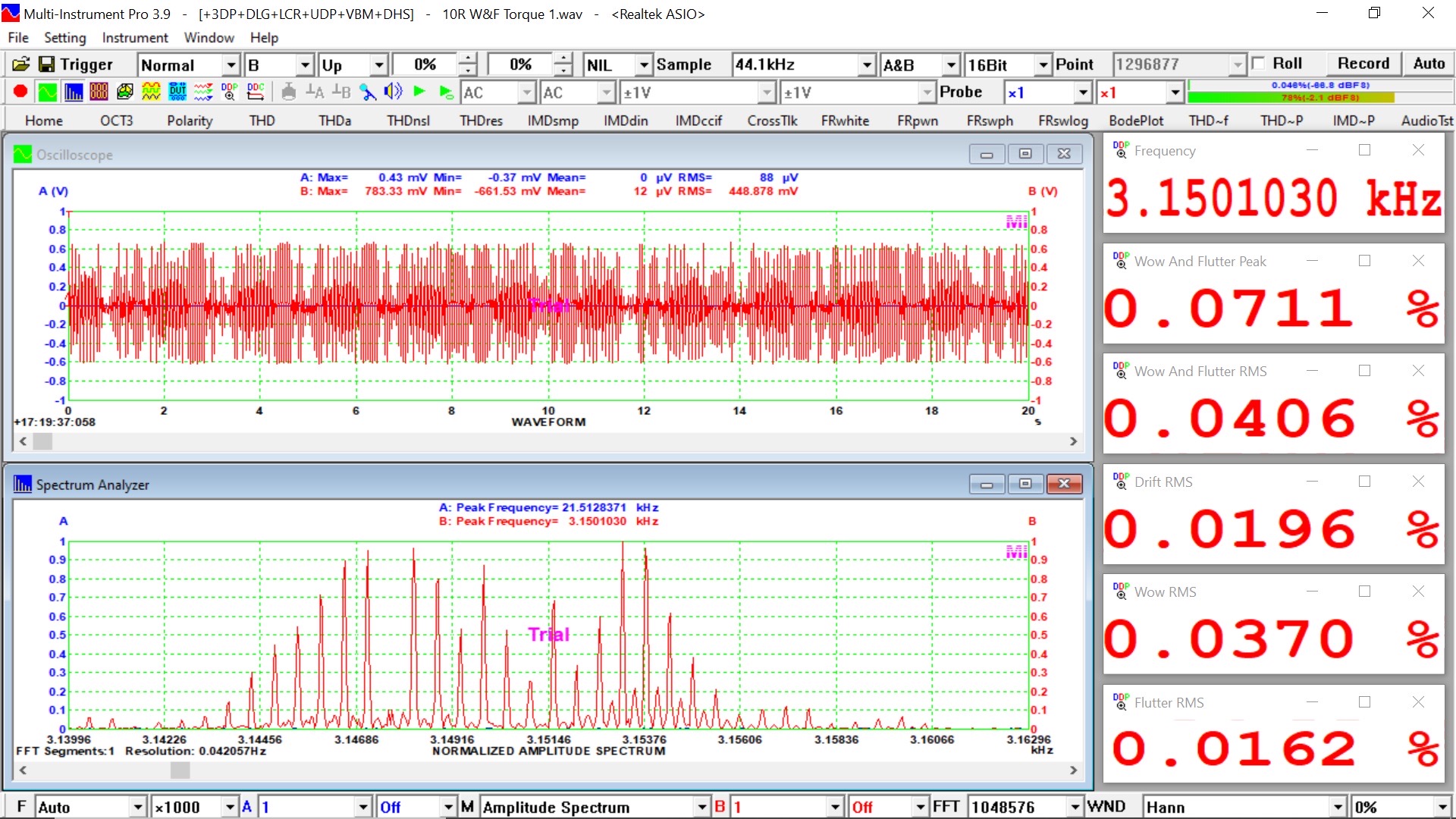

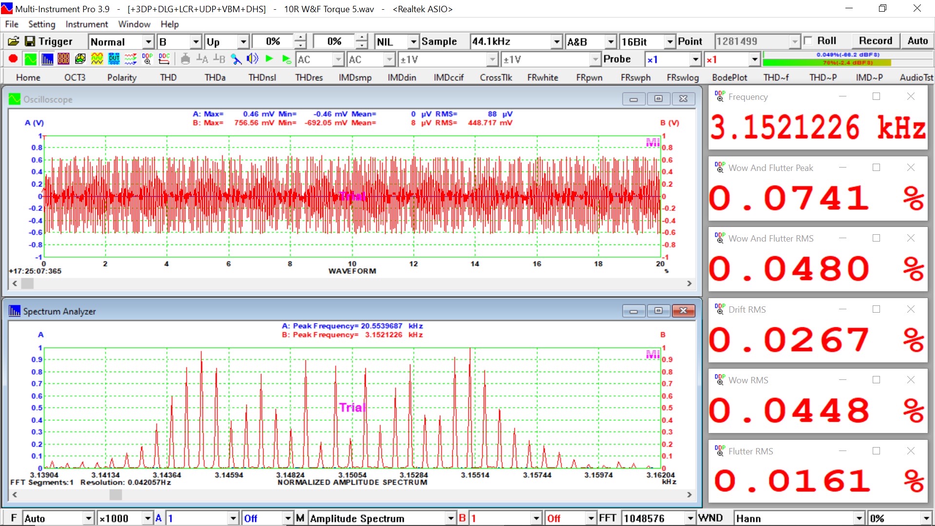

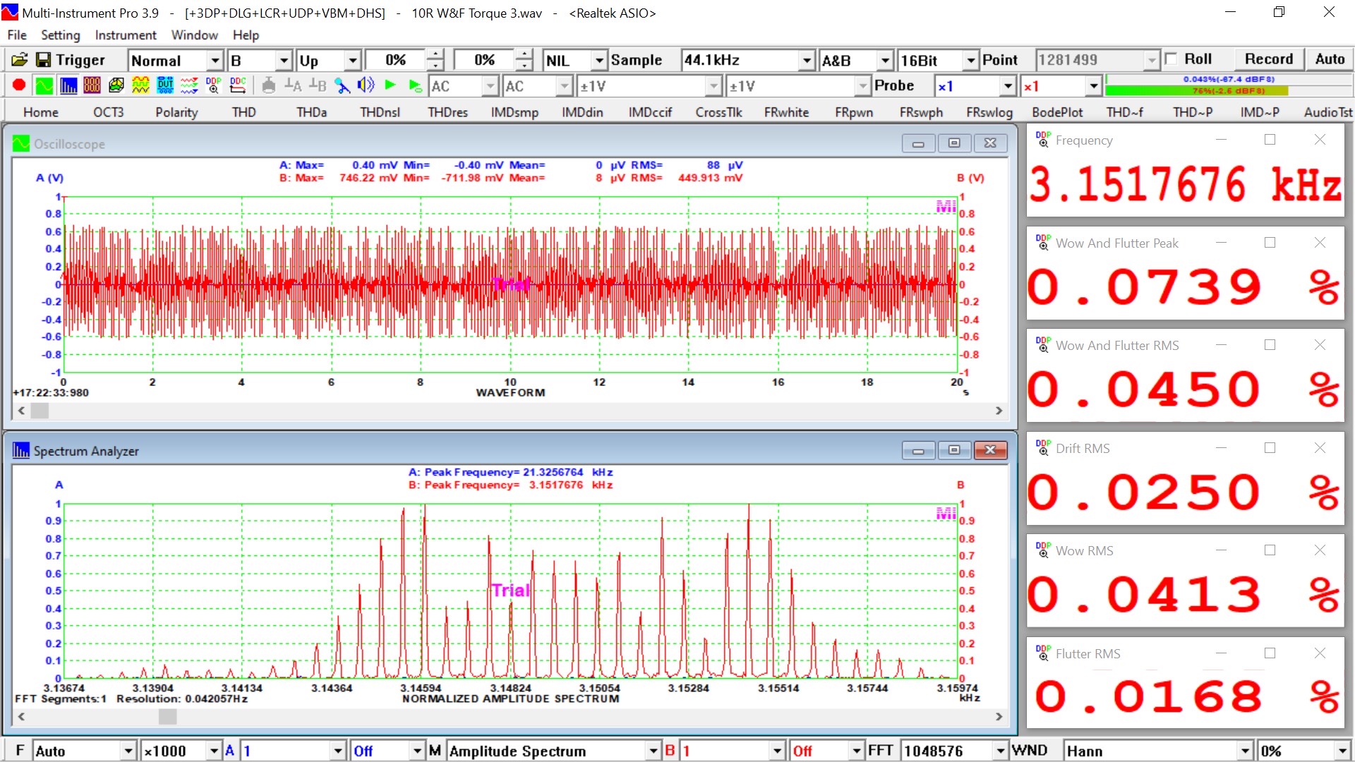

I thought I would post some W&F measurements for the 10R on the torque settings 1, 3, 5. I used the Vinyl Check LP (Tacet L 210) which is very good. The Ultimate Analogue Test LP AAPT-1 from Analogue Productions is very poor IME.If you want to go the technical route, find the setting that provides the lowest wow and flutter (if you even have a way of testing accurately enough) – but you may find there is no significant change here with torque settings either.
The measurements were taken in quick succession with the only variable being the torque settings. The tonearm is SME IV, cartridge Ortofon Cadenza Bronze. There was a very slight but consistent deterioration of the W&F figures as the torque settings increased. I doubt it would be audible but I have not completed the listening comparisons.
That LP looks rather poor too. Should easily get better than .025 weighted. Did you center the LP? I’m guessing not as the primary component changing is wow and not flutter.
The discussion since post #47, has been about whether the torque settings has an effect on the speed stability of the 10R, not about the absolute speed stability, which no-one disputes is state-of-the-art. My contribution describes my findings with a readily available test LP used as supplied. If you have some data with a superior test track and methodology, why don't you enlighten us?
I’m trying to determine if your test was properly conducted. So once again, did you center the record?
You may assume it was centred. I look forward to your results for W&F sensitivity to torque settings.
This highlights some of the issues with W&F as a number as well as singular 'tests' and the need to setup for tests properly.

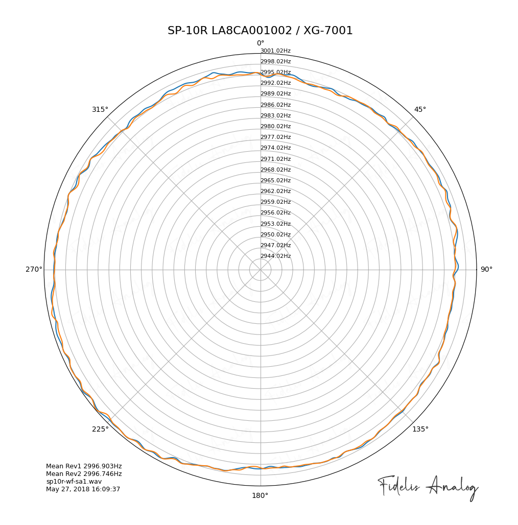

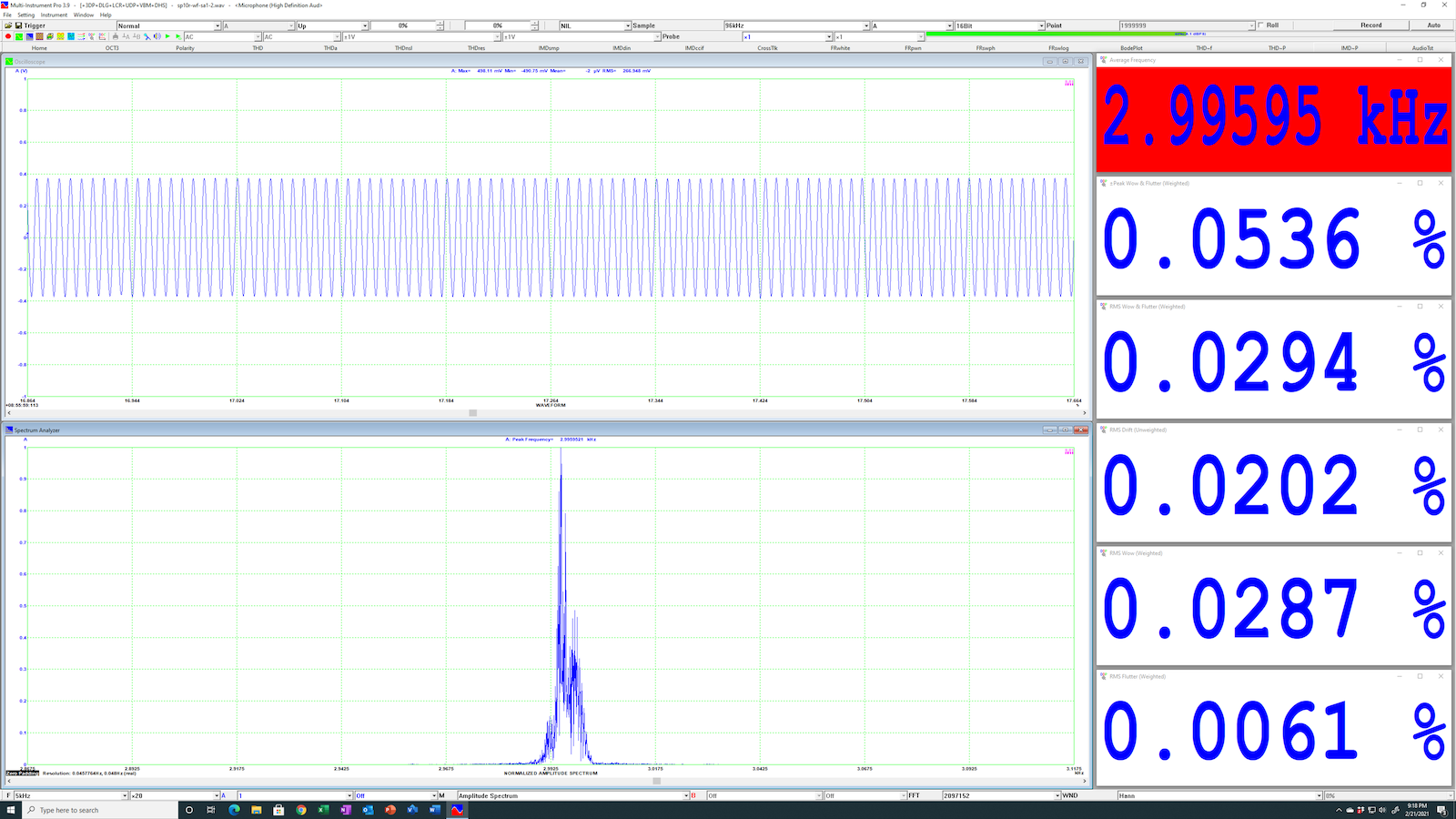

Below are measurements from my 10R done nearly three years ago now. You'll notice my flutter measurement is markedly lower than yours as is wow, though wow is higher than it should be. In the polar plot you can see that the test record is not centered which is a major contributor to the wow number, and that there's a 'slow' spot in the record.
There is a ton of nuance in W&F measurements, and a bit of an art when using a meter, but more telling. MI is great but you can't watch meter ballistics and ignore wow components from things like off-center records. You can FM demodulate and look at the spectrum, but it's far less obvious to the lay person as to what's going on. Bottom line is that there's a lot that can sneak in to those numbers.
