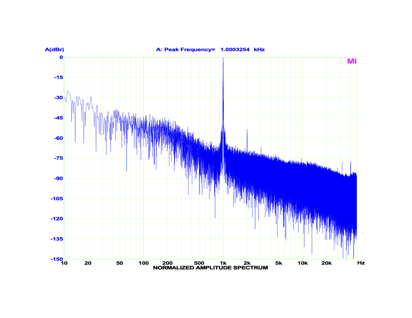

Attached is what I was talking about yesterday. Red is FM demodulated. The numbers are slightly different as I pushed the FFT up to 4M points. What's dominating the result is obvious.

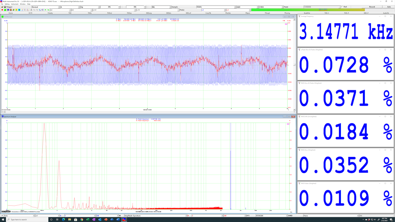

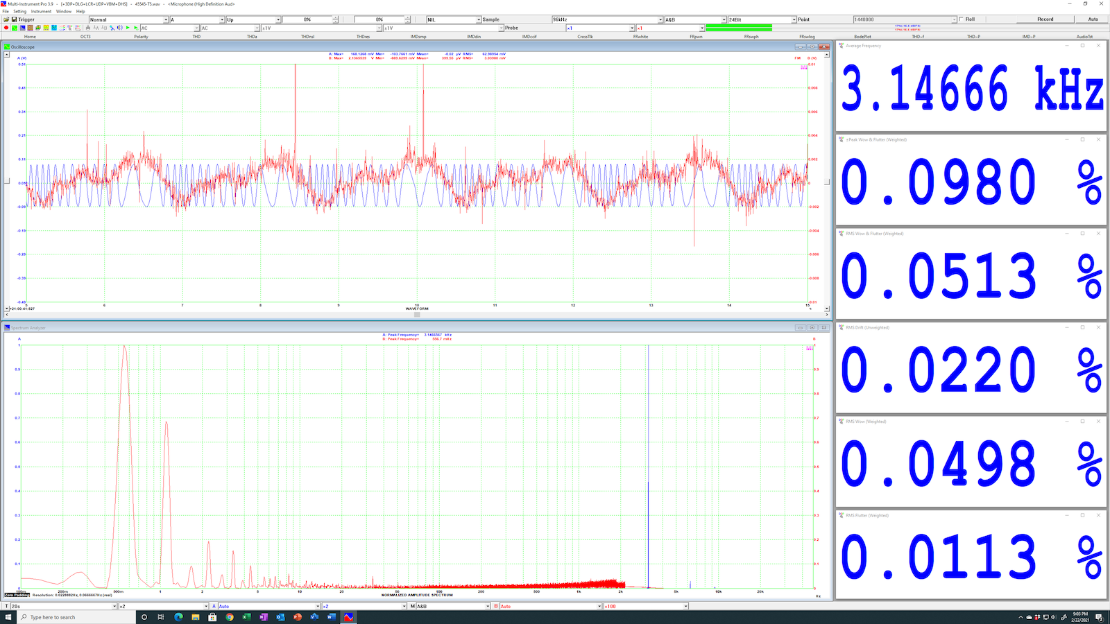

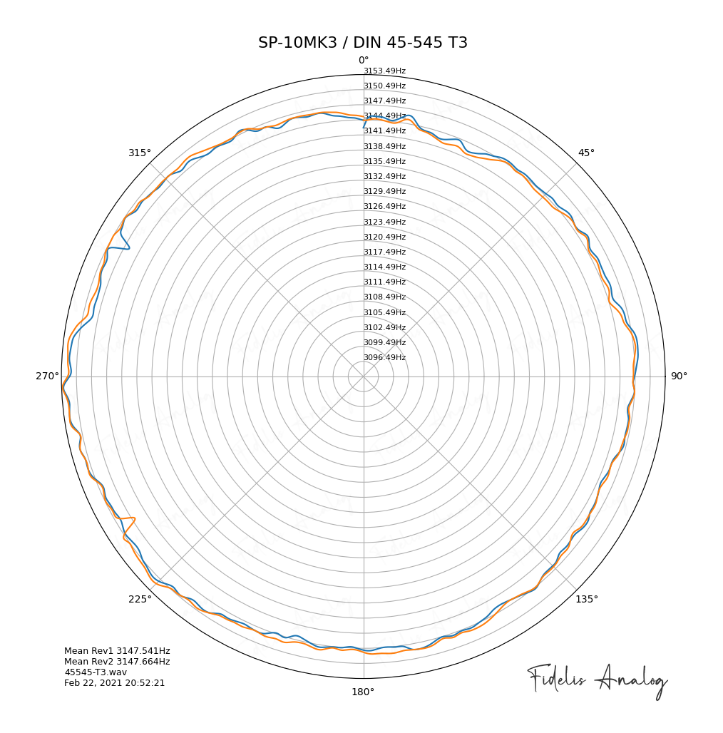

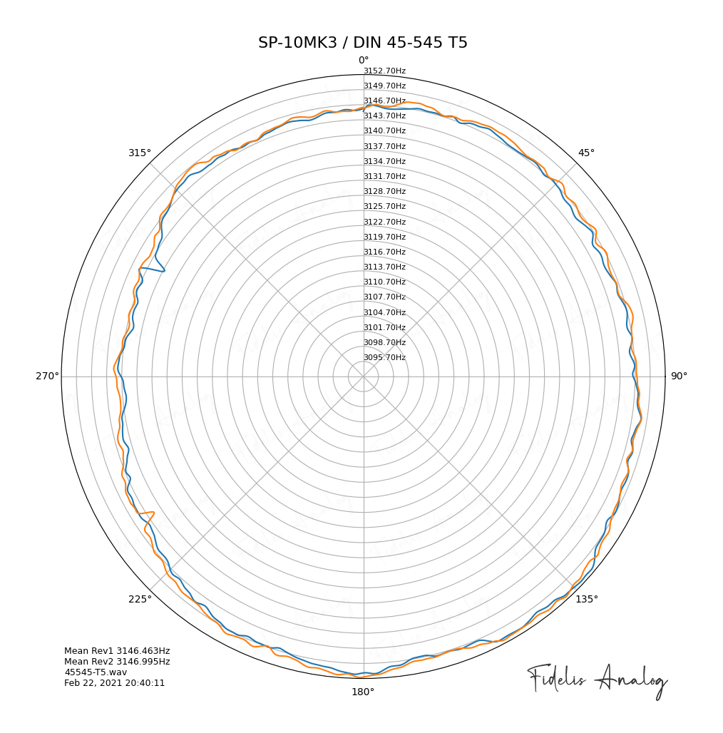

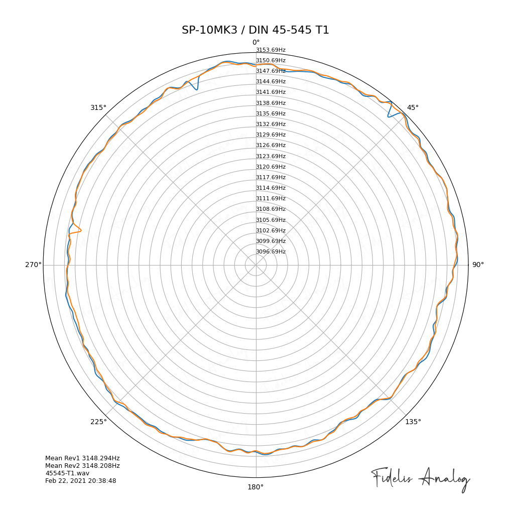

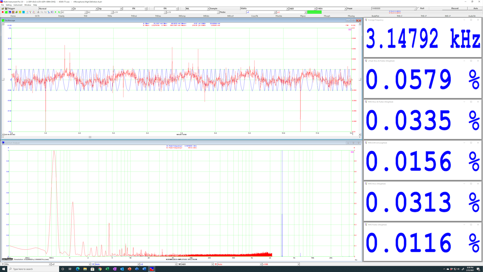

I don't see any mention of conditions or rigor. The only detail shared was the test record. No mention of the equipment, calibration, number of measurements, if taken at the same place on the test record, the method used to center the record, the tolerance thereof, etc.
There's simply not enough evidence or data provided in either case to draw a conclusion.
Case in point: DIN 45 545 test record tracks B1, B3, and B5. All I did was move the needle.

A major component of the Scientific Method that has served western society so well for the last 500 years, is replicability or reproducibility.
Reproducibility - Wikipedia
Any experiment or test procedure that that has outcomes sensitive to small change in the input parameters, is poorly designed or flawed in its execution.

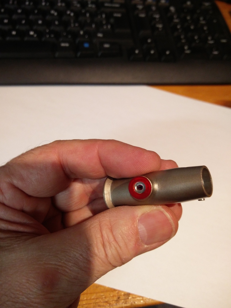

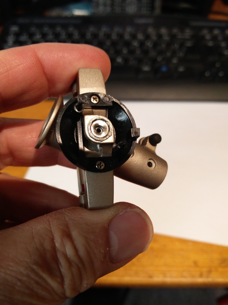

A while ago I saw the video JP posted on Youtube about his repaired EPA-100 tonearm. JP replaced the broken rubis bearing with ceramic balls, and got this excellent result.
For years I had this damaged EPA-100, got rob by some seller in Japan, a long story... Just to say that the arm was useless. I tried to find a place to have it repair, but no success, or at least some place that were not recommended to me. Except for the bearings the rest of the tonearm was perfect (VTA, antiskating, counterweight, etc...)
I decided to ask JP is he would be interested, and he agreed. I sent him the tonearm, and after his inspection, the horizontal axis (L/R) bearing was all destroyed, damaged retaining hats, even some marks on the adjustments pins plating, and needed complete rebuilt. The vertical axis (Up/Down) still had rubis bearing ball, but the top bearing plate was damaged by incorrect pin adjustment... It was bad.
JP completly rebuilt both axis, installed new ceramic balls, repaired the plate and polished the adjustments pins plating. While working on the tonearm, also rewired the arm with new Litz wires. He did extenive tests on the repaired tonearm, and sent me detailled tests results, including tests results showing no parasit resonnance. The arm was tracking perfectly, and sounds great.
Received the tonearm 2 weeks later in perfect condition, listening to it right now, and everything is perfect, I got my EPA-100 back!
Thanks again JP for your help, couldn't have done myself...
If you need to have your EPA-100 repair, JP is your guy!

"5 modulated bands per side to measure wow and flutter at different positions."
IF I have the correct record, this is for measuring wow and flutter on five different places on the record. He measured the inside groove, middle groove and outside groove. A experienced tester like JP (his measurements are all over the web) would be able to learn a lot by comparing them.
BUT he did not give us enough information to tell us what he was up to ! Which is the lesson I think.( And I too might have missed his point entirely)
