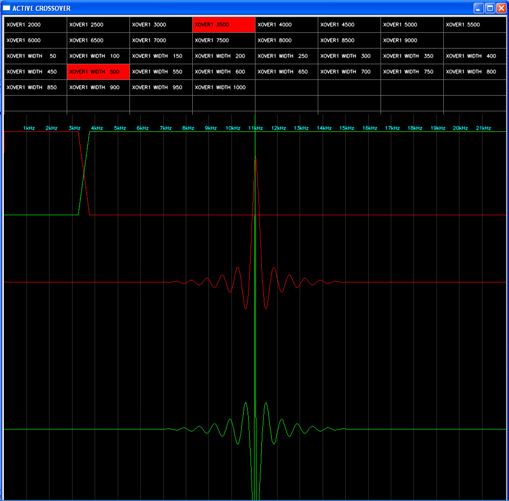

Just a question about the ideas behind active crossovers.
From what I understand, a steep crossover is desirable for reasons of relieving the drivers from being driven by 'unsuitable' frequencies, and also to eliminate multipath phase cancellation/addition from two drivers being driven simultaneously and the listener being off-axis.
In my setup I am driving a pair of sacrificial Mission 702e two way speakers with a home-brew PC-based crossover configured as follows:
FFT-based linear phase filtering
FFT size: 32768
Crossover frequency: 2-9kHz selectable.
Crossover width: 50-1000 Hz selectable.
Crossover filter characteristic: linear attenuation from unity to zero over the selected crossover width
I haven't done any 'voicing' of the setup as such, merely setting the amps to give equal levels from woofer and tweeter at 3kHz, and noting that for these particular drive units they seem more-or-less in phase over the crossover region at sensible frequencies. It sounds strikingly good 'out of the box' - in some ways the best hi fi I've ever heard. I have a calibration mic ready (no anechoic chamber unfortunately!), but I am not expecting to be able to make any great improvements, and probably it'll make it worse...
I can change the crossover frequency and width in real time (rough and ready GUI screenshot enclosed).
What I find is that I can hear the effect of the cutoff frequency fairly readily, certainly at the extremes, but I have to say that I cannot hear any effect whatsoever from the crossover width. Zero. I know that, in theory, the steep crossover gives more pre- (and post-) ringing but I have yet to hear it at all. Similarly, I know that the shallower crossover should cause multi-path effects if I move up and down in relation to the speakers while listening, but again I can hear no difference whatsoever!

"Crossover filter characteristic: linear attenuation from unity to zero over the selected crossover width"
I have no idea what that means, unity to zero over any bandwidth implies
infinite order crossover slopes and that is simply not the way it works.

Ah, so a linear transition over 1000Hz would still be considered a steep crossover? Is that a problem, or a good thing?
I guess this is your own application. Congrats, nice job!
My understanding of what you're doing is that you're performing a convolution of the input with successively one low-pass and one high pass. You obtained the impulse response of these filters (the 2 syncs) by computing the inverse Fourier transform of a brick-wall filter.
There's nothing wrong with this approach.
What's not clear is your concept of crossover width. Let me try to develop this.
When you compute the filters, you find out that you must truncate (or window) the theoretic impulse response otherwise you're getting an infinite number of coefficients.
From that point on, what's going to determine the steepness of the implemented filter is the number of coefficients you're effectively using. Basically the more coefficients you use, the steeper your filter.
Now when you associate a low-pass and a high-pass in a system, you have probably defined a dependency between these filters. One typical dependency is to require constant (or flat) output of the summed response Low-pass + High-pass.
From this point on, if you set the number of coefficients and the 'cut-off' frequency for one filter, the above dependency is going to determine the 'cut-off' frequency of the second filter.
So would you explain how you're configuring a transition width (or crossover width) independently of the number of coefficients?

Hi chaparK
Not quite. The idea is to fade out the bass and fade in the treble over a specified band. The nearest I get to a brick wall is opting to do this over a narrow 50Hz width, but I can choose a width of up to 1000 Hz. In the image attached to the first post, below the 'buttons' there is a graph showing the two filters' frequency responses and the way they linearly fade in and out with frequency. In that particular example, the crossover width is 500 Hz.
Yes, for these my first forays into active crossovers (well, any crossovers at all!), I am simply aiming for a constant sum from the two filters. However, I would like to have the option of performing separate corrections on each driver.
By steering clear of very steep crossovers, I am assuming that a large FFT (I can live with the latency) will give me 'sufficient' coefficients to allow me to produce a pretty accurate crossover with any desired width. In the image attached to the first post, the frequency responses shown are plotted from the forward FFTs of the impulse responses after windowing, showing that the shape of the linear transition is virtually unchanged. I'll admit a linear transition is pretty ugly, and intuitively a smoother shape would seem nicer (and I did implement a sinusoidal-shaped roll-off at first) but is there any innate reason why a linear transition cannot be used?

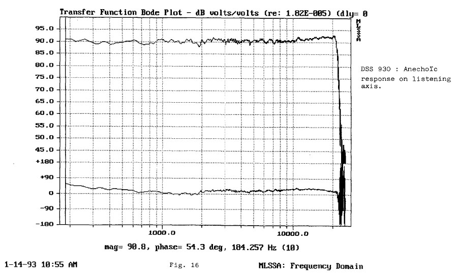

If you are basing on Linux with ALSA, with a CM6206-based multichannel audio USB attachement, you should attract many audio enthusiasts. If, on the other hand, you are running Windows XP and possibly some VST+ASIO clone like Synthmaker, that's a different story.I am driving a pair of sacrificial Mission 702e two way speakers with a home-brew PC-based crossover configured as FFT-based linear phase filtering with a 32768 FFT size.
I suggest that you read Philips DSS-930 technical publication first, for assessing what FIRs can bring to the audio discipline. The Philips DSS-930 User Manual is freely available here http://www.mfbfreaks.nl/pdf/dss/930/dss930.pdf and the corresponding AES technical description is available here AES E-Library Philips DSS 930: A New Concept in Active Loudspeaker
FIRs bring a massive advantage to crossovers. FIRs allow you to synthesize the crossover function and the speaker driver equalization in a single straightforward structure, guaranteed to be stable, with fulll control over the resulting phase. With FIRs, you can cure pathological phase behaviors like we observe above the natural speaker driver membrane cutoff frequency. With FIRs, you can transform a tweeter Bode Plot needing a corridor of +/-3 dB into a Bode Plot only needing a +/-1 dB corridor.
FIRs need to be quite long for providing a decent frequency resolution. If you are running at 48 kHz, a 128-tap FIR only provides a frequency resolution of 375 Hz. This is excellent for shaping a Tweeter Bode Plot, however this is unadequate for shaping a Woofer Bode Plot, especially below 375 Hz where you will rely on a single frequency chunk.
For finely shaping the Woofer Bode Plot in the deep bass range, you need a ten times finer frequency resolution. Meaning a 1024-tap FIR or a 2048-tap FIR.
And still, you may want a 2nd order IIR for implementing a genuine Linkwitz Transform (kind of precisely shaped bass boost). See point 9 in the webpage here Active Filters
The Philips DSS-930 DSP was powered by a DSP56001 clocked at 27 MHz.
The Philips DSS-930 filter structure is a hybrid one.
Woofer channel : 2 IIR sections (one tunable IIR 2nd order section, one 1st order IIR and one FIR filter featuring 79 taps.
Tweeter channel : 3 IIR sections and a 30 tap FIR.

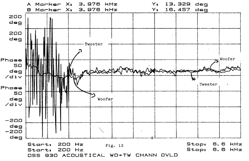

Results seem all excellent. See the attached .jpg.
So, why using a 32768-tap FIR ?

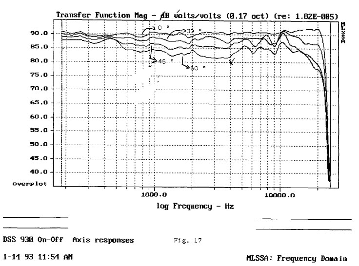

DSS-930 Resulting Bode Plot 0 30 45 60 degree off-axis.jpg118.7 KB · Views: 183

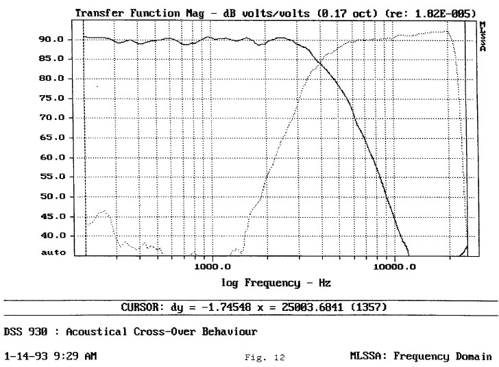

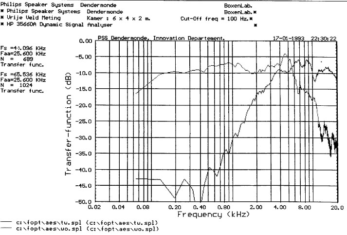

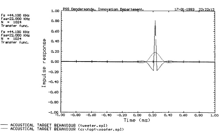

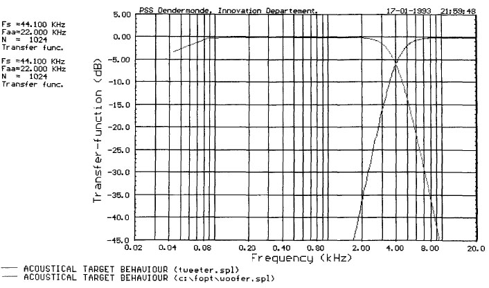

The DSS-930 falls in the third categoty. Looking at the time-domain Acoustical Target curves, you can see the woofer exhibiting some preshoot as it starts with negative (say 10% amplitude), then goes positive. Clearly, the DSS-930 implementation is thus not a delay-compensated Lipsitch-Vanderkooy using a Bessel Lowpass as kernel.5. Decide what kind of phase linear crossover you want : a 1st order, a delay-compensated Lipsitch-Vanderkooy possiby emulating a 16th-order Bessel Lowpass which is delivering no preshoot and no overshoot, or a myriad of other implementations delivering preshoot and overshoot
The next step is to determine the benefits of allowing a tiny 10% preshoot in the woofer.
By reading the frequency-domain Acoustical Target curves, we see that the 4 kHz crossover frequency is at -6dB for the woofer and the tweeter.
This is an indication that there is no relative phase shift between the woofer and the tweeter at the crossover frequency.
We also see that the 8 kHz frequency is at -36 dB. We will thus say that the DSS-930 woofer crossover emulates a 5th-order lowpass.
Now look the tweeter frequency-domain Acoustical Target curve. It is symmetric. It emulates a 5th-order highpass.
This is a highpass slope a delay-compensated Lipshitz-Vanderkooy can't deliver. The greatest highpass slope you can obtain from a delay-compensated Lipshitz-Vanderkooy, is when you use a Butterworth transfer function as lowpass, high order, and in such case, the resulting highpass is a kind of 3rd-order highpass. In a delay-compensated Lipshitz-Vanderkooy, the resulting highpass can't mathematically go above a 3rd-order, and in most cases (like using a Bessel lowpass as kernel), you end up with a 2nd-order highpass slope.
This is the kind of benefit you get when relying on FIRs instead of IIRs, instead of emulating analog transfer functions, when you accept some preshoot in the woofer. Hope this answers your question.
Having identified this, we may ask ourselves what are the degrees of freedom on the DSS-930 design.
By only allowing a 5% preshoot on the woofer, is it still possible to generate a 5th-order lowpass and a 5th-order highpass, or is it only possible to generate a 3rd-order lowpass and 3rd-order highpass ?
By allowing a 20% preshoot on the woofer, is it possible to generate a 10th-order lowpass and 10th-order highpass ?
What about the FIR lenght ? Are more elaborate compromises possible when using longer FIRs ?
Because of using the Philips/Matsushita ribbon tweeter, the DSS-930 is using a 4 KHz crossover frequency. This is a quite high crossover frequency, especially in a 2-way context. The Philips RH541 (MFB) relying on conventional Philips AD0140 tweeters featured a 1.4 kHz crossover frequency.
The DSS-930 4 KHz crossover frequency forces you to use high quality well damped membranes for the woofers, of moderate size. They were 5 inch in the DSS-930. Being so tiny, there were two 5 inch drivers acting in parallel in the deep bass range. In the medium range, the bottom 5 inch driver was delivering no output. We may thus say that the DSS-930 was a 2.5-way design.

A few more DSS-930 diagrams:
- Resulting Bode Plot (in-axis)
- Resulting Phase Plot

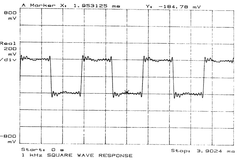

- Resulting 1kHz square wave response
The time-domain ripple in the 1 kHz square wave response is caused by the 44.1 kHz antialias filtering process.
Such ripple can be significantly reduced using a 96 kHz or 192 kHz sampling frequency from recording to playback, using non-aggressive antialias filters. There are a few vinyle rips nowadays, recorded this way. I don't know if we have studio material recorded this way yet. They may be 96 kHz or 192 kHz, but they may not feature the required non-agressive antialias filters.

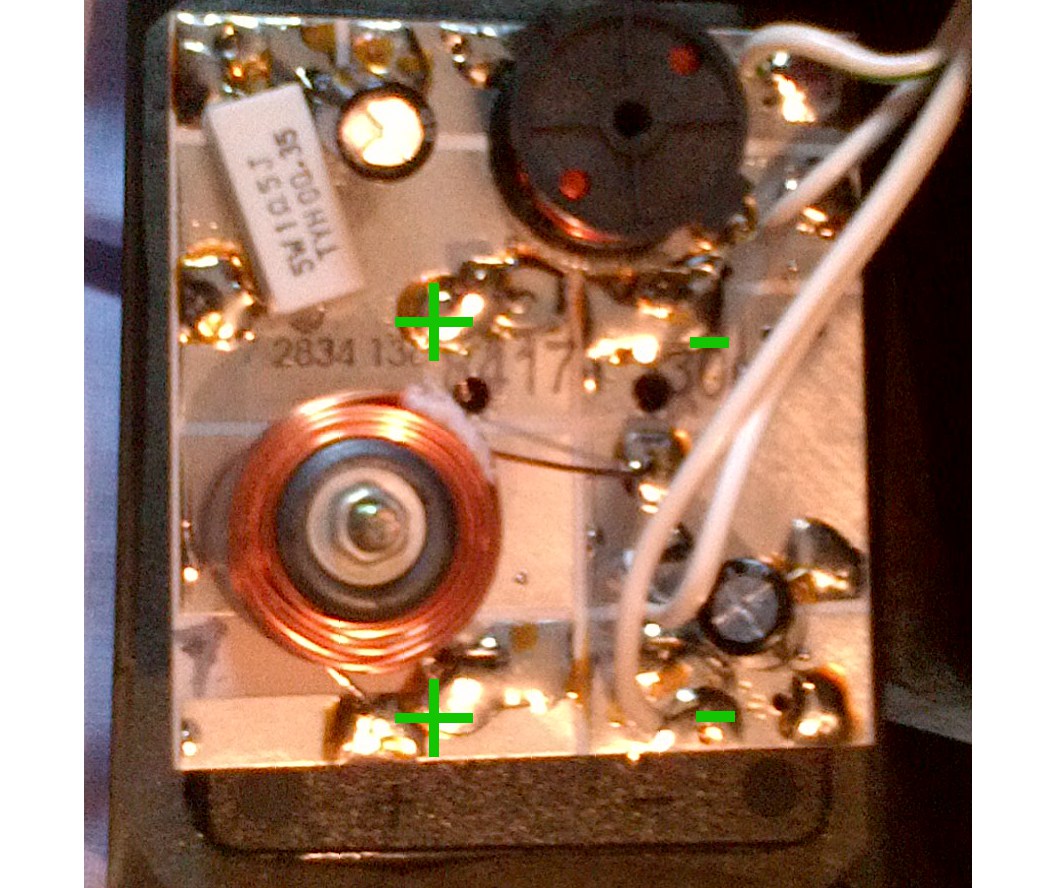

Here's a poor quality photo of the unmodified 702e crossover. The 4mm terminals are marked '+' and '-' : woofer at the bottom tweeter at the top. So the woofer signal is fed via a series inductor then capacitor to ground in parallel with the woofer. The tweeter is fed via a series resistor and capacitor, then an inductor to ground in parallel with the tweeter.
