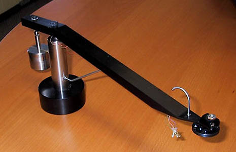

More example of a "folding" tangential tonearm. The Bajulaz tonearm. I really doubt it would work well but I like the fun factor. Here's the description:
"Prototype of the 'Bajulaz' tonearm on a TD-124. It was designed by Ing. Bajulaz to overcome the geometry problems of the conventional tonearms, but allegedly it wasn't so good for the new stereo cartridges and therefore never went in production."

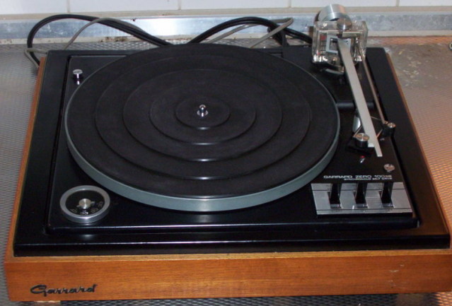

actually all of this stuff pulls me back to the Sakura Sytems (RS Labs) RS-A1 tonearm...
and of course my beloved Garrard Zero 100 SB
bamboo plinth/Sugden added as well

actually all of this stuff pulls me back to the Sakura Sytems (RS Labs) RS-A1 tonearm and of course my beloved Garrard Zero 100 SB
The Zero 100 has a modern successor in the Thales tonearm and the upcoming new model called "Simplicity". The Simplicity is not 100% tangent but close enough and the Thales Original model is the only pivot arm that's 100% tangent in a pivot design.
Since the needle talk" or rid of antiskating by not having overhang of the stylus. I wish more manufacturers can put more research into developing better pivot-linear arms but I guess it's too complicated and expensive to produce. And yet, they rather live with an air pump...."]RS Labs RS-A1[/URL] does not have anything to guide the headshell I wouldn't call it a tangent arm, its purpose is really trying to minimize "needle talk" or rid of antiskating by not having overhang of the stylus.
directdriver...Thales arms...
certainly look to be spiritual successors to the Garrard Zero arms...
The issue I have had with the Garrard arms is their poor pivot bearings, but a single magnet could suffice to keep the "adjusting bearing" ( the one attached to the linkage) from being to sloppy.
AFAIK, the RS Labs headshell has a fair amount of rotation available to it (approx 20°in both directions), and would effectively behave as a tangential tracking arm.

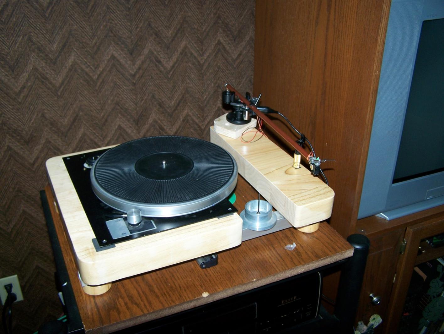

Magnetically Levitated Linear Tonearm
Did you ever get to finish this mag-lev linear tonearm project? Please share!

I think the vertical movement intended to have TWO needle points but the side view made it look like a single one.
As far as stability is concerned the attracting magnets at the bottom helps to tightened the gap to add stability. It's possible but the enormous magnetic field will be hard to shield even with U-metal. Maybe the armwand is long enough for the cartridge to be far away enough from the magnets. Short armwand like the Trans-Fi approach will not work in this design.
