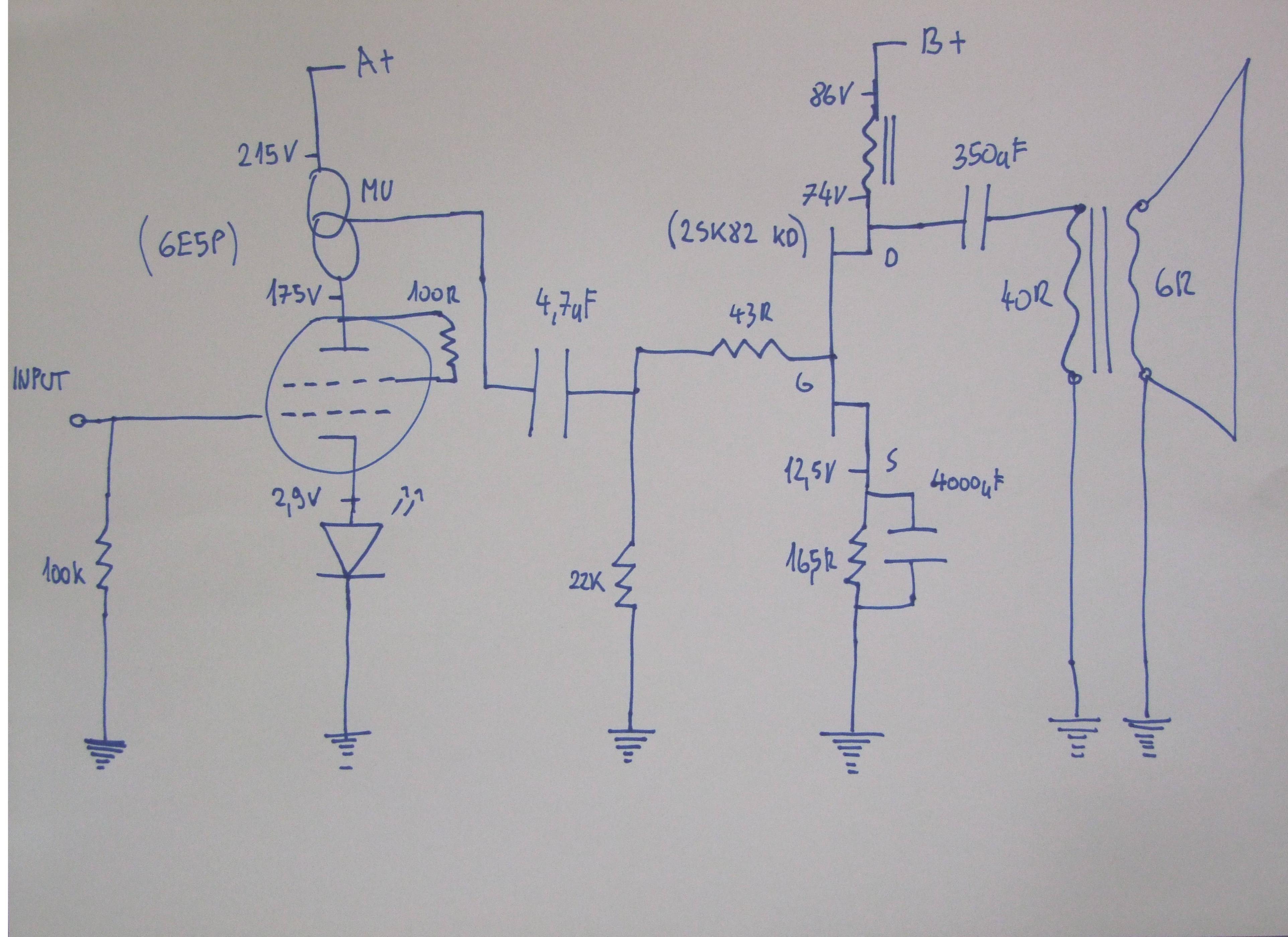

Please post your schematic. The SIT has a 1-2ohm D-S resistance.
Why dont you try 2SK82?

Take a look at schematic...)
Ofcourse its in triode mode...)

I never tried tetrode connected.
I assume whit CCS mu output its possible. You can get low output
impedance below 600R. DHT 26 is a very smooth sounding tube,
this would make a very nice combination. Try it out...) But you will have way higher input sensitivity.
I had the 26 pre amp but sold it, cos I dont need it anymore.
Whit 6e5p or 6e6p I have a very high sensitive input and a lots of gain.
I am driving my DAC directly whit hybrid SIT, I mean direct after I/V resistor conversion take place...Its absolutly amazing, clean, colorfull, natural...STOP...I know,,,)😀
Mu follower opens up a lot of driver choices...But only whit Pimms battery CCS. Others I tested sounded harsh, not so natural at all...

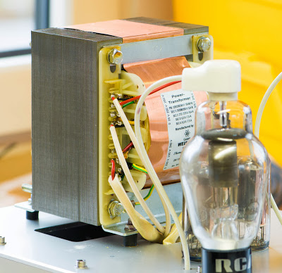

My intention be find possibility to modifying without big extra cost and easy to come back if not better sounding.Some diyers take care about mechanical microvibration of transformers like on photo from blog VynilSavor this black rubber fits be cheap and make less vibrate box mechanical distortions factor.

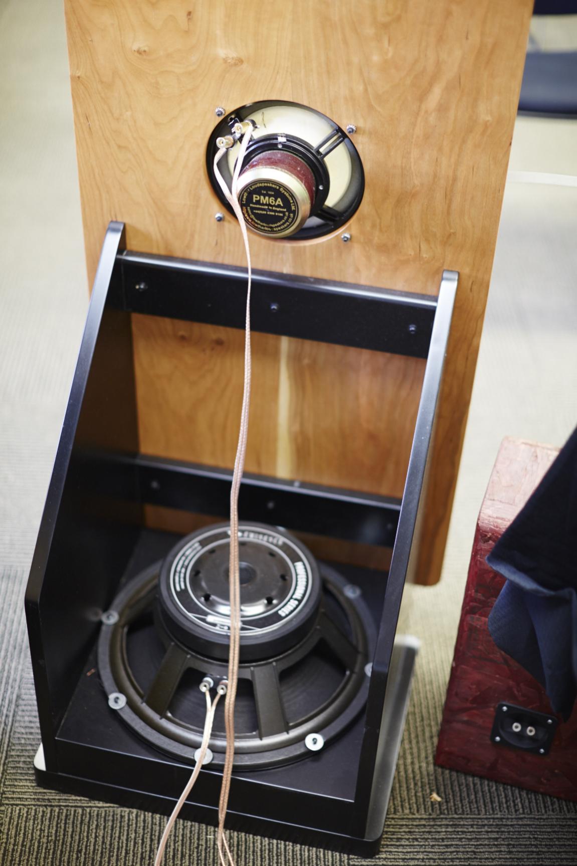

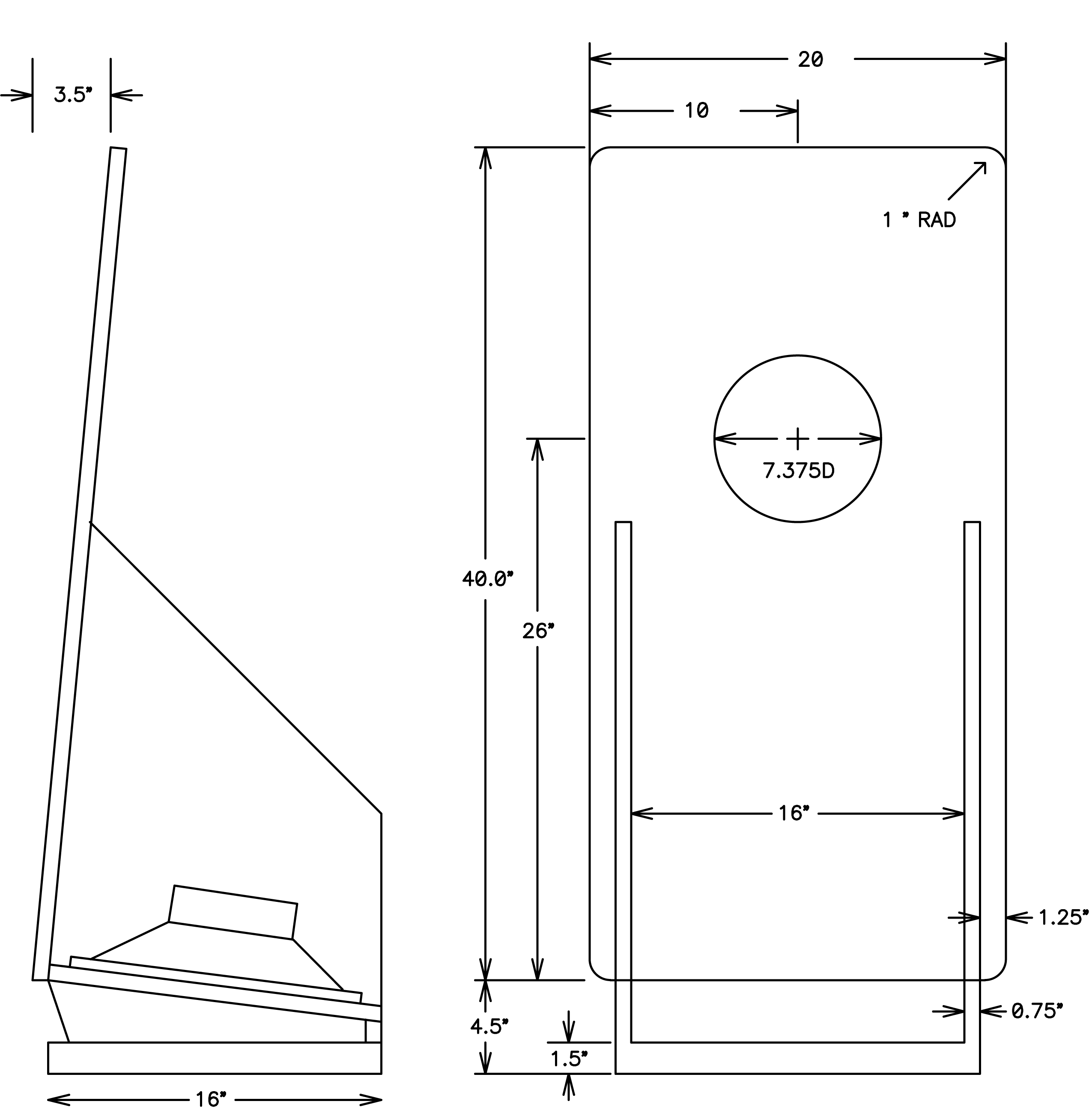

DIY high efficiency open baffles look promising like Mr Pass from BAFFirst time I realise how much a very good speaker means in a good sound system. I recommend SITs only whit absolutely best speakers to play whit...
Lowther PM6A is vintage and pricey but we can find more accessible equivalent and Wrenchone have opened thread on this theme
