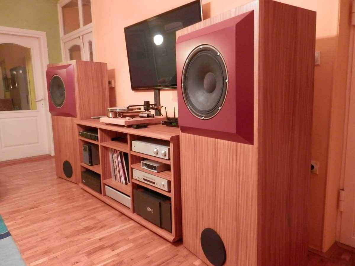

Today I hosted some people who are professional music players.
They really where blown away whit the sound reproduction...
All of them agreed that my audio nirvana full range speakers whrere no match
for this amp. This is the third time I heard something like that.
I know....I need some decent speakers to match the amp...
This will be a nice project for next year...If someone has a nice idea,
let me know...But I dont like lowthers...!

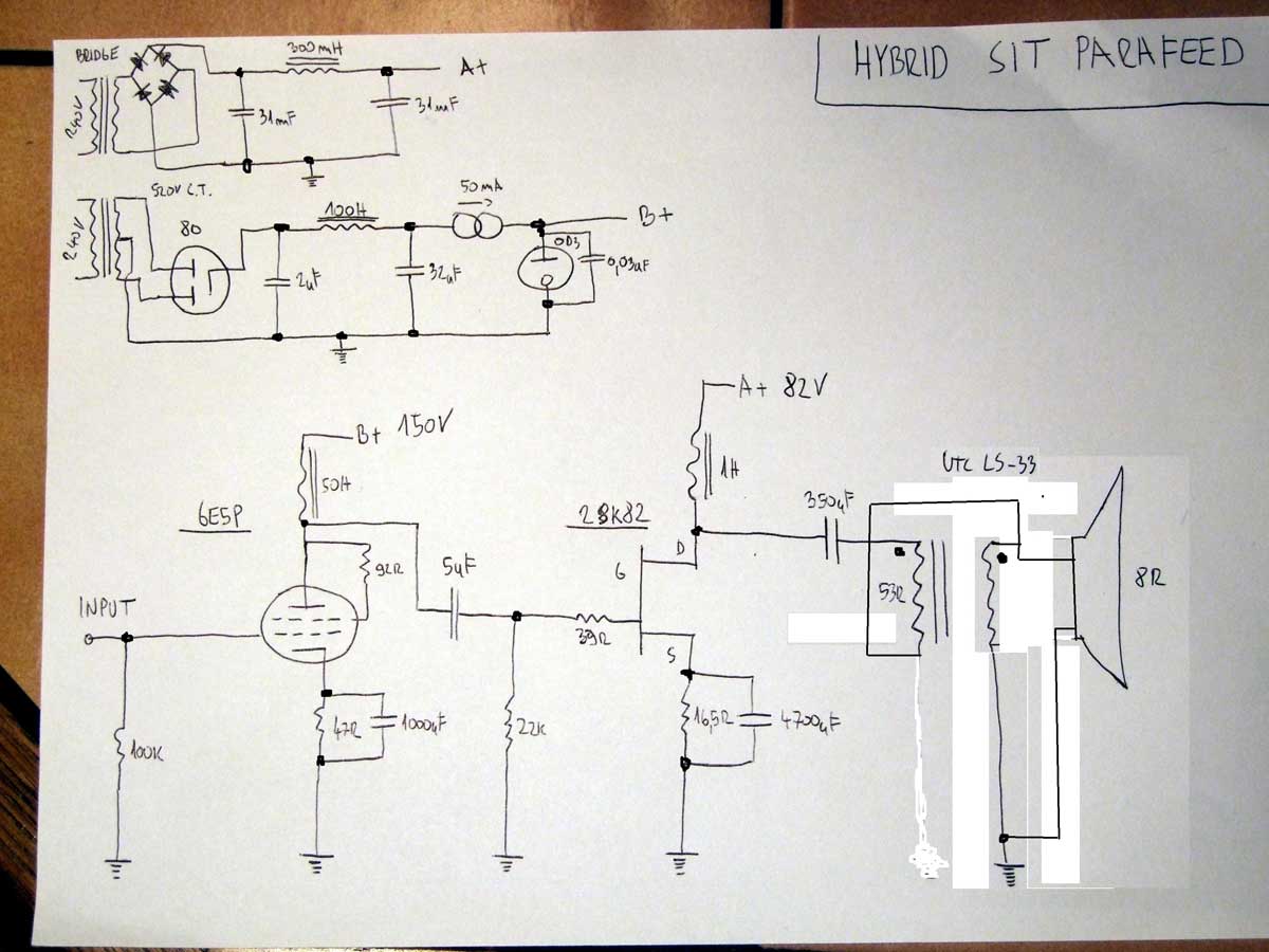

First of all I lowered the driver stage output impedance whit
CCS Mu follower output. Then I changed the cathode resistor and cap whit a
white diode (its a package in SMD whit two dioded in parallel). Forward voltage is
2.9V, so perfect. I get 180V at plate and 36mA current........
To me be clear. With 1Vrms from source, you're pushing around 50Vrms (140Vpp) to Gate of 2SK82. True ???
No. Whit 1V input you get 30-32V from first stage.
So I need only 0.2-0.5V source.
This hybrid SIT amp doesnt need any pre amp!
I am driving my DAC directly whit SIT, so only two I/V resistors
and thats all...
The sound is really really good.

Would it be possible for you to measure your output voltage from 20hz up to a few hundred? I've made several attempts to use choke loading with MOSFETs and SemiSouth power FET with the largest choke being 10H at 500MA but can never get much output below a few hundred hz. Would make a good tweeter amp but not full range. I would think 10H would be enough.

Maybe you did something wrong...You should post your schematic in some
other thread, so we all can analyse it...
The Hybrid SIT works extremely well.
I wish I could measure distorsion but from sound I assume its very low.
I will post a new version of the design whit some changes in the first stage.

The main problem for building this amp is to find the UTC-LS33,34 output transformers.
But I think Jack from electra print can make decent 40-60R primary 15-20W parafeed transformer......So...enjoy!

Interesting idea...But how to do it, I never done something like that...
Any thoughts to start whit...)
I see...So I connect the primary - to the + of 7.5R winding.
I should get more inductance and thighter coupling lower capacitance...
I let you know...
