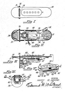

Leo Fender's 1950s single-coil pickups were pretty blatant copies of an even older guitar pickup design by De Armond, which he began selling in 1939. I'm attaching an image of the patent application, taken from a Premier Guitar article on the subject. As you can see, the De Armond pickup uses six Alnico pole pieces, a slim elliptical coil, a single-coil winding with 42 gauge wire, virtually every feature of the later Fender pickups. However the De Armond could also be mounted in the soundhole of an acoustic guitar.
Unfortunately for us, every year there is still more electrical and RF interference (for example, WiFi is everywhere now, along with Bluetooth, cellphones, wireless keyboards and mice, etc). A lot of this is relatively recent, but I'm sure new sources of electrical noise and interference have been showing up for many decades now (AM radio, FM radio, police radio, CB radio, etc, etc).
I think that wonderful old 1930s De Armond pickup design is not coping very well with 2016 levels of noise and interference.

On the Aussie Guitar Gearheads forum, a brilliant fellow named Roly Roper posted some schematics for a similar idea. He used variable bootstrapping to change the effective input capacitance of his JFET preamp.
Roly passed away from cancer a few months ago. I've never met the man or even spoken with him, only seen his posts on the AGGH forum. But I felt his passing deeply. It's rare to encounter someone with so much knowledge, so much intelligence, and the desire to use all of it to help other people.

thank you for the kind reply. Yes, it is very interesting to see how old some knowledge is sometimes.
Just to mention the artificial rotary capacitor: This is by far not my idea. I was inspired by reverse engineering a VOX Wah-Pedal about 1970. At that time I found a fixed choke and a pot controlling the parallel capacitance - all together formed the well known tunable resonance filter. Very simple, very effective (but very noisy😱). Anyway the basics of the circuit I use today.😉

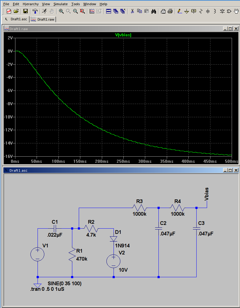

I had a little time on my hands while I was cooking dinner (waiting for things to cook), so here are a couple of LTSpice screenshots to show what we're talking about.
Let's start with the first image. V1 is the signal from the driver/phase splitter stage; it maxes out at 70 volts peak-to-peak in my amp. C1 is the coupling capacitor feeding this signal to the grid of the output valve. R1 is the grid bias resistor for that output valve, and R2 is it's grid stopper.
D1 and the 10V DC source are there to model grid current flow. In my (cathode biased) amp, the cathodes sit at +10 volts quiescent, and the control grid therefore will begin to conduct current if it goes any more positive than +10 volts.
Fairly conventional values have been used for the components, including C1, R1, and R2.
These are all the components you need to re-create the problem (bias shift due to grid current flow through C1). However, it is very hard to see the extent of the problem in LTSpice, because the huge 70 Vpp AC signal covers up the smaller DC shift we're interested in.
So I added R3/C2, and R4/C3, a two-stage low pass filter that removes most of the 100 Hz audio signal, while letting the DC bias voltage at the grid of the output valve come through.
In a perfect world, this output signal (Vbias) would be zero volts initially, and would stay there when V1 begins to drive AC into the circuit.
What happens in actuality is shockingly different. Vbias plunges to (-16 volts) if the input signal remains present for half a second! (A half-second long guitar note is not typical, but not absurdly long, either.)
Remember, this additional (-16V) is on top of the existing (-10V) of bias. So the output valves, which were idling in class AB at -10V bias, are pushed deep into cutoff, with -26V of grid bias, when a long, loud, guitar note comes along. 😱
