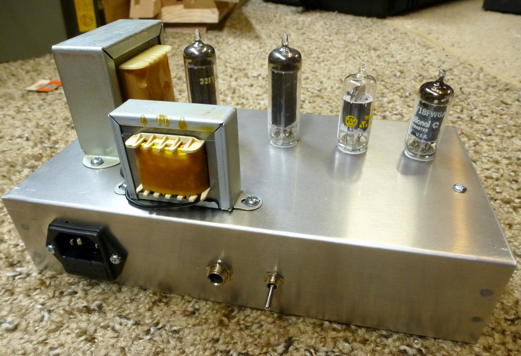

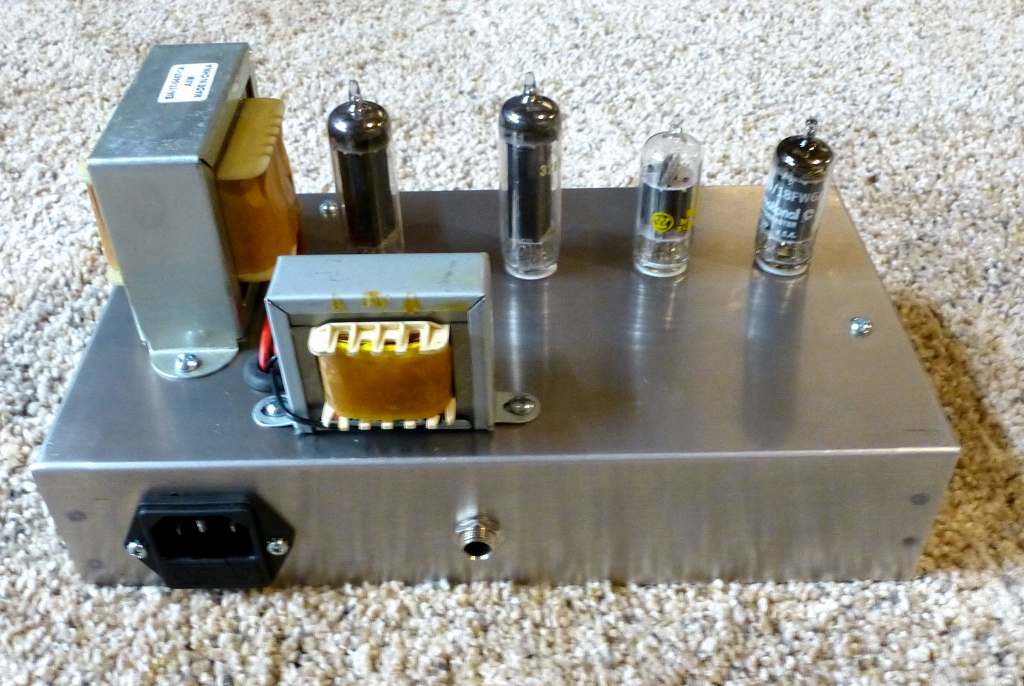

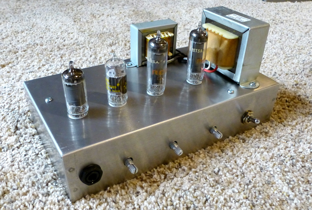

I had to work on a project for a friend in Florida today. I will be going there for a vacation in a couple of weeks. Since I dragged my drill press out of its hiding place, I started working on a chassis for Amp 1.5. Maybe I will finally make a box for it, but it needs a chassis first.
I bought a chassis for it from Mouser back in January. I got it out of its box today. Apparently Hammond finds it perfectly acceptable to put a deep scratch through the white protective plastic into the aluminum, then put the sticker and shrink wrap over it and sell it anyway. The shrink wrap was not damaged, so the scratch was there first.
The only one I really miss was a commercial product from the 1960's, an "Ultraflex" made by the "Audio Crafters Guild." The same amp was sold as "Panaramic" and "Magnatone." It had one preamp split to two different power amps. The "balance" was set by the Ultraflex knob. The two power amps had similar schematics, each with a pair of 7591's, but different component values, different OPT's, and each powered its own speaker. The amp with the bigger OPT fed a 12 or 15 inch speaker, and the amp with the smaller OPT fed a 6 or 8 inch speaker. It had a unique bluesy tone that I have never heard from any other amp. It was totally original, even the tubes, and worked perfectly.
I gave it to another forum member who had a dead version of the same amp. He didn't know that I had one until he came to my house to pick up some tubes and transformers that I was giving away. He saw it and told me about his, and asked if it was for sale.....maybe he could make one good one from the two. He was freaked when I turned it on and started playing it. I gave it and a Crown CE2000 (one dead channel) to him. The live channel in the Crown was strong enough to scatter the cone in one of those 80's vintage BSR coffee table downfiring subwoofers when I plugged my bass guitar into it!

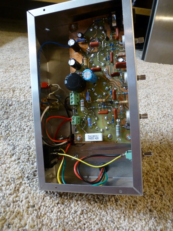

I spent much of the afternoon drilling, cutting, and filing a couple of pieces of metal. One was for a project I have to take to Florida in a couple of weeks, the other was for a once abandoned project. Guess which one I finished.
All the parts are mounted, maybe tomorrow I'll wire it up and plug it in.
The one that goes to Florida has no tubes.
Amp 1.5 now has a chassis. Next I will make a box for it. Don't know when yet. That depends on how well my other project works out. It involves me building an Arduino based system and then writing the code for it.

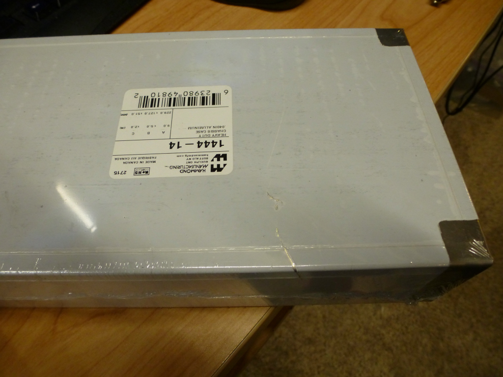

That's really unacceptable. 😡 Hammond stuff isn't exactly inexpensive, either. Paying through the nose for pre-damaged hardware is a bit much!Apparently Hammond finds it perfectly acceptable to put a deep scratch through the white protective plastic into the aluminum, then put the sticker and shrink wrap over it and sell it anyway. The shrink wrap was not damaged, so the scratch was there first.
I hope either Hammond or Mouser makes it right for you.

Been a bit absent from this for a while now, but still been tinkering.
Actually have mine all completed! (ish) 🙄 I ended up sticking with the 12W6 in the output and ran the B+ rail up around the 250 mark for the 6SL7 on the input stage. I'm planning on turning it up to the 300 mark next time I get the thing open, just enjoying playing for now 😎
OPT and PT are both EDCOR units. Fantastic construction and if you can plan out the timing, the wait time isn't terribly bad. WGS was my go-to for the 10" 'Veteran 20' speaker that's sitting in the donation chassis. Holy cow when a guy cranks up the volume knob it gets nice and loud, especially for a "4W" output.
The power supply issues I was having were remedied by putting some real skookum capacitors in there, along with a 5H hammond inductor. What had been taking a while for me to resolve was how I wanted to feed the filaments. Being an oddball myself, I've got a 12V and 6V tube that drew different currents so there was no easy way to get the damn things wired up (so i thought...hint...foreshadowing). In the process I tried several variations of DC supply; rectified non-regulated, rectified regulated, rectified with drop resistors.......and every single one of them got noisier than an SOB when they were placed *in* the chassis, not just sitting on my bench. So what did I end up doing? Just so happened to find the right power resistor to drop out the voltage (still no clue why i had a 40Ohm power resistor floating around 😕) and yup.....the real simple AC with a dropping resistor ended up being the best option.
Still no tone circuit in it but I'm just wanting to enjoy playing it at the moment. Everything is in the cab and you can actually tote it around....not a mess of wires on the table (CRAZY!). It's got pretty good touch sensitivity, takes pedals really well and for being what it is, about 75-80% of what I could ever want. The "cleans" can get semi-loud before breakup and when it does start to breakup, its real nice and tubey with a little bit of bite on it. A light eq-booster type pedal on the front end helps drive the first stage into a little more distortion for some great bluesey sounds. I was thinking about lowing the gain on the first stage to try and use the full range of the volume pot but I'm going to wait as the tonestack's going to take some out for me.

Paying through the nose for pre-damaged hardware is a bit much! I hope either Hammond or Mouser makes it right for you.
I bought two of these boxes a while ago when I had to order about $200 worth of parts for several projects. They have been in the Mouser box since then. I was pretty angry when I first saw the gash three days ago, but after thinking about it for a while, I came to the realization that their scratch would probably just be one of several that would be present after I was done drilling, filing, and hacking at it with a Dremel tool (IEC socket). I was right.
After all the holes were made, and the white protective film peeled, there were a few scratches, including one ugly scratch I made when a drill bit danced a bit. Fortunately the ugly one is now mostly covered up by the power transformer, and the Hammond scratches are really not bad.
I put it aside and made the box for my other project, a "machine gun sound simulator" which is basically a specialized WAV file player using one of the Teensy boards I described earlier.
After that box was done, I started wiring up Amp 1.5, when I made Dumb Blonde Mistake #347. During the wire up, I realized that I wanted a speaker impedance switch, so I just grabbed the hand drill and drilled a 3/8 inch hole in the rear panel.....right into the power supply input cap. DOH!
Take board out, replace cap, but board back in, too late at night to finish it......Power up tonight.
