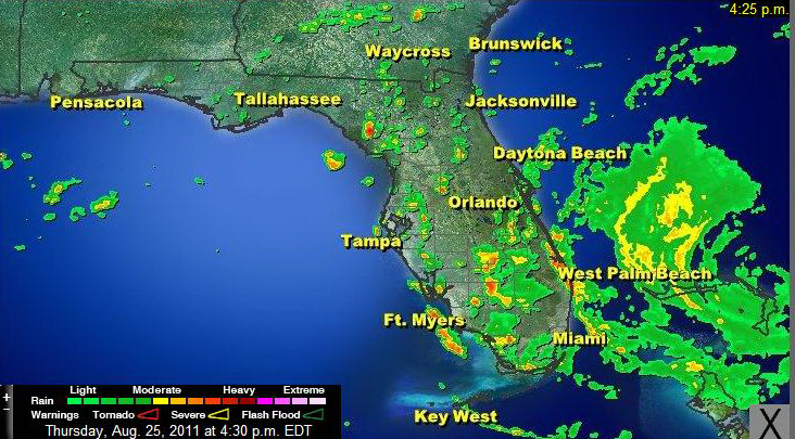

Irene chose NOT to move in today. The huricane slipped quietly past us today with less wind and rain than some summer storms.It doesn't look good for the Carolinas though. It might be clear enough this weekend to work on the speakers.
I grabbed a screen shot of the local TV weather radar about 1/2 hour ago. The radar only sees the western half of the storm. The eye is just to the east of the "h" in West Palm Beach. I am currently in that clear spot betewwn Miami and WPB so its time to go home (I am at work).
