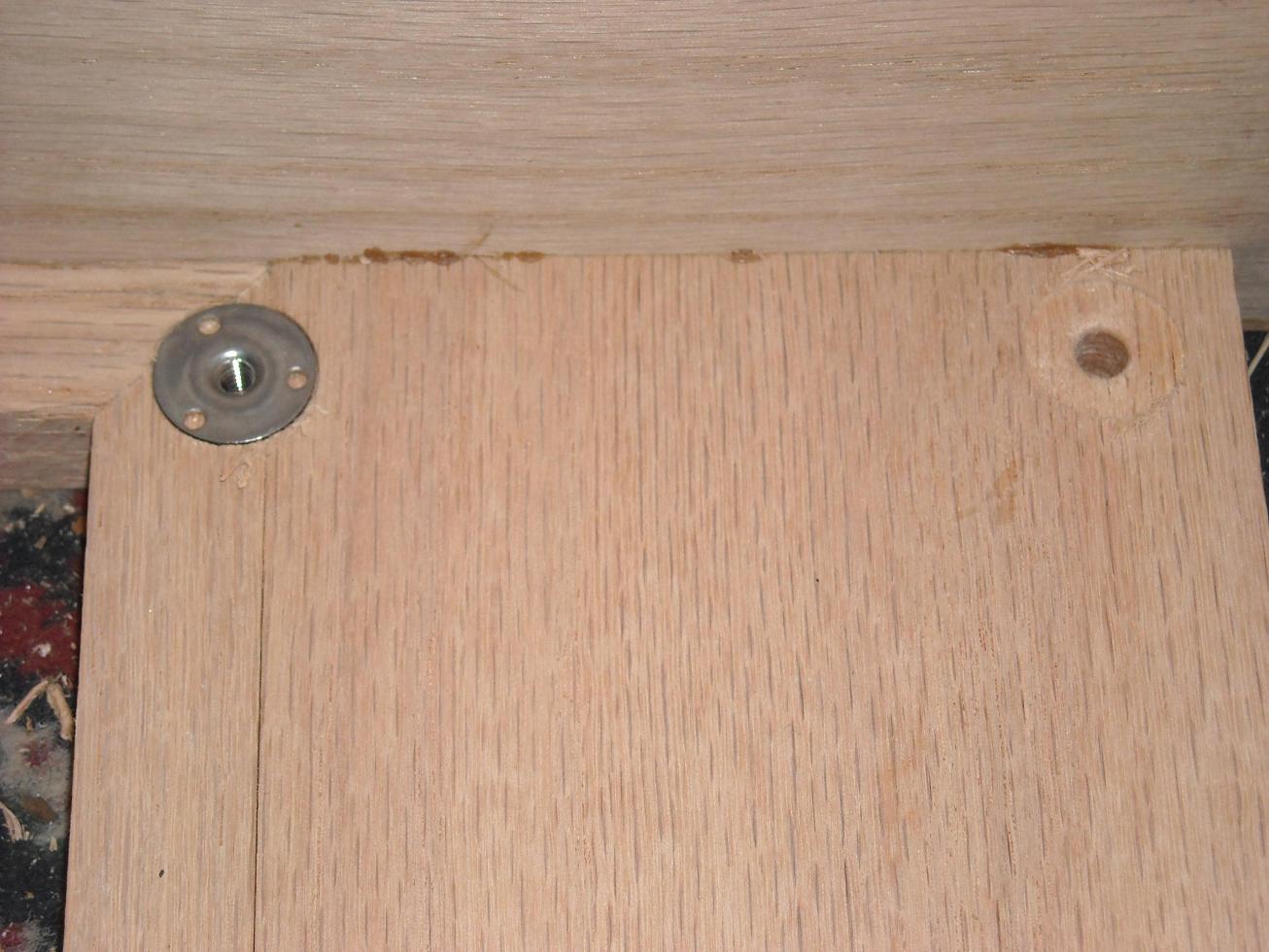

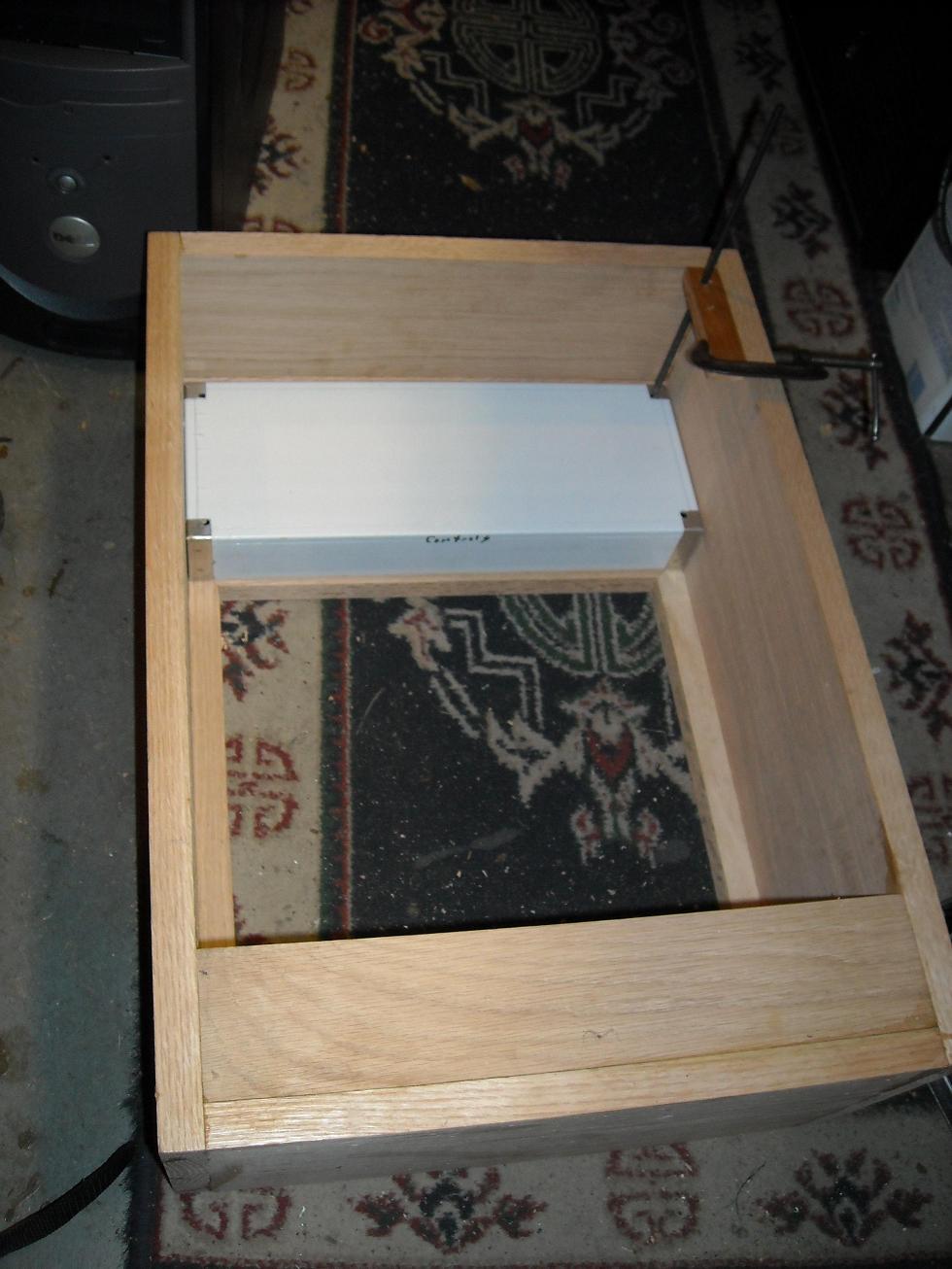

I finally figured a 12" long drill bit would be required. I drilled the four corner holes in the chassis, and a small wooden block that fit the corner. Clamp the wood guide in place, slide drill through it and the chassis to get a perpendicular hole. Four holes drilled.
Next I have to drill a 3/4" countersink and glue in "T" nuts. Now I can start thinking about the chassis layout.

Here is the counter-sink for the "T" nuts and the cab with the chassis positioned.

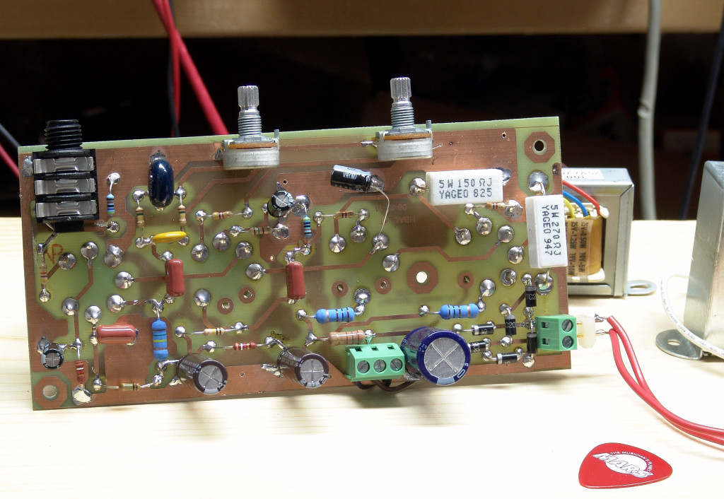

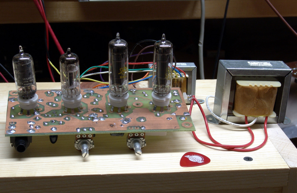

AMP 1.2 is alive and working. Power output is 2 watts when the controls are set for a clean undistorted output. Power output is just over 3 watts at full crank. There are two controls volume, and tone / distortion. The tone / distortion control can provide a wide wange of sounds from clean to cranked. No you aren't going to get a full metal racket from a 2 watt amp, but I did manage to get some acoustic feedback with the guitar about 6 inches in front of the speaker. Total parts cost is less than $50.

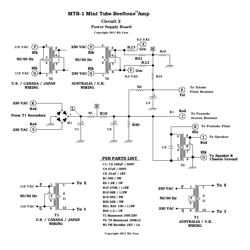

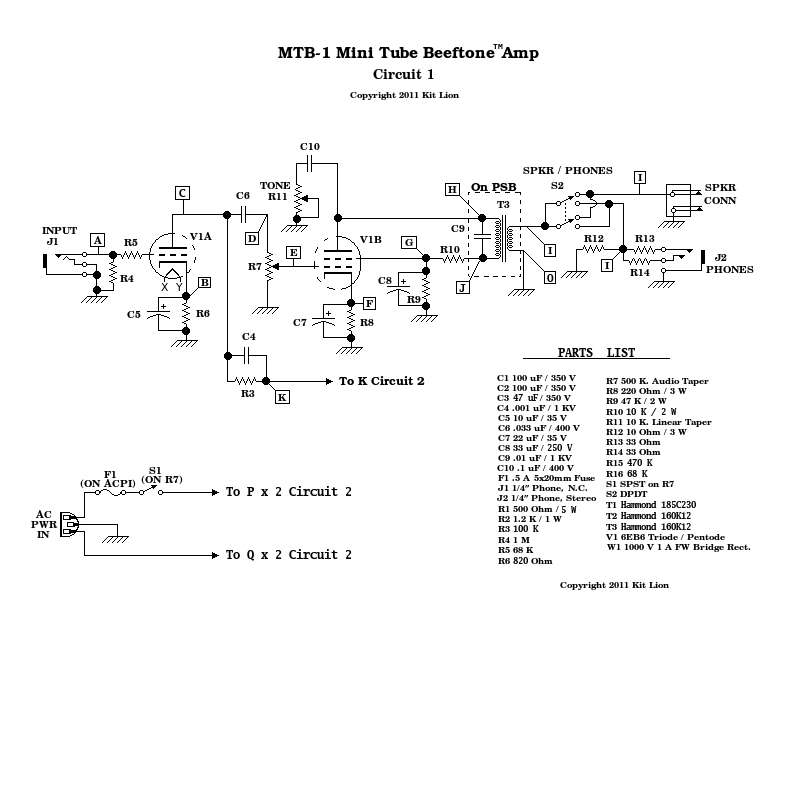

Tubekit's Amp Schematics
Don't know what happens to business after giving this away, since I don't make circuit boards, just create a margin by buying wholesale, but I once said I would submit this, and I keep my word.
This is the revised amp, for international use. It's "beefier" than the original because of higher plate voltages.
It works as claimed--here and elsewhere.
