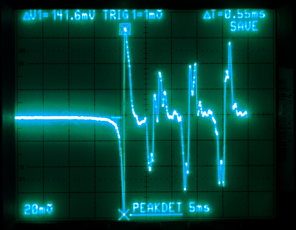

For those of you with guitars handy, do you know your nominal signal voltages? I saw earlier in the thread that estimates were between 0.1v and 6v. I'm assuming 2v p-p...........If I get home in time to play tonight I can connect the scope across the amp input and see what is there.
For tonights experiment I plugged the guitar into the two gain stage version of AMP2.0 and wired the scope right across the guitar. The amp has a 100K ohm resistor across the guitar input and a 47K grid stopper into the triode grid. I tried two guitars with very different personalities but got similar results.
I used an old Guild S300A-D which is a good guitar for loud rock and metal. The -D means that it came from the factory with two high output DiMarzio hum bucking pickups. It is known as a "hot" guitar.
With the volume and tone controls on the guitar set for max output and the neck pickup only (highest output). I tried several single notes with the scope set to trigger and store on the note attack. The largest signal I saw was 1.416 V p-p. It took a pretty hard whack on the string to get there. Picture enclosed.
I then set the scope on a slower sweep and just cut loose with notes, chords, random noise and a few screaming feedback induced long sustained notes. I saw a few excursions to 2 volts P-P but most often the output was in the 800 to 1500 mV range using the neck pickup, or both pickups regardless of the phasing switch. Using the bridge pickup only yields 500 to 1000 mV. Oddly the episodes of feedback which were by far the loudest only produced average to below average voltages, 600 to 1000 mV.

I switched guitars to an Epiphone Les Paul. Named for the inventor of the electric guitar it is used for rock, blues, but rarely metal. Think Carlos Santana. Mine has two "budget" single coil pickups. Epiphone is owned by Gibson. The good Les Pauls are Gibsons and you could spend $2000 on one. Mine is a mid level Epiphone. Sherri got it for me as a birthday present when I was jamming with my daughters friends about 13 years ago. It was $450 then.
Again single notes played hard or chords played at loudly but not too hard produced signals around 1.5 volts P-P with occasional excursions to 2 volts P-P. The bridge pickup could get to 1.2 volts with some rough playing. The Les Paul did not often exhibit the electrical squeal so I could get right next to the speaker and get some good feedback going. The voltage hit 616 mV max during a long multi note run without picking. I will do this again whenever I put the Strat back together or get my old Univox / Mosrite out of the closet and restring it.

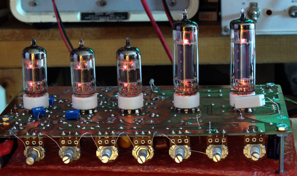

While turning the room lights off to photograph the scope, I saw it. A dim red glow in one of the output tubes. I realized that I hadn't checked the bias since I got a bigger power transformer. I changed the cathode resistor to "get the red out."
